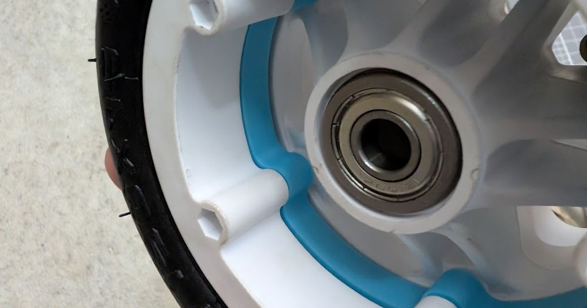

They’re lawn mower tires, so they’re available in multiple places, though I can tell you from experience that Cheng Shin C190 Smooth Yard - Lawn Tires | Free US Shipping are out of stock on the ones for 4-inch wheels indefinitely despite showing up on the site. Carlisle Smooth Yard - Lawn Tires | Free US Shipping and Kenda K404 Smooth Yard - Lawn Tires | Free US Shipping are pretty similar, but the Kendas are actually intended to be tubeless. I’m running some of the Kendas with tubes right now, but it was a pain to get them to mount on Rockstar Pro Xls. I ended up 3d printing a liner to make sure they went evenly up onto the larger part of the bead. I don’t have much tire experience at all, so I can’t really comment on how good they are with any meaningfulness.
