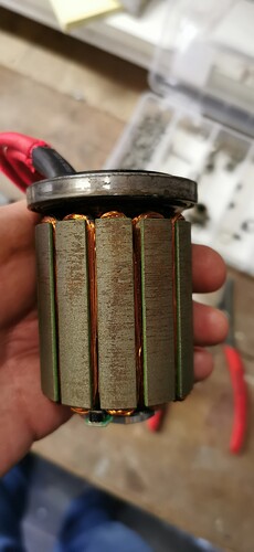

My big bearing has completely seized up after a particularly wet and muddy session. Any tips on cleaning or replacing it? I can’t figure out if there’s a dust-cap on it (it’s not budging if there is).
I’m surprised to see how much corrosion is building up there as well. Is it worth brushing this back and then sealing it with conformal coating or something?

You can’t fix a seized bearing, might last longer if you replace it with a sealed one.

the stator iron is very easily rusted because its a weak iron or something along those lines (dont know the english name), a bit of rust is not that bad.

I forgot what size that bearing was, don’t have them anymore. You can measure the id/od/width with calipers and get the same thing with a 2RS suffix, I’ve seen them on amazon.
It should have markings on it?
6809 2RS. Even then. I still recommend not using them. Even high quality big bois will seize because of centering issues. Heck, even original NSK 6809 DD bearings seize up. It just be like that.

Not really, it’s very weird with these motors. They have varying center offsets. Some might be fine, but others will require some insane amount of force to reassemble with proper bearings and die fast.
DD are free float shielded NSK bearings, the shielding doesn’t touch the balls compared to 2RS.

I soaked it in oil for a day or so have flushed it through a few times. Now it’s spinning quite nicely again.
Reassembled it. Now I’m hearing what I’m guessing is a rubbing between the can and the stator. Can was thoroughly cleaned and oiled and looks perfectly aligned so don’t know wtf is up now.
Do not use the bearing. Yes, it will result in unknown issues. It’s been heavily tried to make them disappear to no avail…
Problem categorically was the bearing. There was no can/stator rub. Pulled it off and replaced it with an SKF 61809/6809 2RS1. It’s like night and day. Smooth as silk.
