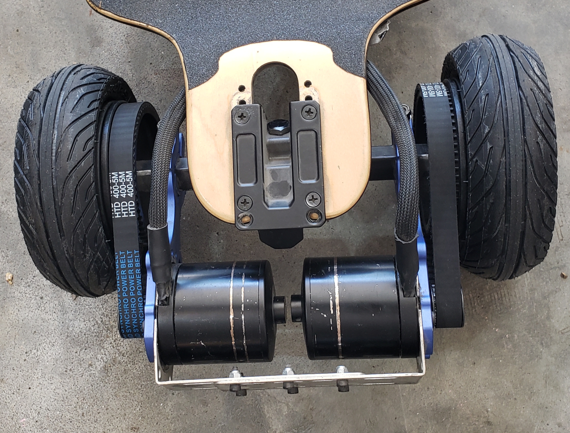

So one of my Maytechs seems to have an issue with the sensors. I thought it was a problem with the unity. But I just put it in a Flipsky 6.6 and when running detection one of the motors comes up sensorless.
Is this something that can be fixed?
I thought it was the connectors to the vesc but I soldered on new extensions
I’ve had this happen multiple times with various motors and just ran them unsensored.

ohhh, but I so love sensored FOC… I actually rode last night, and it was not bad. I guess one of the motors is sensored and the other one just catches up. When you run unsersored do you run FOC or BLDC. I am pretty sure I am going to order a set of Flipsky 6384s to put on this board now… since everything else on it is so nice. I just got them for another board, and only have about 35 miles on them, but they were running great.
