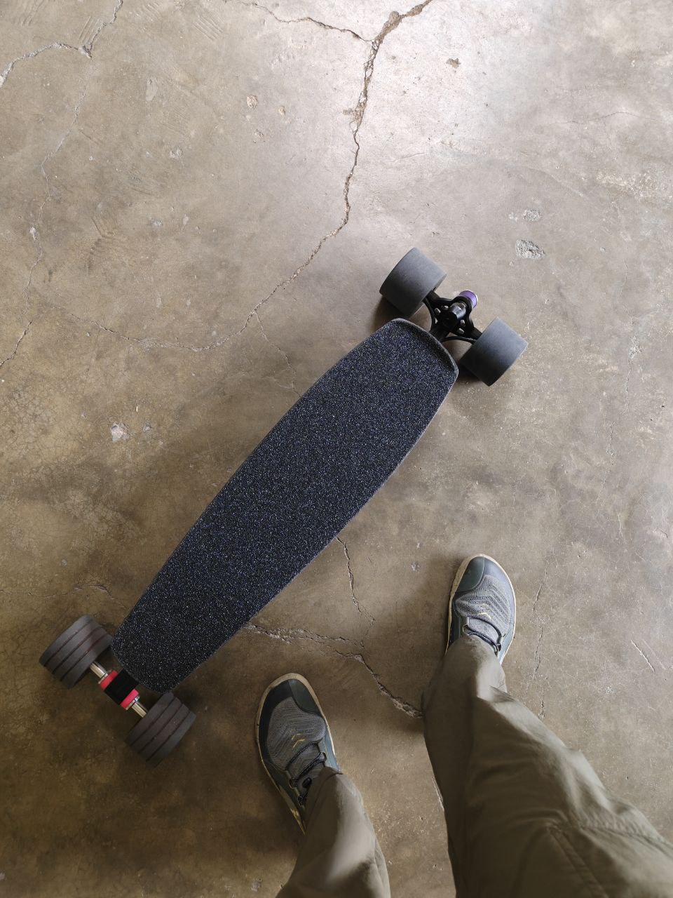

Maverick | Lou Deck | 12s1p P42A | CGB Customs Truck | DV4s | Not Neohubs | Puck V2
Yea it’s dyed Caguamas, the grooves are also cut

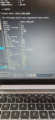

Very odd, tried to accelerate from zero during a test ride downstairs and it threw DRV errors.
I have set slow ABS, and my settings are these
Motor max 70A
Motor brake -70A
Battery max 30A
Regen -15A
Absolute max current 150A
What is happening?!
Which version firmware are you running? All phase wires okay? More fault info listed from terminal?
6.05 with the Maker X custom firmware.
Phase wires are 14 AWG, running sensorless VSS
Have you tried different sensorless modes?
I have found that cogging can sometimes cause overcurrent faults
I get drv faults when my hub boards cog bad. Unfortunately i cant seem to make my unlimited hubs perform any better. One set on a dv6s and one on a unity. Both throw drv faults if i dont push off
Ok, we’ve made progress.
I went back down to 5.3 firmware. It worked, for awhile at least. Testing on flat ground at the carpark was alright, climbing uphill had no issue. When exiting the subway, i went down a slight slope and when i braked, it triggered a fault. Weirdly enough, when i connect to the VESC tool app and check what fault it is on the terminal, it say’s there’s no fault, but there’s the blinking red light.

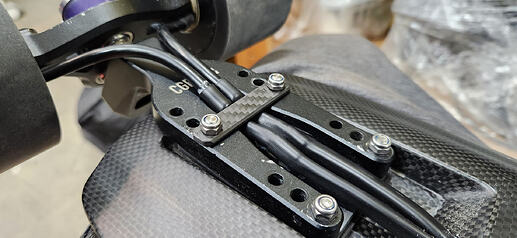

Made a plate to keep the wires together and not dangle.

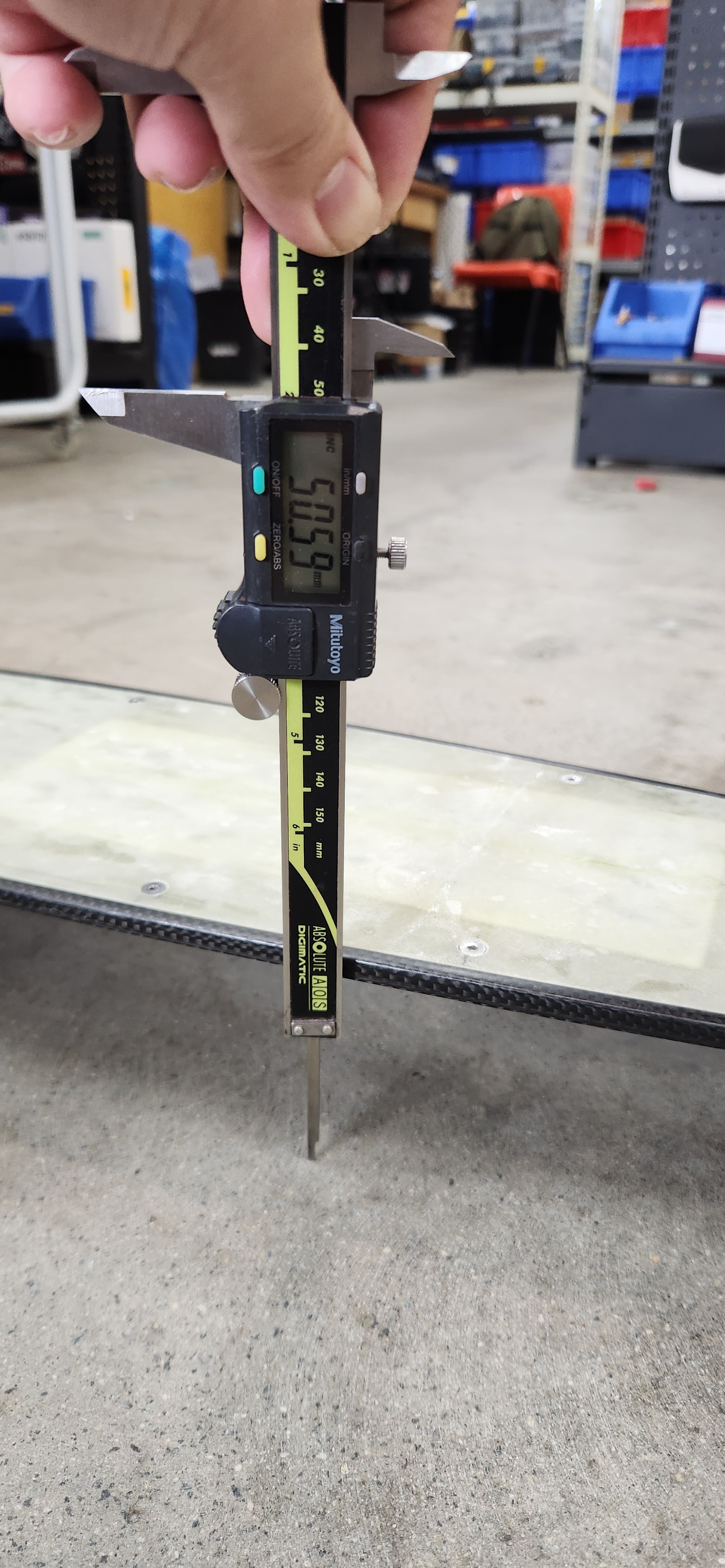

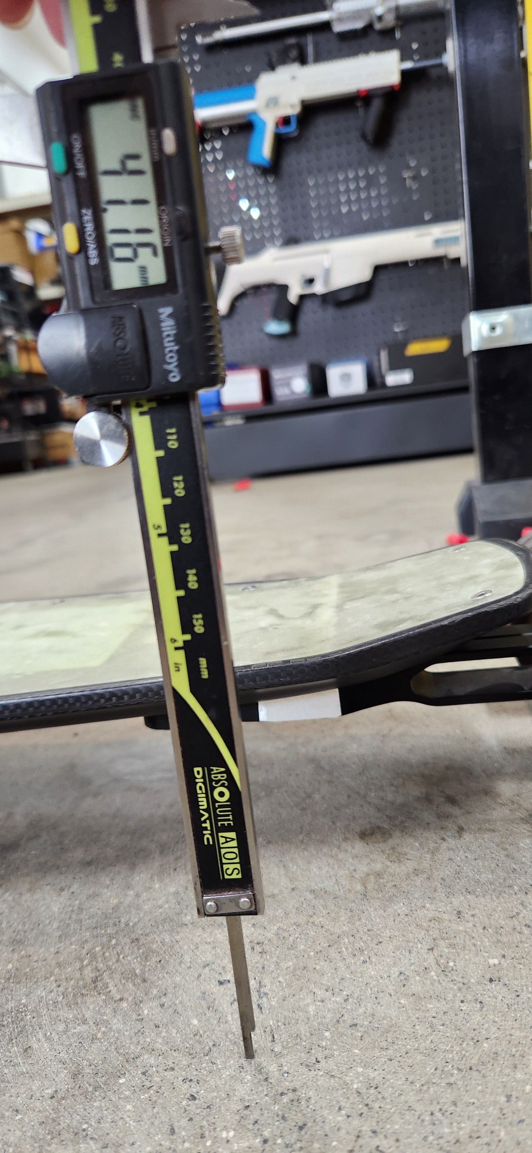

Ground clearance gauge
Wow we’ve got griptape now.

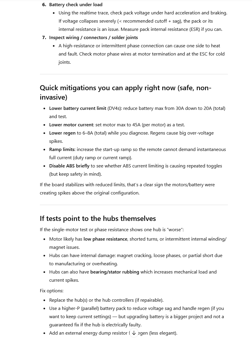

So i asked GPT (oh god no) to see if they can find out what i couldn’t.
Interesting.. It says that the spikes from dual hubs triggered faults because the ESC is protecting the battery. I’ll bump the settings lower and see if it triggers anything.
