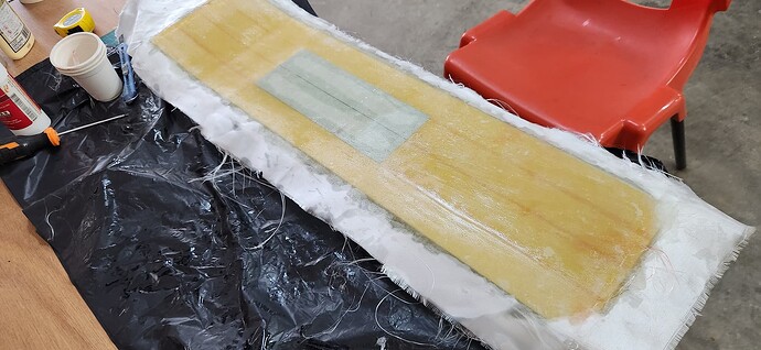

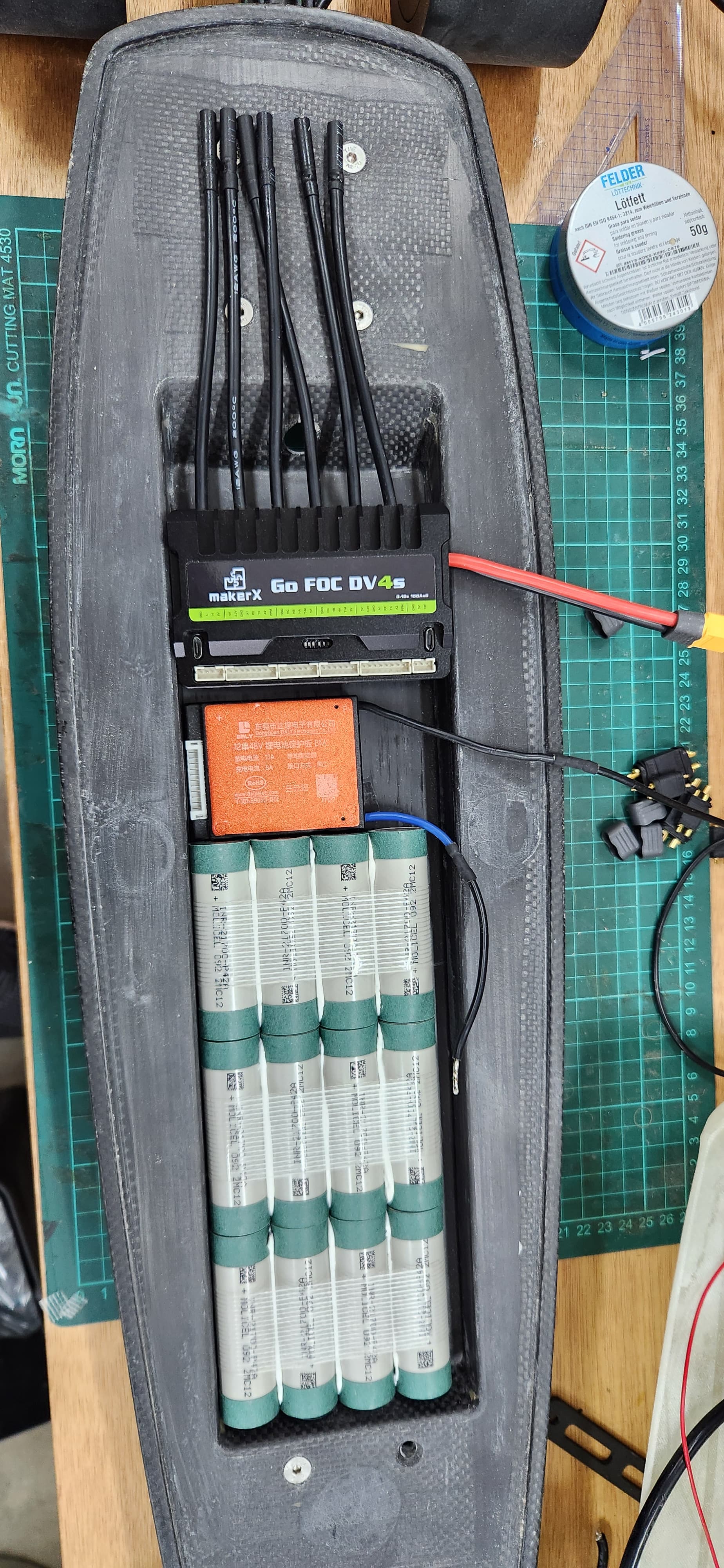

Custom lid time. This is slightly thicker, about 3mm thick, with a cutout where the battery pack is so things dont get too much pressure.
Also did a curve upwards where the nose of the deck is

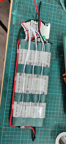

Update on the Maverick.

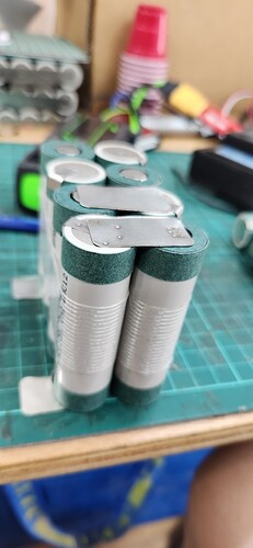

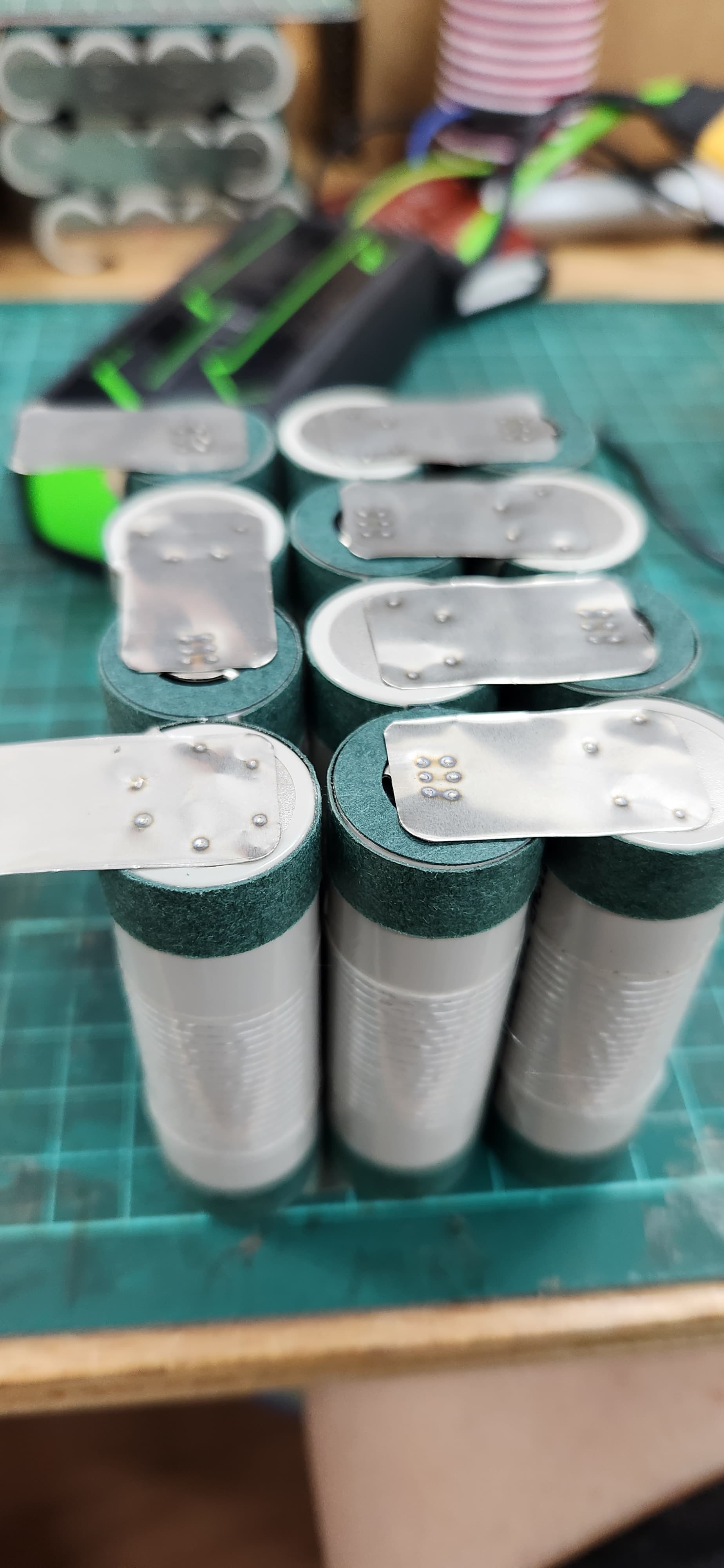

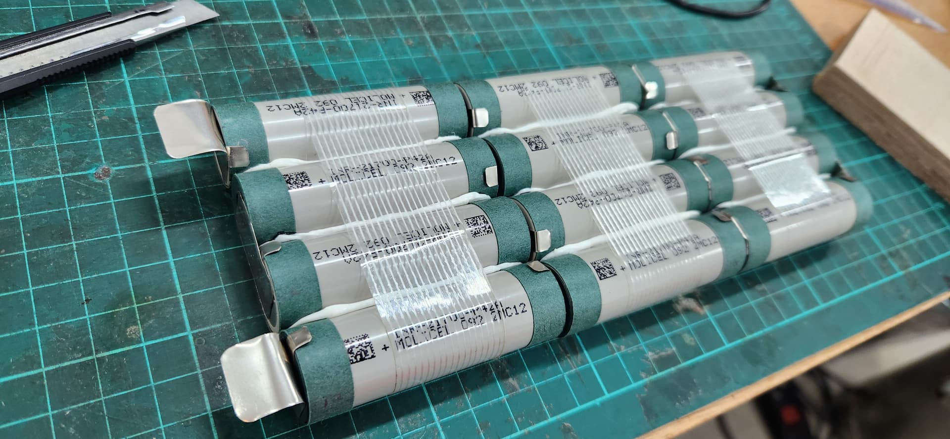

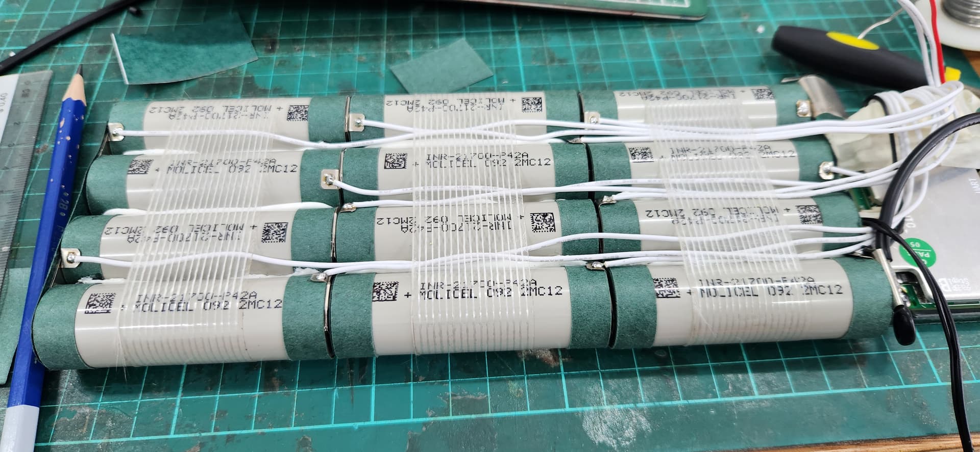

Ive decided to do a 12s1p, the extra 2 cells will give a bit more juice.

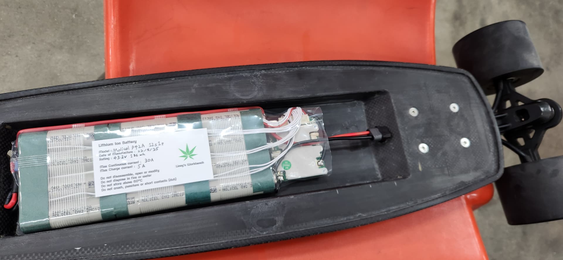

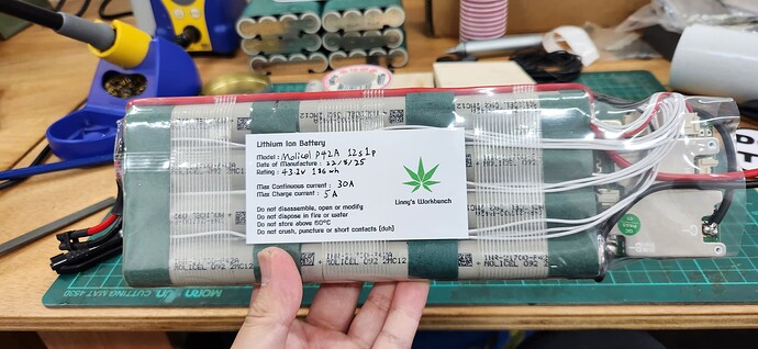

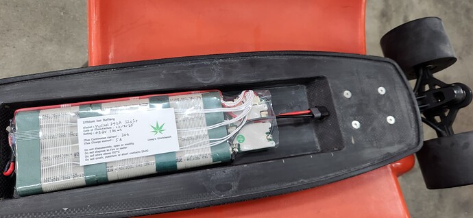

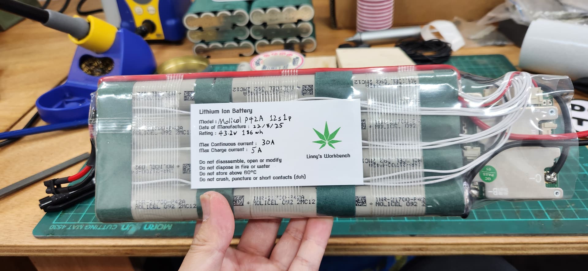

A friend works at a place that prints nice quality stickers. Theres always waste areas that get cut away so he was able to print and cut some nice stickers for my battery. Not sure if ill pursue battery making but more likely just for local orders.
Thats a sweet little setup :ok_hand:

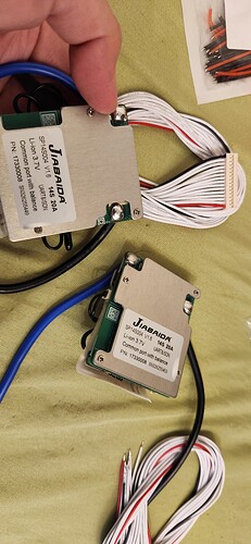

That little BMS is something.
It’s the JBD 14s. If that BMS didn’t exist i probably would’ve just stuck to the 10s1p with the Daly BMS.
They even have one that will do 50a continuous!! It’s so cute!
