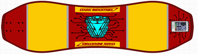

working on the griptape design
Thoughts?
Maybe make the outside lines of the yellow blocks silver to really match the armor look and add thin black symmetrical but circuit lines around the tape.
Like black lines spreads from the arc reactor heart and from both ends of the board where ur trucks would be. And add a slightly and i mean slightly thicker black border around the reactor and stark logos to give it just a bit more pop and stand out more.
The black border around the arc reactor was a great suggestion. Black circuit lines or cyan? How is the pattern? Too many stems, too few branches splitting from the stems, thickness? How do you feel about the silver around the yellow?
I’ll add the circuit lines around the front truck but back truck will mostly be covered by my esc+bms+etc enclosure and front truck will be davega. I think it would look bad to have it merge into the yellow? Yellow is for feet ofc. The back enc will cover up the whole medium red part. (I ride goofy) Davega will leave room to side for a couple lines…
Add silver on the other portion of the yellow tape. The circuit line patterns u made up looks nice try to add maybe 1.5mm more thickness to it as well as slightly longer around the reactor but davega lines length are perfect and cyan with black outline and full black circuit lines and see which one u like best. After that it should look pretty much perfect. Oh also if u can u know how the reactor starts off blue and the closer u get to the center of the reactor the more white it becomes try to add that in as well see how it turns out. The Raw/silver davega is a excellent touch to the front part of the deck as well
my davega is red sorry :frowning: thats just the picture i had also it doesnt matter what the middle blue colour of the arc reactor is because I will be cutting it out for my light panel that will go under the griptape
vs
vs
oh if ur cutting a panel then nevermind about the color fade idea then on the reactor. And dam though u was gonna use a silver davega i think that woulda looked sick but red is still fine as well. Pic 3 is the best the black outlines around the circuit lines are perfect not to thick like pic 2 but not super thin to the point where its just full cyan lines, adds that beautiful contrast we want. Same goes for the silver lines added to both sides of the yellow space where feet wil lbe place adds that nice contrast to make it all come together.Cant really think of anything else to add outside of once this tape finally gets made and applied to the board maybe adding rgb strip underneath the deck and making it cyan and white.
totally agree
grown on me and now i love it
already in my plans
Thanks so much for your suggestions they’ve been great! If I stick with the pcb lines then ill definitely go with v3. I’m not sure if I want them because they wont light up like the triangle. Also iron man’s suit doesnt have them. Idk if it looks tacky or I like it
