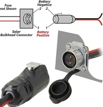

My charger is done! Soldered xt90, crimped bullet blug in the middle, soldered lp20 charger adapter. All in silicone tube with fiberglass tape around. Lp20 and xt90 have some heat shrink tubing around them. I did a pull test for my solder and crimped joints. Solid. 2pin Lp20 used by lacroix and other high end brands so we can share chargers!
Apparently Lp20 is also used by RVs. I’m hoping lacroix and others follow this diagram of pin2 = -ve and pin1 = +ve. But if not I can switch the bullet connectors!

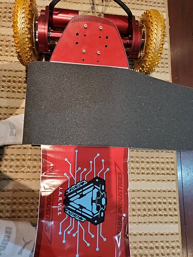

Screenshot_20210605-025110_Gallery
Except Gold griptape.
Bro. You can’t do all of this and just put plain black grip tape on it…
Of course not @rosco :slightly_smiling_face: exact same color as tires
What about glass frit? Yellow griptape is gonna get real dirty real fast.
Wait. Please tell me your plan is not to spray paint this grip tape lol
Not yellow mate. Gold
Gold frit or those metal studs like brown5ticks board could look awesome on the red deck colour.
Think frit gonna be an issue tho. Prob wouldnt apply well over a vinyl wrap.
Please forgive my ignorance, it’s clearly gold not yellow. I’m just a color blind pleb who knows not how to discern the two.
In regards to the wrap that is a great point, didn’t think of that piece… A quick forum search though and I think it’s been done a few times? I saw a longhairedboy post about one he did for a customer and another from glyphiks over on freesk8
It is :grimacing::pensive::see_no_evil:
People use clear griptape all the time… I used it because I wanted to add an effect to see what was below it. Many people use it if they like the wood grain or design and want to see it. Other like myself modify the deck and want to be able to see that and still grip to the board. So yes it is viable
