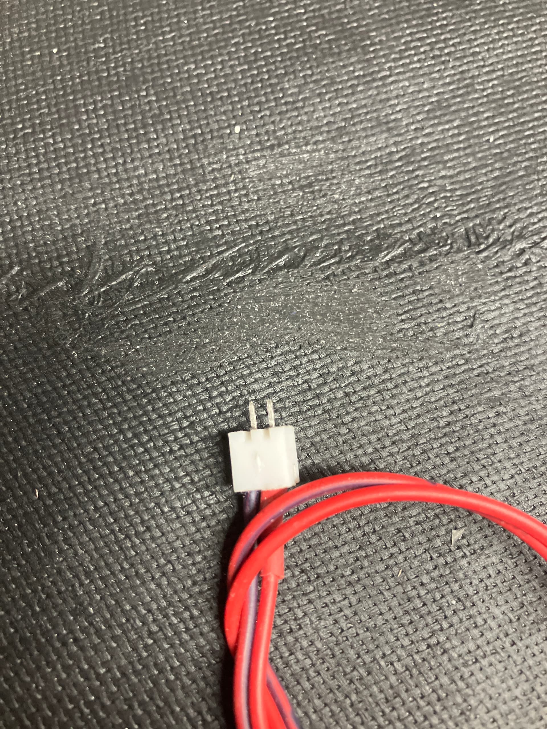

Why not take this same idea a bit further, get a jst headder that you can plug into a balance connector
When im not feeling steady handed I just put my clamps on the leads and test voltage with this little jig moving from group to group
I only have 2.5 or 2.54mm two pins jst connector and the daly bms is 2.0, I believe.
I should defintely acquire 2.0mm spacin do that though.
Great idea…I do manually balance some 3s1p packs, injecting 4.19ish volts into the low dog cell via JST 2.54.

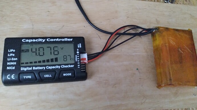

I kinda wish i could plug my balance connector into one, or two of these:
But it only reads 7 cells.
There is a blue version which does 8, and it might balance too.

I have two of those 7cell lcd capacity checkers. If i get an 11pin header for my 10s bms connector, I should be able to feed cells 1 to 5 into one unit and 5 to 10 into a second, I think, and easily be able to scroll through the10 P groups.
