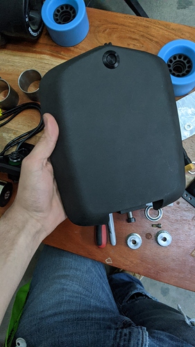

Here’s a sneak peek of what I’ve been working on, I am not revealing everything at this time. I will continually update this initial post for newcomers to the thread, and be posting photos as they’re taken in the discussion that will likely follow below.
What I’m actually trying to do:

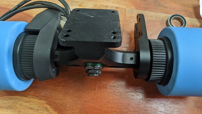

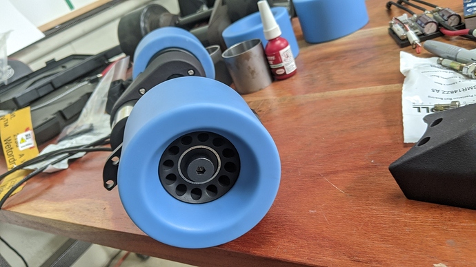

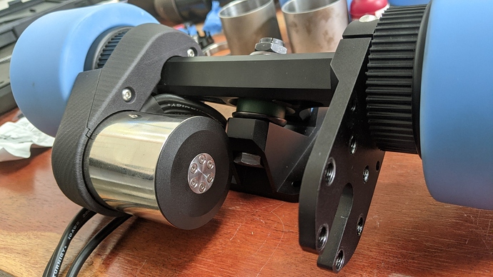

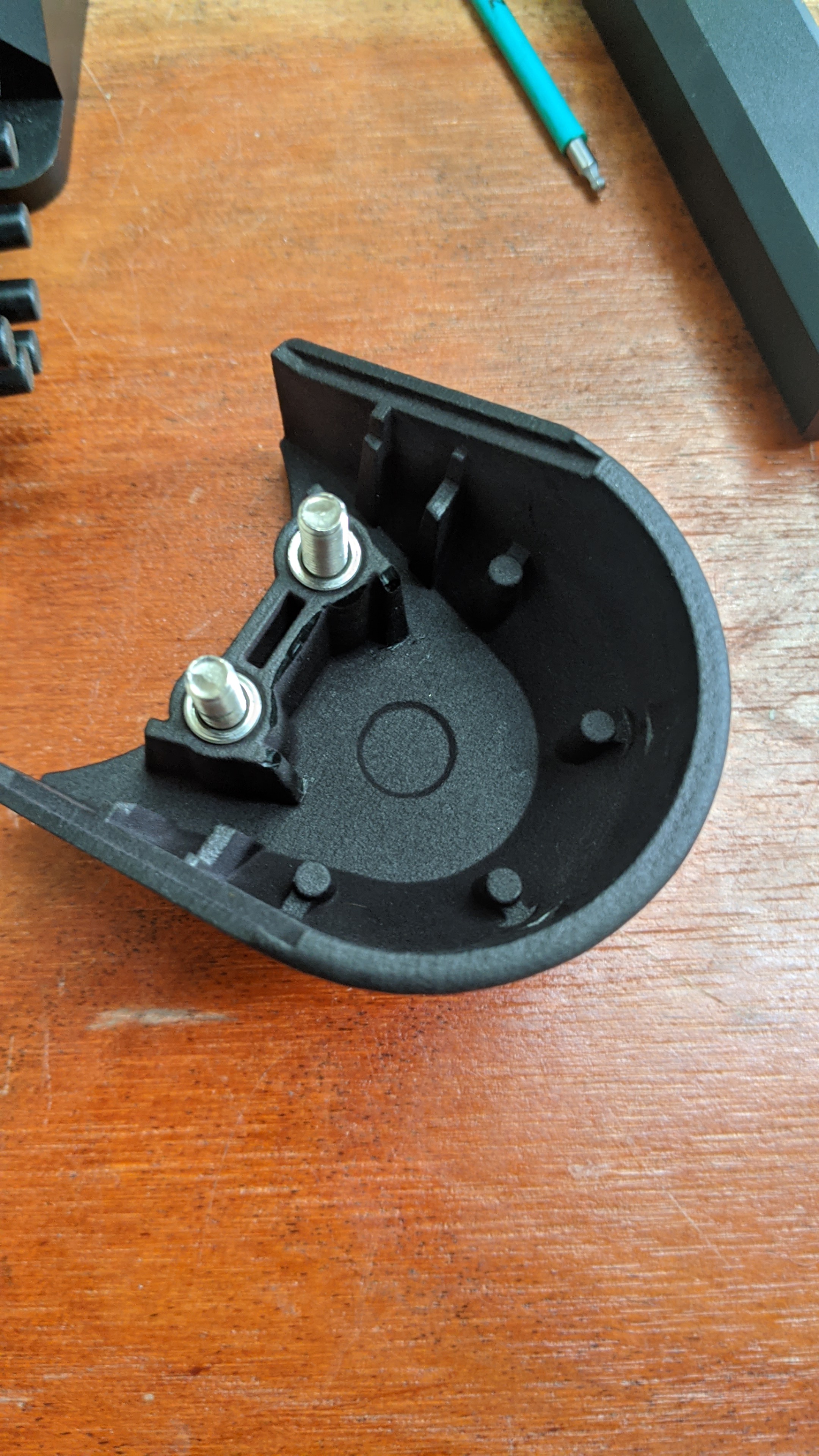

A complete drive kit. Buy preassembled as is and install. Includes wheels, trucks, the whole shabang. Motors have a novel cooling technology that I have yet to test, which allows them to be higher power with a smaller package. Trucks are designed around a 10mm shoulder bolt system.

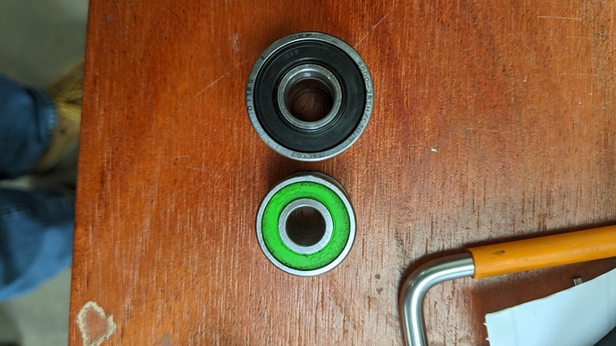

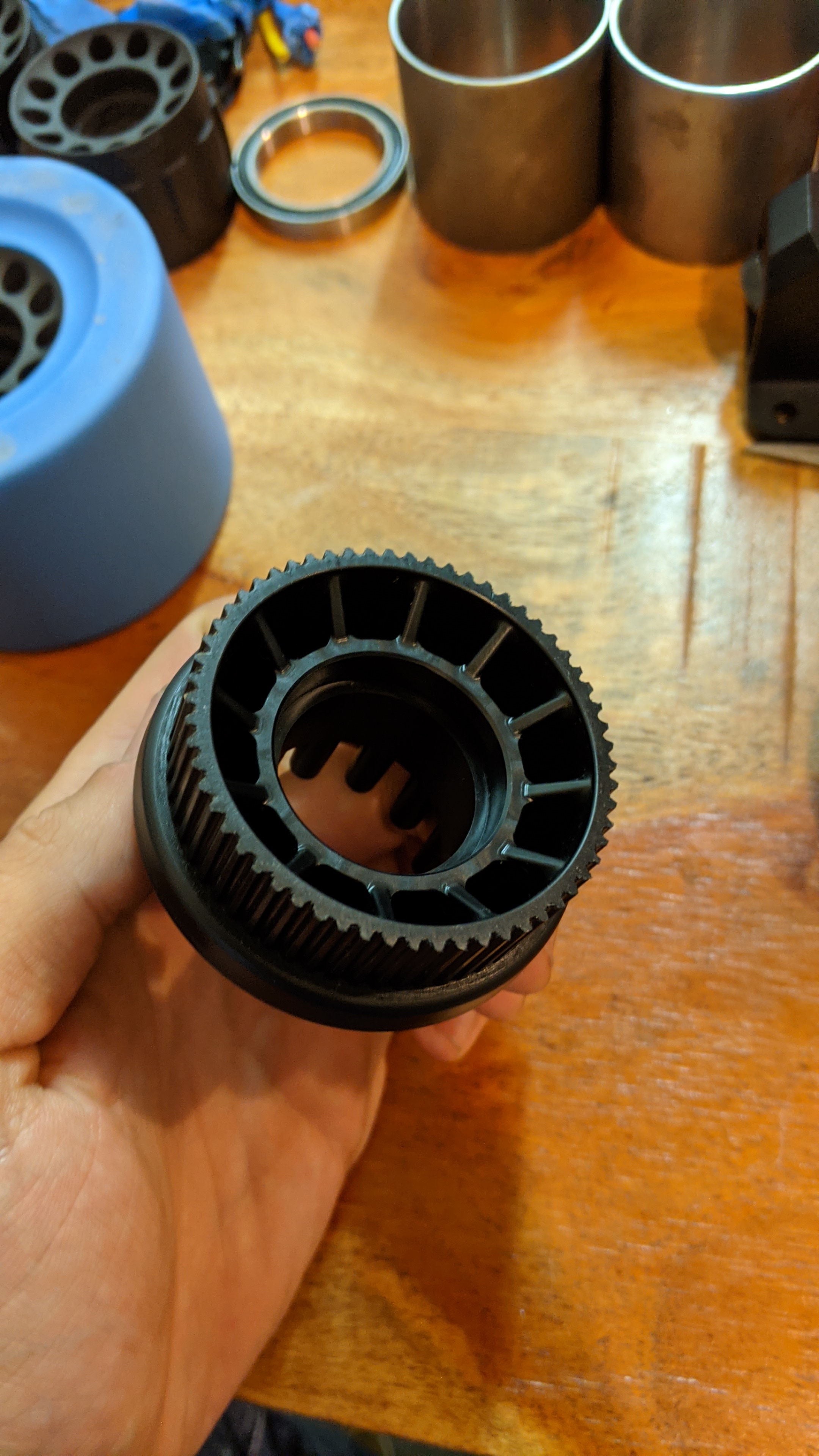

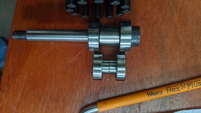

Additionally, I’ve developed a new wheel core. The name has yet to be finalized, but I’ve nicknamed it the Ultracore. It uses 10x26x8 bearings, with 4.8mm balls.
I will be releasing the design files for the core when wheel production begins, so anyone can make wheels like this.
Peep the pictures here:
Peep the test results here:
To be disclosed
I’ve put hundreds of hours into this already and more money than you’d think prototyping. There’s plenty that’s been going on behind the scenes that I haven’t revealed yet, so please be considerate.
As a side note, I will never be accepting preorders. Eventually, there will be free reservations so that I can estimate how much stock to manufacture. Please ban me from the forum the day I propose anything more than that.

The first wheel size will be 90mm x 60mm (55mm contact patch). It made the most sense for the overall package while maintaining a comfortable ride. A goal is to reduce overall size and weight with this new motor tech, so giant wheels don’t really make sense.

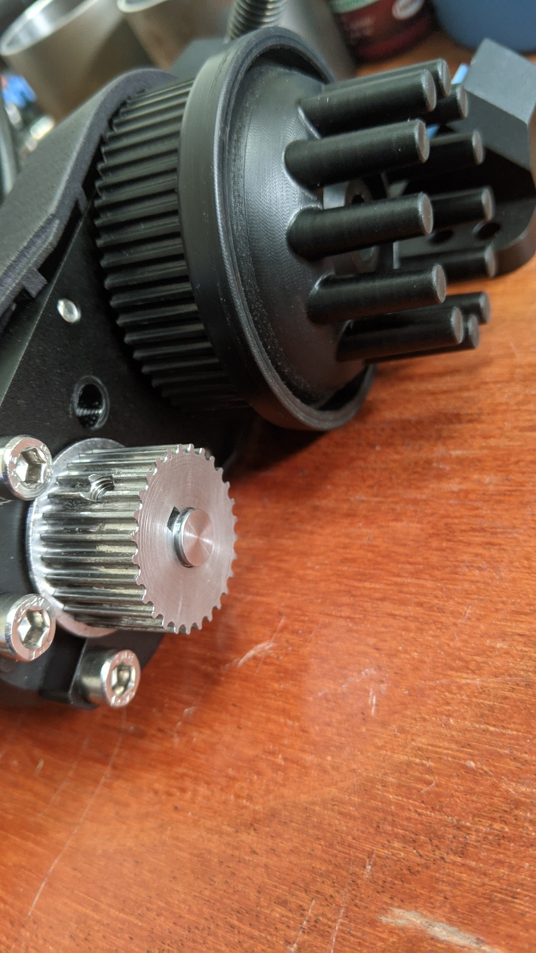

Sounds pretty cool though, the core space has been dead for a while, what kind of interface do the pulleys have with the wheels?

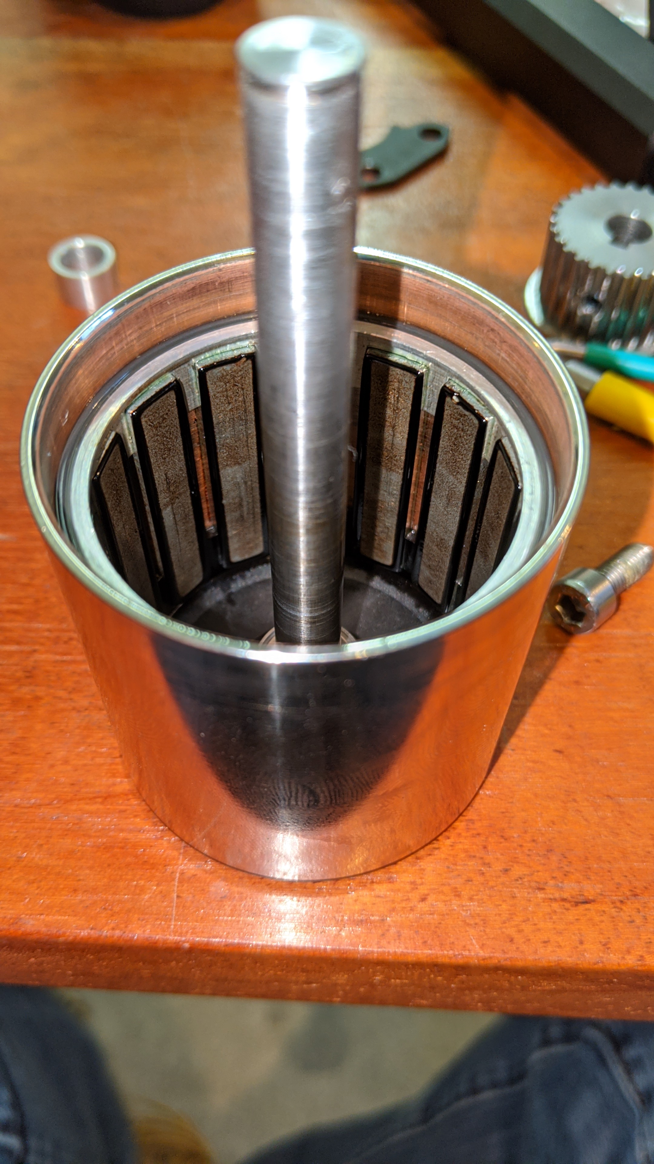

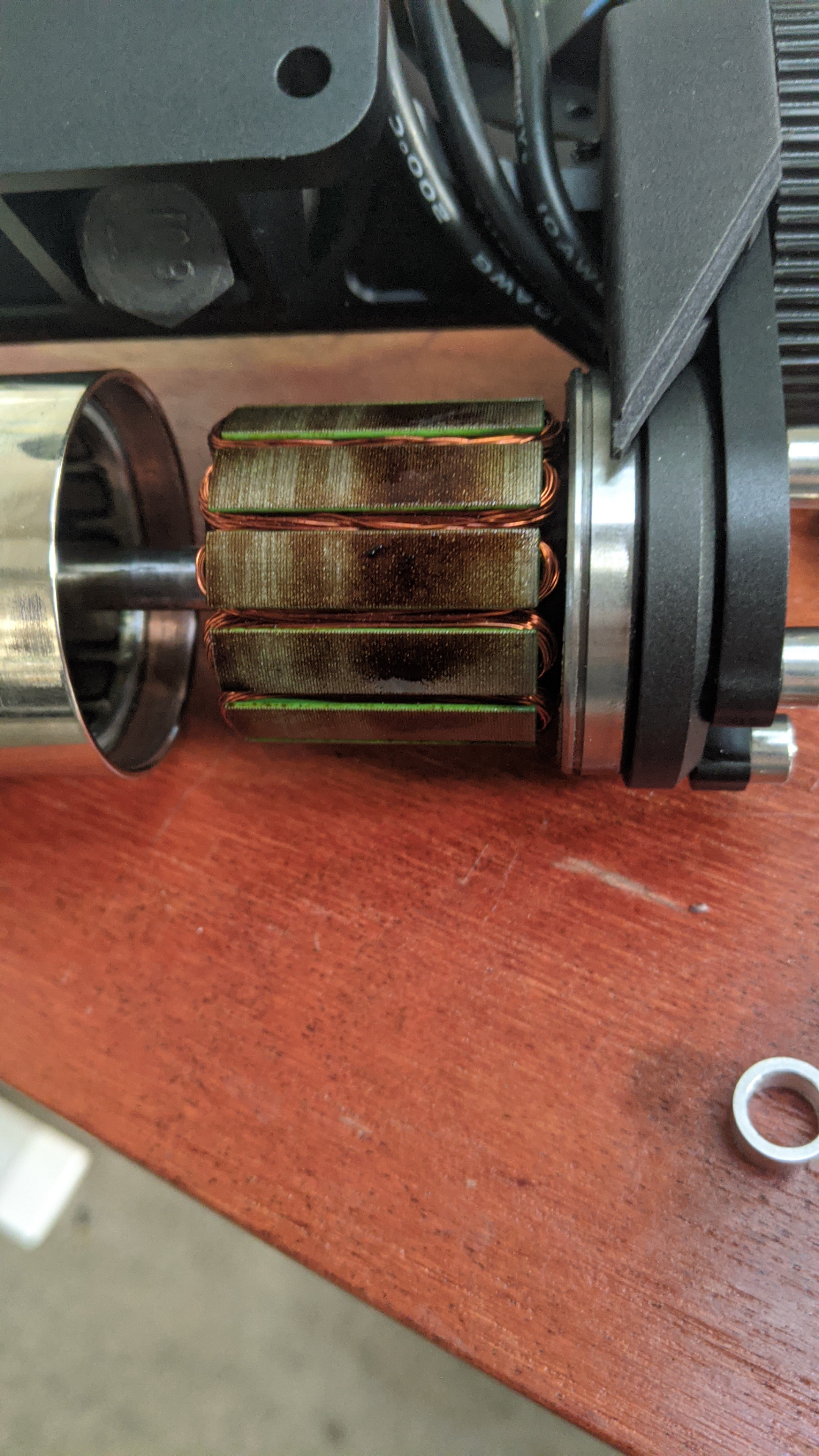

I’m not going to make any claims without data to back it up. These are 40 x 35 mm stators that will be able to handle higher amps than other motors of similar size.

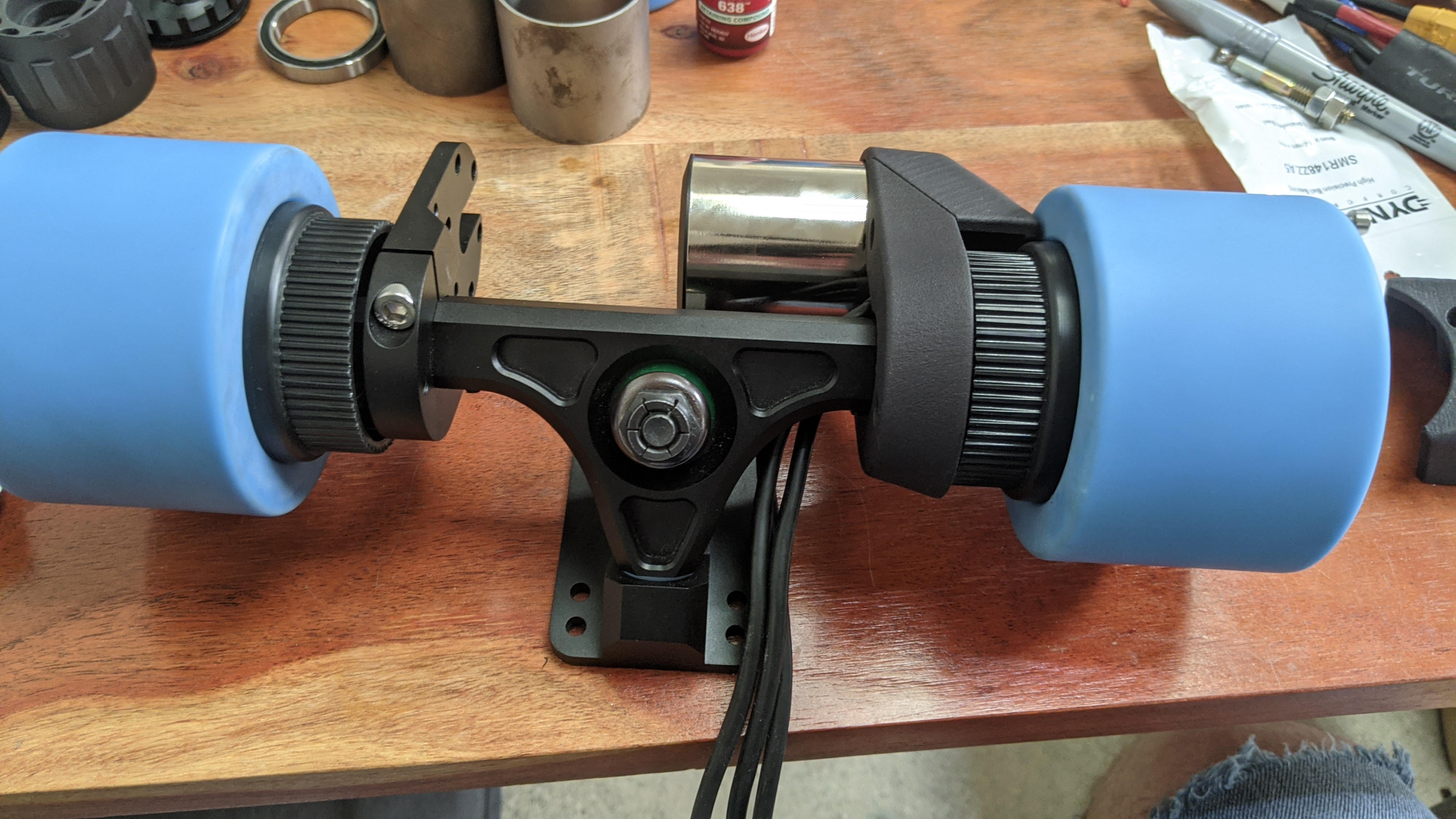

Newest iteration just popped in the mail

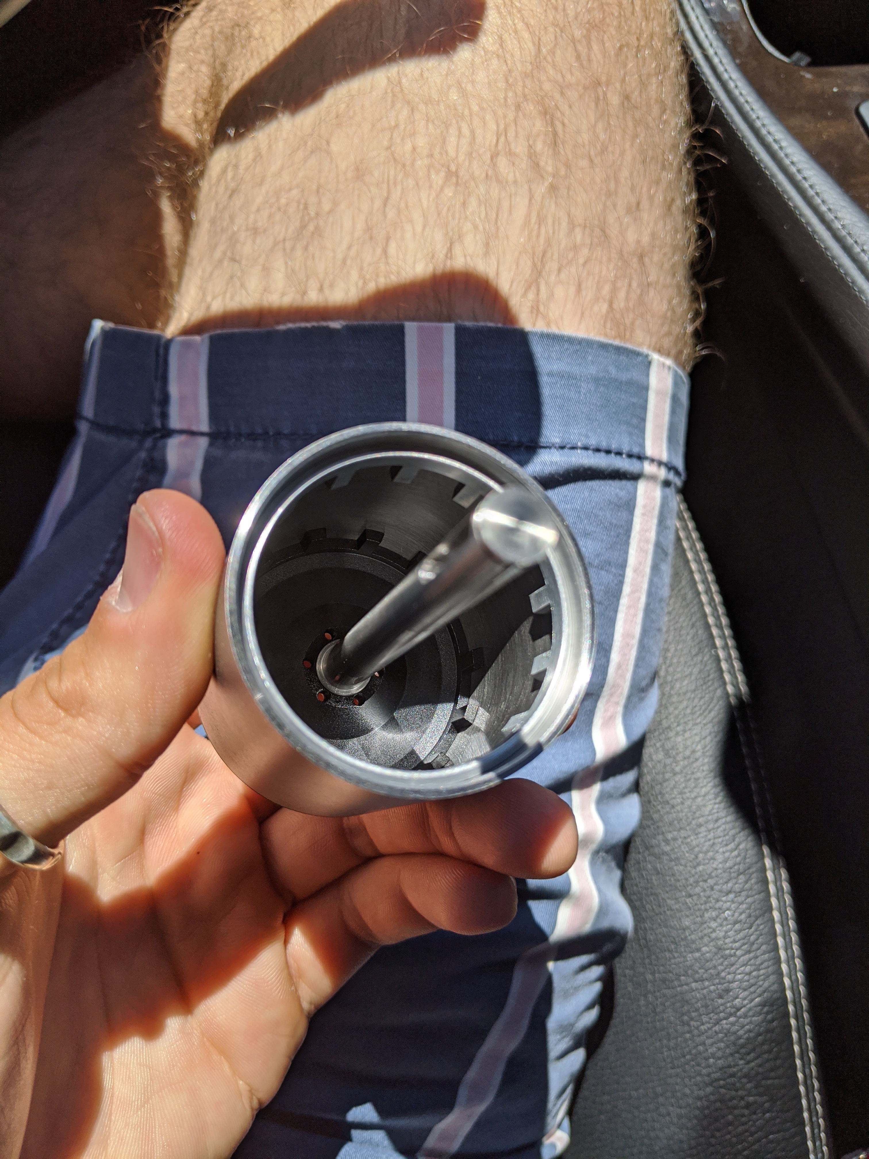

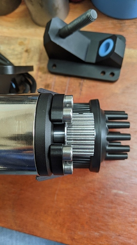

Retention ring too tight, slight adjustment needed but overall everything fits. Waiting on more bearings.

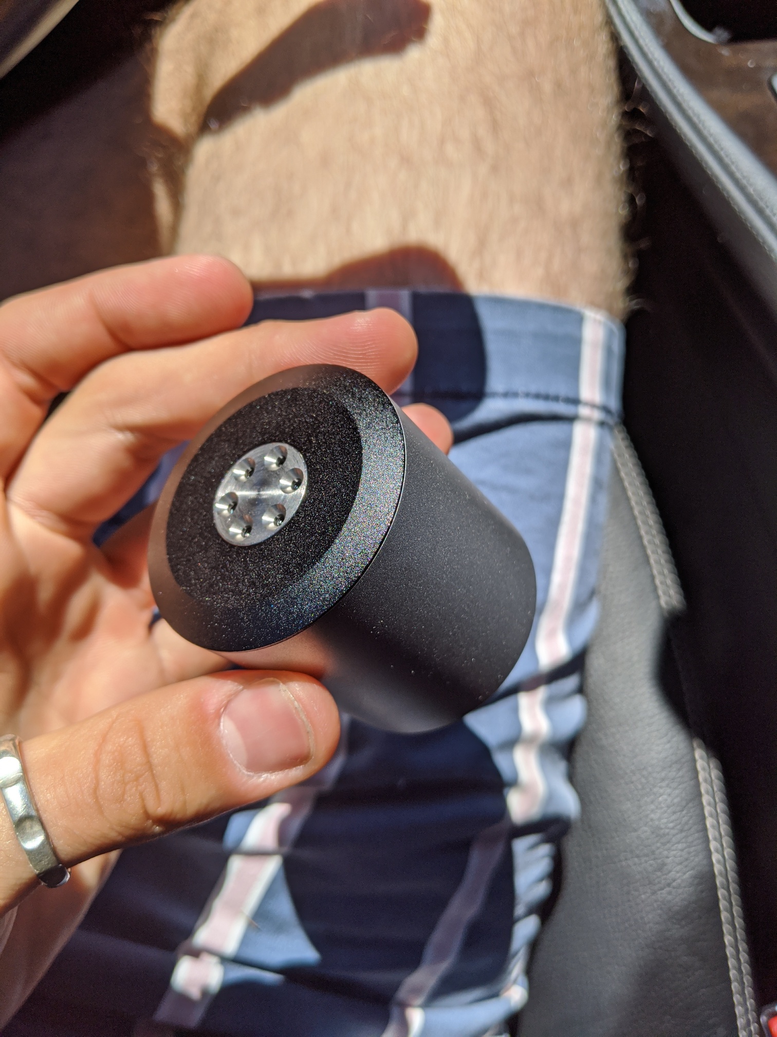

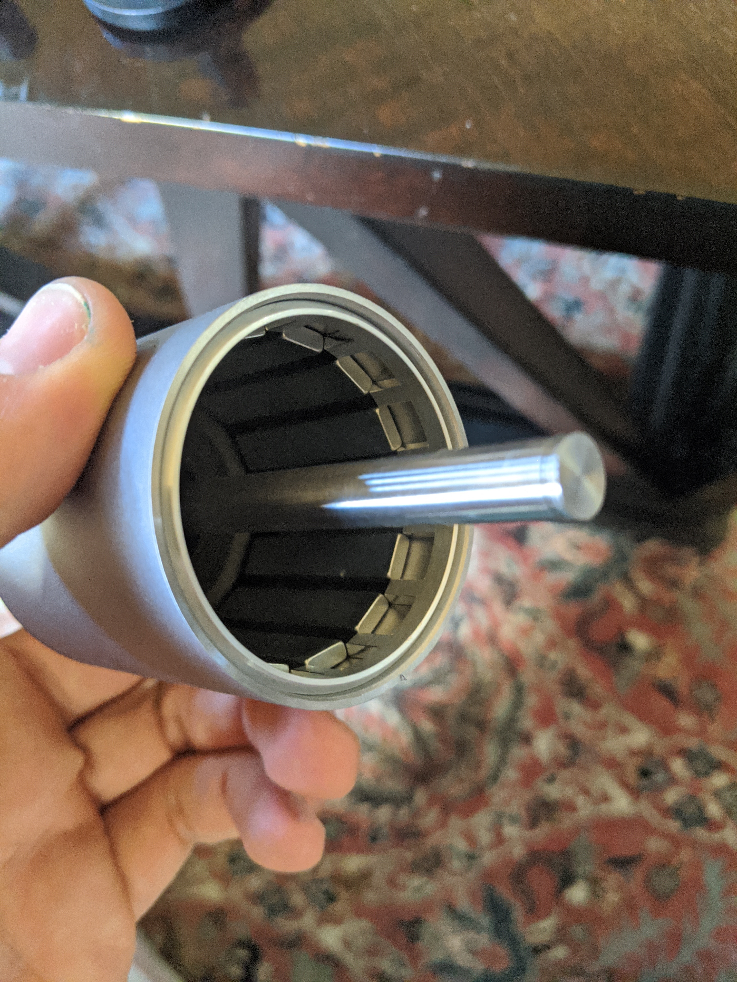

One thing that greatly helps is that these motors will be completely sealed from dust and water ingress. That helps a lot for features regarding airgap and magnet adherence.
I also noticed a point being made about redirecting magnetic field inside. I’d like to point out that these bells have virtually zero magnetic penetration. Magnetic viewing sheet hardly detects any field on the exterior, and I haven’t been able to sense any attraction to steel parts.
This is in part due to the alloy selection for the can, which has some drawbacks. As a result, these cans need to be electroless nickel plated for the necessary corrosion resistance.
