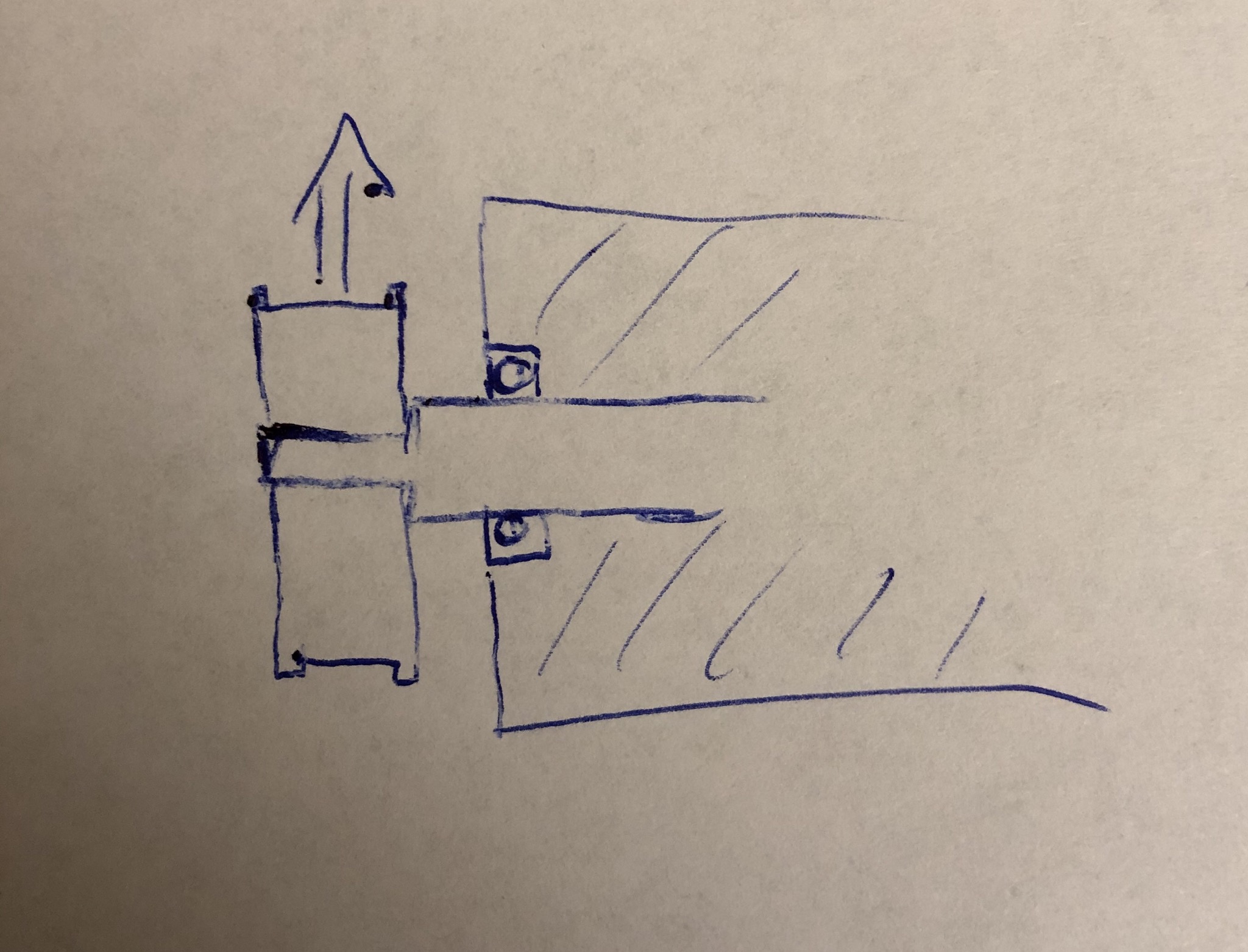

Is this good or bad?
Not sure if my Picasso skills help here
but I tried, so lets say people use a belt setups with idlers, worst case they run tiiiight belts.
Each time you do hard accelerate you see a force like this.
Where would you break if you would be the shaft ? ![]()
It’s obvious where the failure point would be, but 8mm case-hardened steel is so strong that I think you’ll snap off the motor mount bolts first.

For me would be interesting to hear an opinion from somebody who really has knowledge about material strength and stuff. I could imagine it also does have an influence if the shaft was hardened and after the step down was made with a lathe or similar.
I believe the step down is made before the case hardening.
