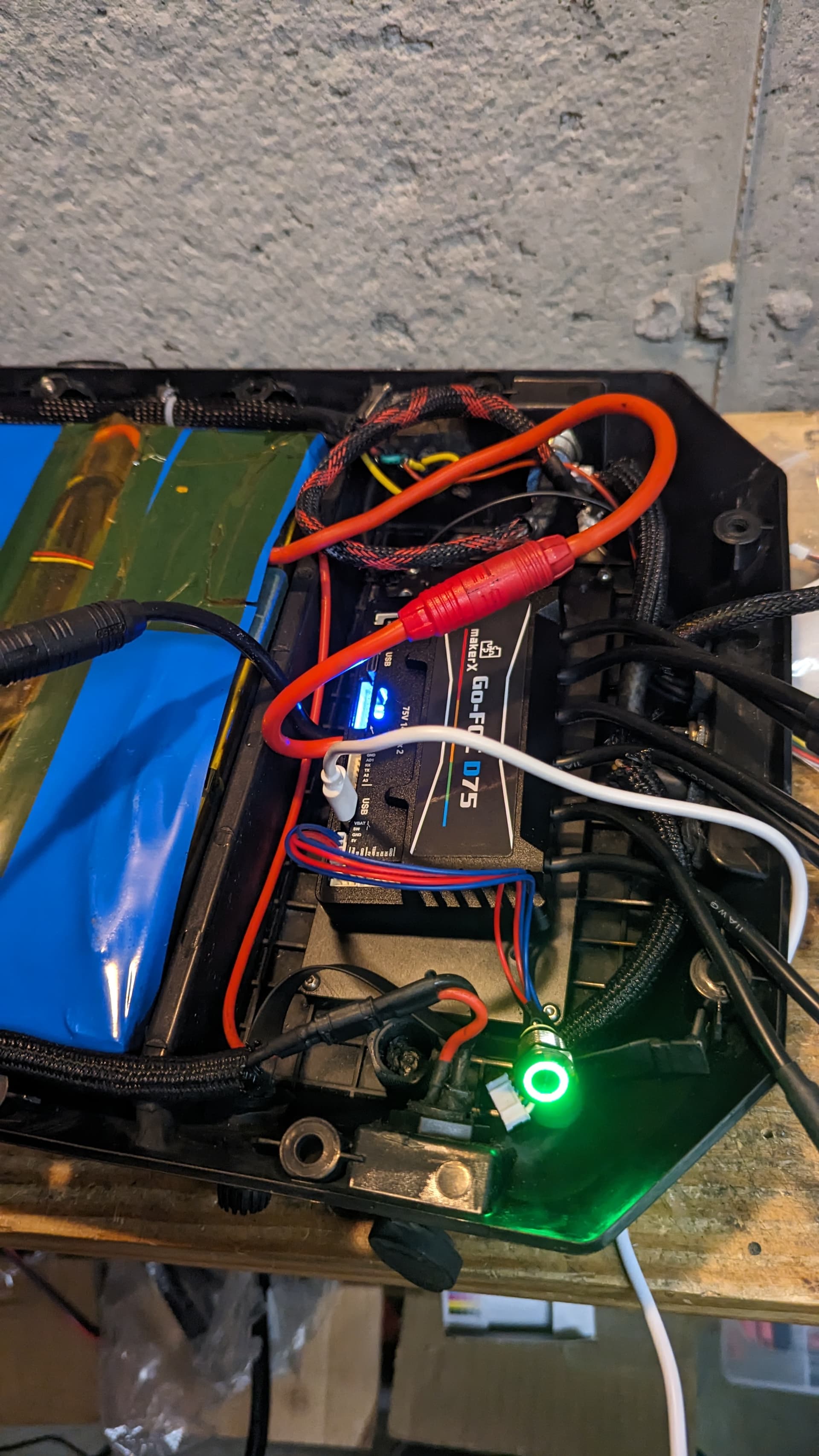

Quick update: I swapped the motors to the other sides and now it’s working without sensors.
But when I plug the sensors in it flashed red until I take them out
So just dead sensors maybe?
It’s a Baja S2, not sure who’s motors they use but i don’t see why they wouldn’t be compatible :thinking:
I had drv faults just from using the mobile vesctool
How old is the ESC? For some reason, the most recent DV6 Pro units I setup were a breeze to get going and ran fine on FW 5.03
I did have one unit when they first came out that gave me grief and I had to get it on FW 6 before it would start working/throwing some type of meaningful error. My issue ended up being a bad solder joint…
Also trying to get the FW6 loaded proved an effort and almost sent me mad.
Looks like you are using the app too. That’s deadset all my issue was. Unless you have an older APK I wouldn’t use it for anything other than looking at RT data.

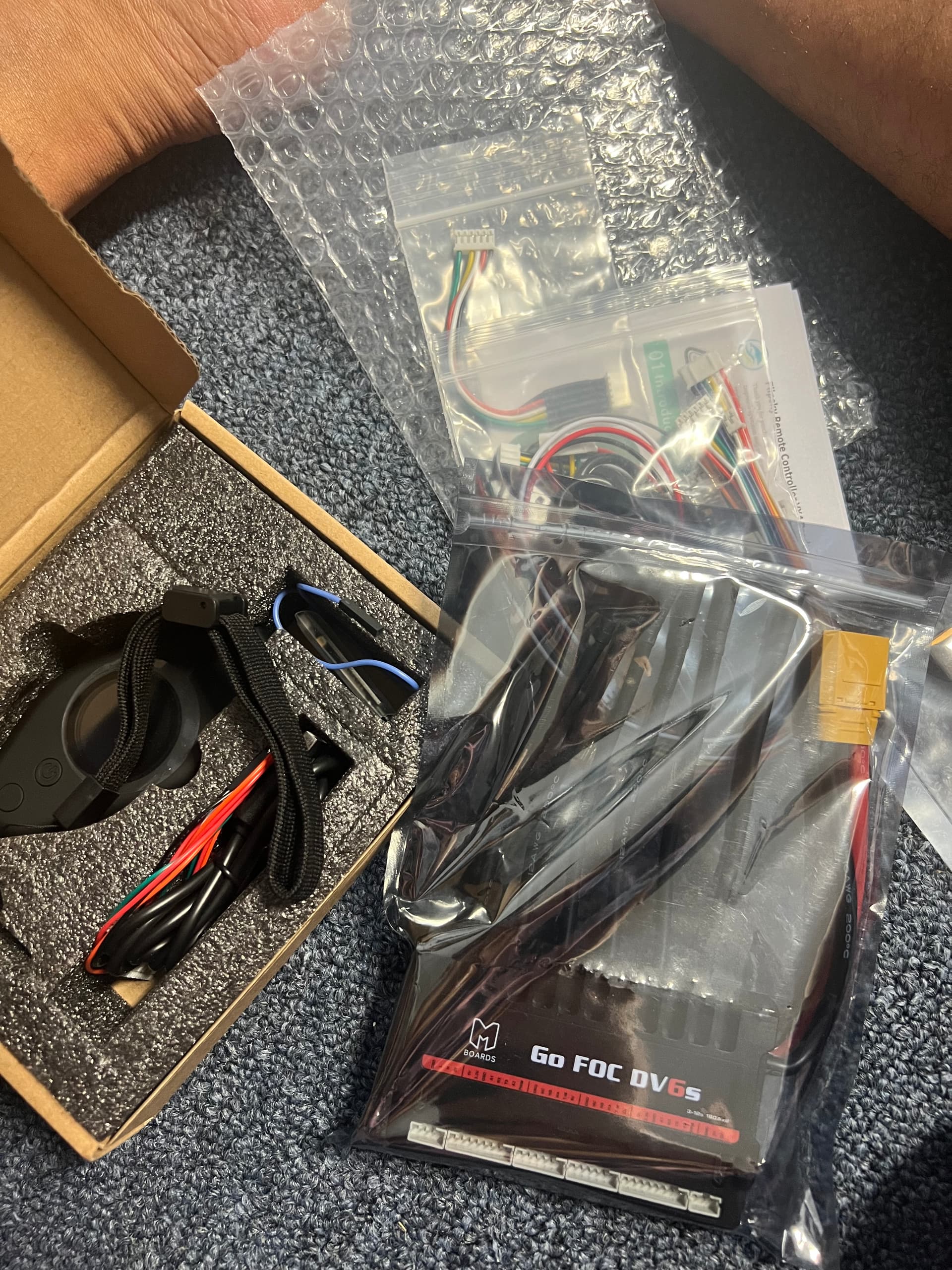

Hi friend, are you the creator of the video that shows the installation and configuration of the DV6 on YouTube? Could you help me, mine arrived here at home today
