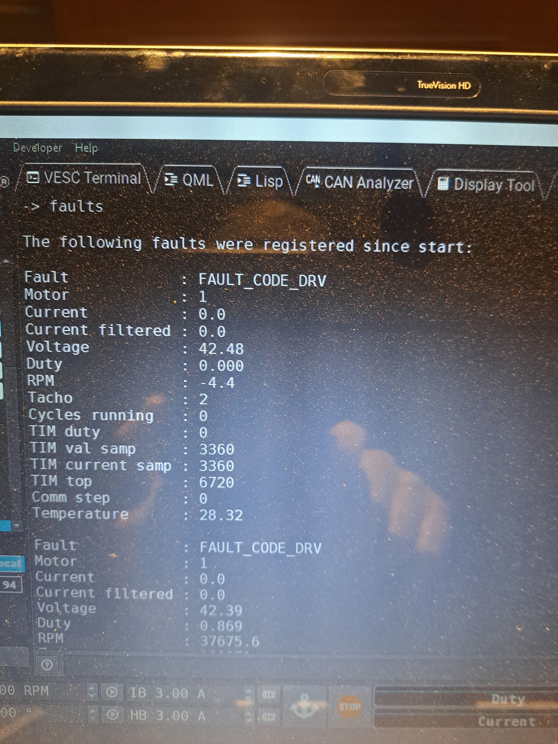

I have a Lacroix Nazare with the following specs:
12S6P Battery with Molicel P42A’s
SKP 6385 Motors at 151 KV
Flipsky VX2 Remote
MakerX DV4
I recently updated the MakerX DV4 Firmware to the Firmware 6.02 Version from the MakerX Website and I ran the Motor Set-Up Wizard and the Hall Sensors were read properly.
Everything seemed to be going great. Both motors were spinning great and the remote was working properly.

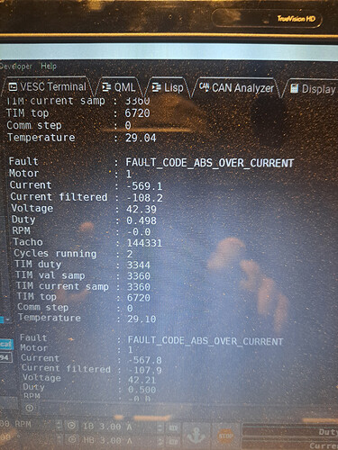

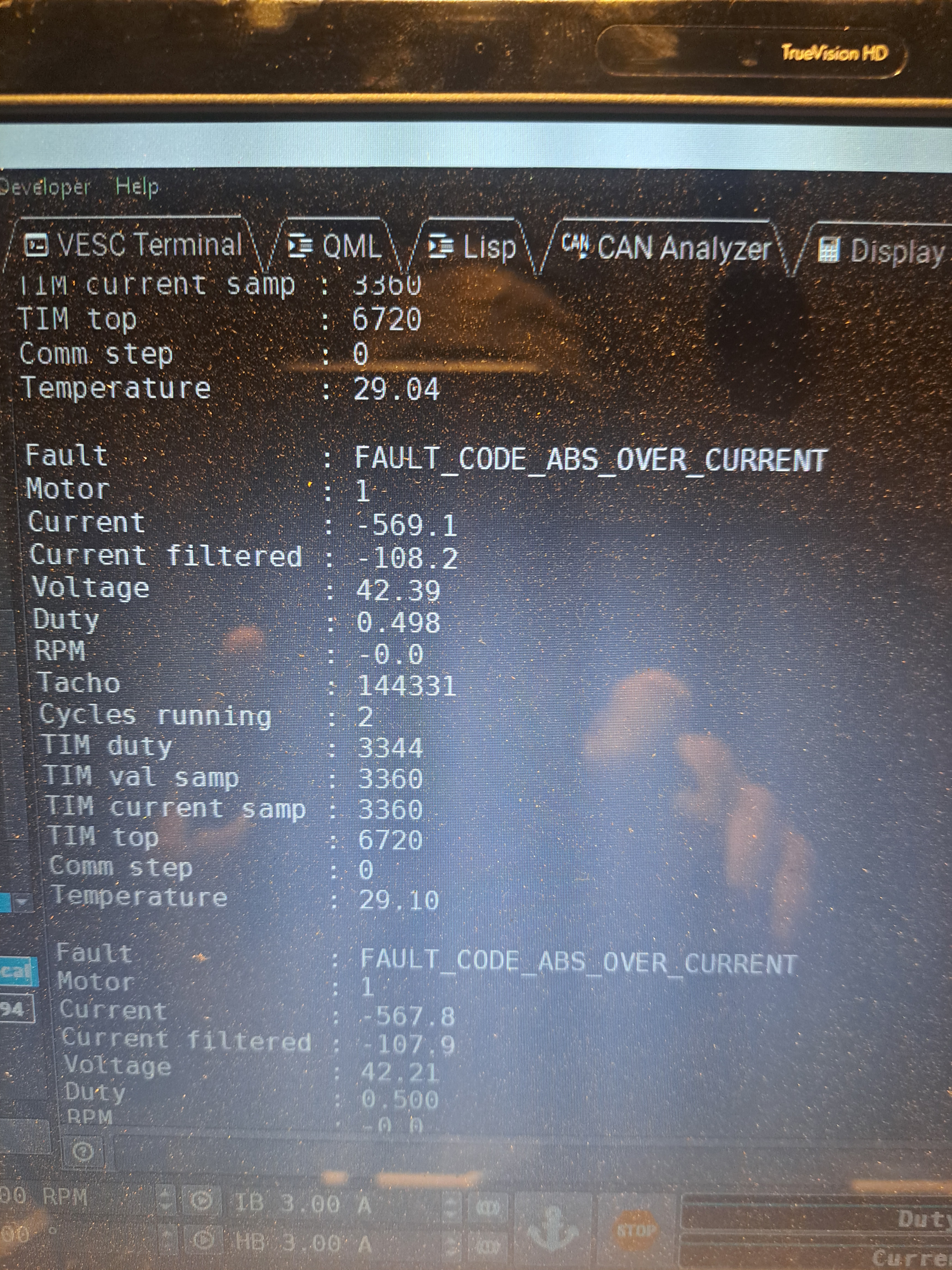

But now, after some bench testing, 1 motor just cuts-out. Everything seems to be going great, but then 1 motor just stops working and I get a red flashing light on the VESC. Then when I turn the board off, and then back on again - both motors work for a while until I get the same red flashing light again.
I checked all of my Motor Set-Ups on both sides of the VESC and my ABS Current is set to the Maximum 150A on both VESCS.
Here are pictures of the Motor Set-Up and Fault Codes I am getting when 1 motor cuts-out:
I’m hoping that something isn’t set correctly in the VESC Tool.
Any help will be greatly appreciated.

It appears that the DRV Chip in the VESC just blew. It was working intermittently before, but I just heard a pop and a smoke smell. This should not be happening. All of the connections are factory and the VESC Settings are within limits.

I figured-out the problem. A bad motor was causing the ABS Overcurrent. I hooked-up the bad motor to an old FocBox that I had and it threw the same ABS Overcurrent Fault. Upon further inspection, the bad motor doesn’t spin as freely as it should. Then I hooked up a brand new Flipsky Motor, ran the Motor Wizard, and it worked as it should. So I’m just going to order another VESC from MakerX and hopefully, I’ll be riding soon. Thanks for everyone’s help.
