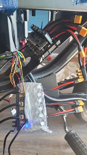

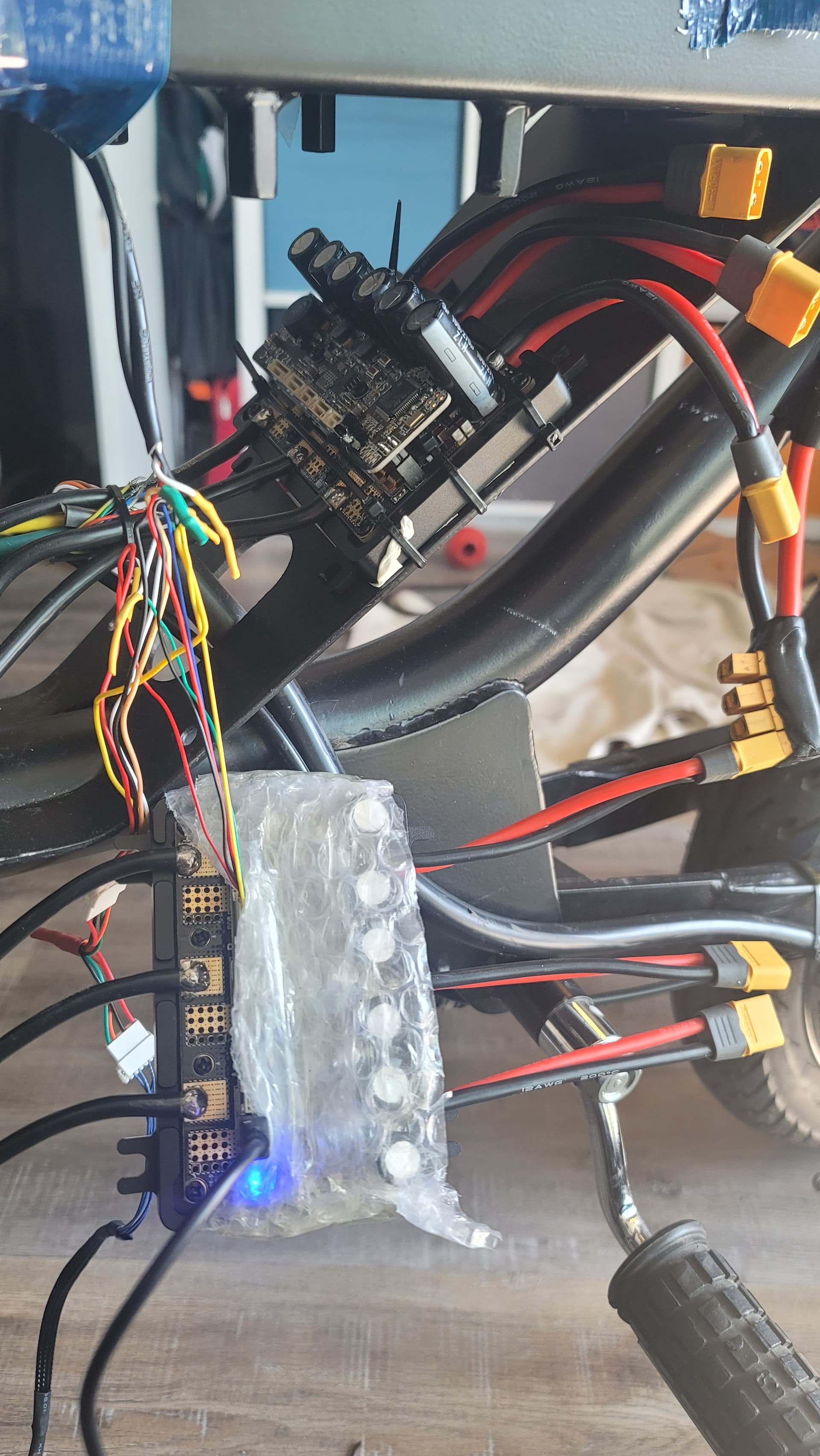

. I’ve tried 3 Bluetooth modules on the 100/200 vescs.
  1. Metr pro
  2. Another metr pro
  3. Freesk8 ble module
5.1 or 5.2.
11k baud rate. Uart turned on in settings
none connect.
I try those same ble modules on different vescs and they work.
What Bluetooth baud rates etc?
