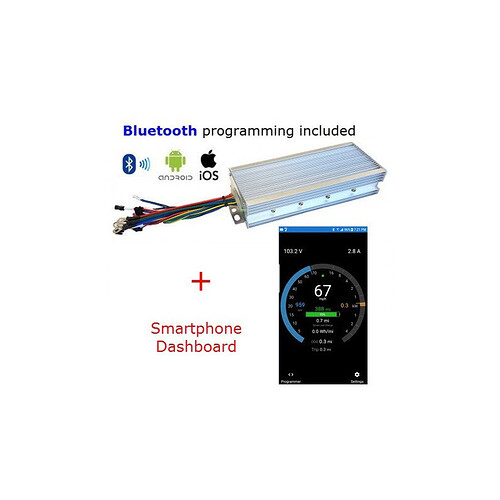

To keep in topic, here’s an example to illustrate my point :
This is literally a good programmable esc for brushless motors with FOC, mobile telemetry / datalog, cruise control, etc… Most of what you expect from a vesc + accessories is already inside and reliable.
This is nothing new on e-bike scene. In fact, if it wasn’t for the fat size you could perfectly mount it on your e-boards and they’d run flawlessly powerful all day.
When you check “operating voltage”, it clearly states from 30 to 100v and you can effectively plug a fully charged 24S li ion battery to it. 100.8v operating voltage.
So instead of misleading ads based off absolute max voltage, it goes as far as cleverly advertising max power (Watt) and states in description how you can effectively use it.
Edit : You can find it by searching “100v e-bike controller” on Google btw, that’s what I did. 10 seconds find.
