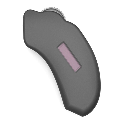

Anyone using the remote experienced latency? I think I went through all the settings and nothing helped, the reaction time in the motors is somewhat off by around 1.5 seconds.
@YUTW123 does the main battery need to be connected on the DC-in 6-60V port for the battery reading on the remote to work? I can get all the other readings like speed, distance, voltage but battery is always zero?
EDIT: just managed to figure out how to enter the remotes settings and got the right readings now - would it be possible to send screenshot of the manual since I didn’t get one?
also @Komamtb I had to reduce the deadband quite a lot from 15% to 3% so not sure if that is contributing to the latency?
wat… nonono. The vesc reports all the data to the reciever, its possible that you need to upgrade your remotes fw. You also need to set correct bat settings in the tool etc.
There is some data coming from the vesc like voltage, just I had to set the remote settings like series count, wheel size, etc to match what was in the app config - not really sure how to update the remote fw though?
did you setup your battery settings in the wizard? like 12S 10Ah f.e
Yes, everything was set up in vesc tool beforehand and I was using that on the phone to compare with the readings on the remote
You need to enter the remote control settings and set the number of battery strings.
