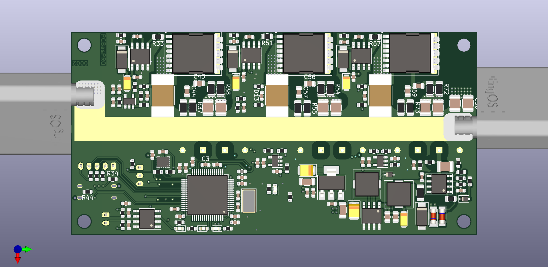

Hello guys,

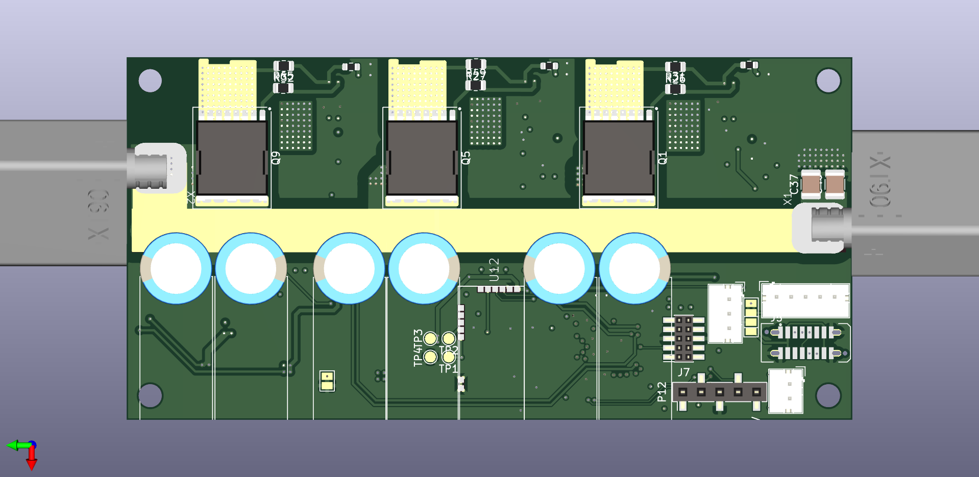

I’m starting a project based on price of GitHub - nordstream3/FOC. But for 100V/200A and with 1,5mm clearance 100V (IPC-2221B, table 6-1, 51-100V on B3). I made some placement study and is possible to feet in 100x100mm 2 PCB interconnected by CAN, and easybreak possible, see the status of half:
So what do you think about this idea?
For more details see:
Thanks for the support.

I think we’re all looking forward to the results of your prototype testing. Do you have a test plan document you can share?
Thanks on the replay.
No I don’t have any on the moment. But I will collect data from datasheets for that. Do you have any started that you can share?
Sorry, none that I can share.
