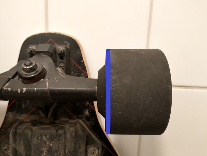

Ok short thing no you cannot just lock the “rotor” of this hub motor (the part where the wheel is mounted) because truck side, where you mount it, is fixed with the “stator” (the part where you have all the copper windings inside) and the cables ; lock the wheel and let the axle go free and you’ll rip the cables in one single spin and maybe do more damage.
Do you have a 3d printer and a bearing able to fit the hole road side? Or a machine CNC shop? Or are you simply able to make a Friction drive setup?
If not, I’d suggest you steer away from the conversion :clinking_glasses:

this… yes got them, was thinking shaveing of same thickness on rubber whel as this sprocket whit 60mm hole ofc and add 5 hole pattern… add everything back again and screw it tight…

what u r asking here is basically turning a hub motor into a outrunner motor that has a shaft sticking out so u can mount pulley on to it.
i don’t think anyone has attempted that before, at best was carvon drive, which turn hub motor into direct drive, but that’s a lot of work to put into it, and result isn’t guaranteed it will work nicely.
this was a stupid design which iwonder came out to hype up people buying the cloudwheels, as the red piece u see does not actually have axle, the bolt that was used to pretend to be the wheel axle is only held on by the 5 or 6 screws that the red adapter piece screw into the side of the hub motor, it doesn’t transfer the torque from the hub motor to the cloudwheel, it just extends it. not an ideal design to mimic if u r trying to mod ur hub motor.

i will take this add 60mm hole + 5 holes for screws Blue Paint is sprocket

R u trying to use the hub motors as a regular outrunner motor and then attach a chain to it? Which hub motors to begin with dont have torque and so that really wouldnt improve anything.
Cloud wheels are just wheels. Use a sleeve if you want to use them on these hub motors.

what u r doing here is basically turning the hub motor into an outrunner motor just without the shaft sticking out, ask anyone if they think the same thing
