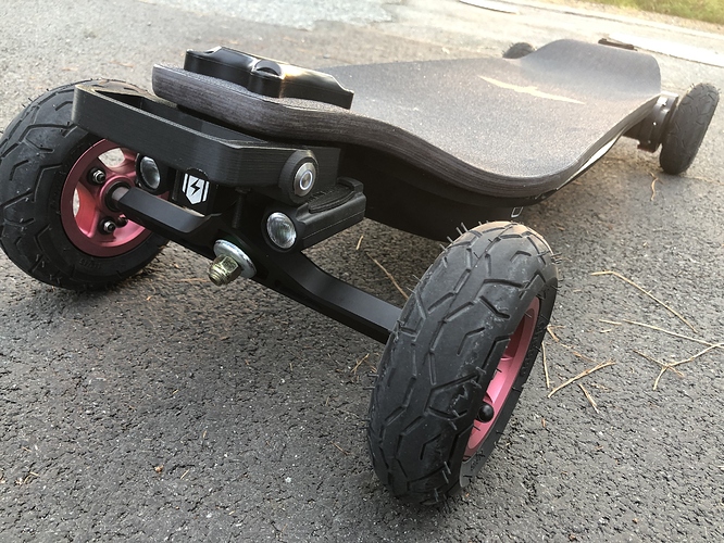

I recently became part of the no-thane club. Im not against it but all my builds no longer are thane. One evo on berg-surfrods, one evo bergs servisas gear drive and the last evo is going to be offroad dickyho… im also thinking of doing one more with 8in tires. I agree with the 36” sentiment. Not great for us bigger boys
I have a trampaline orrsom which is running avio gears and haggys that will shortly be removed and re purposed for another Evo or sub century on bergs.
Trampa is going small thane because its crap on numies. (imo ofc) I keep binding my feet on the wheels. I have big feet.

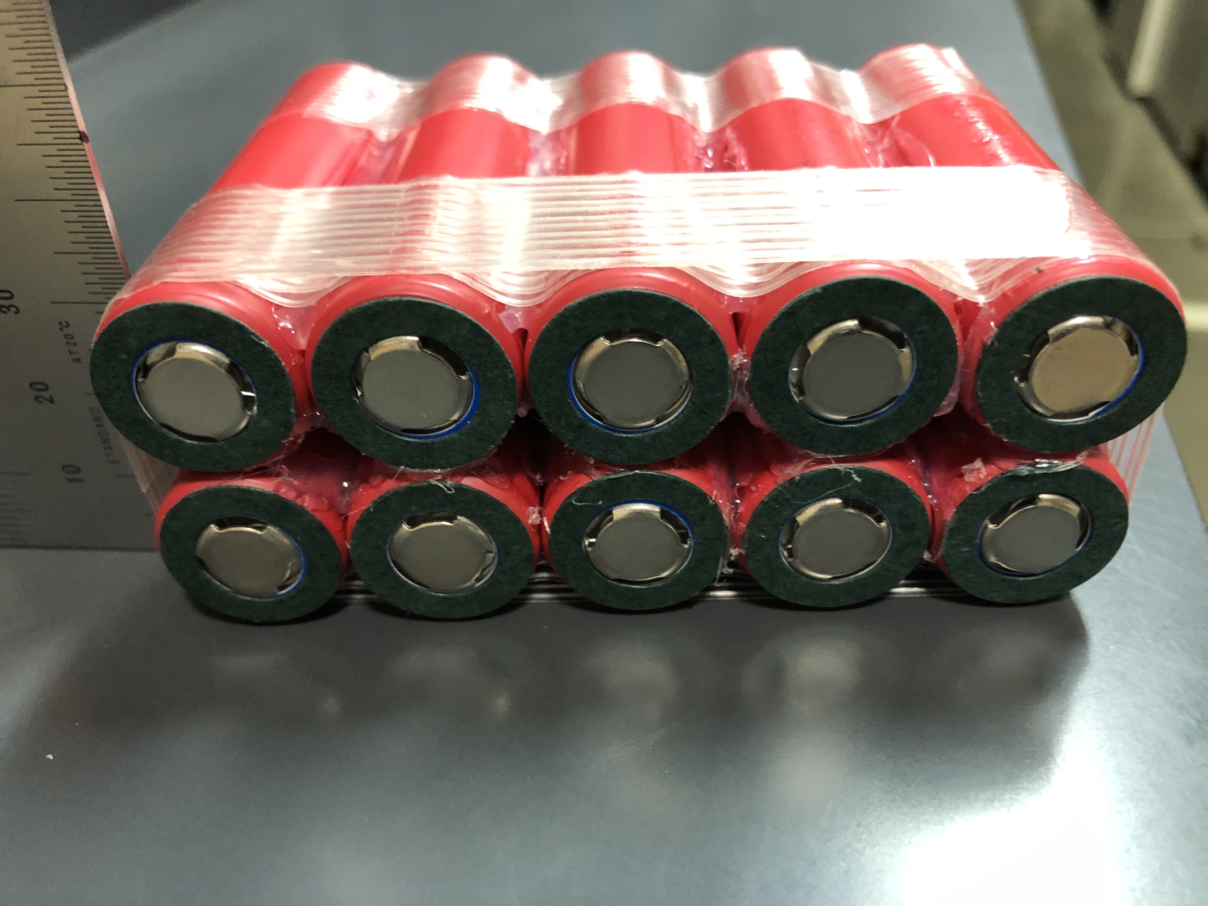

BERGMEISTER and Sanyo 18650GA 12s10p run very comfortably over long distances.
Recommended combination as everyone says.
How did you fit that in the enclosure?? :o

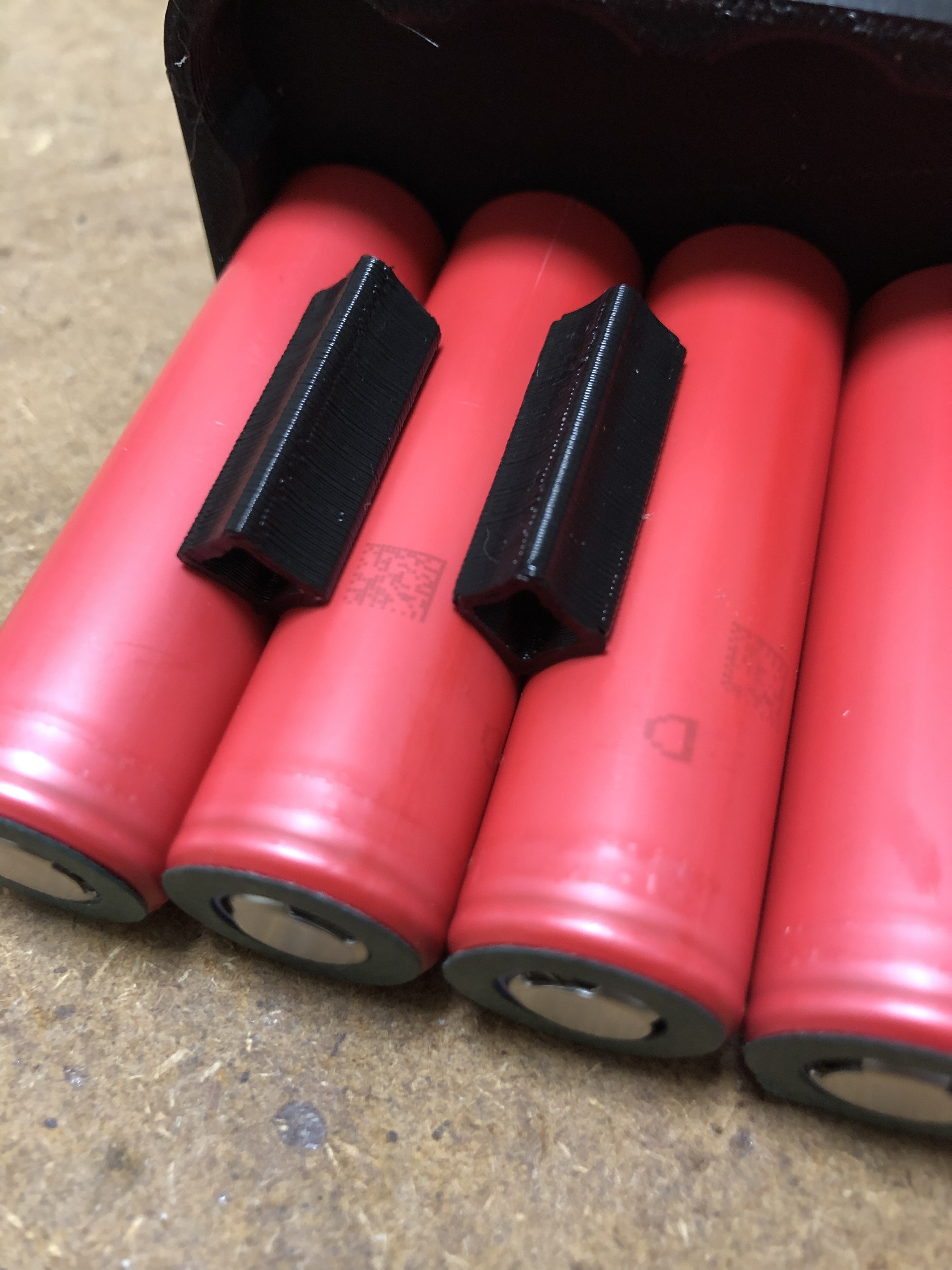

Put the 18650 in this way in the old eboosted EVO DS enclosure.
Now I recommend the new DS enclosure.
The new DS enclosure can place 21700 12s8p without any problems.
For old Shredlights.
You also need to extend the power button cable.
