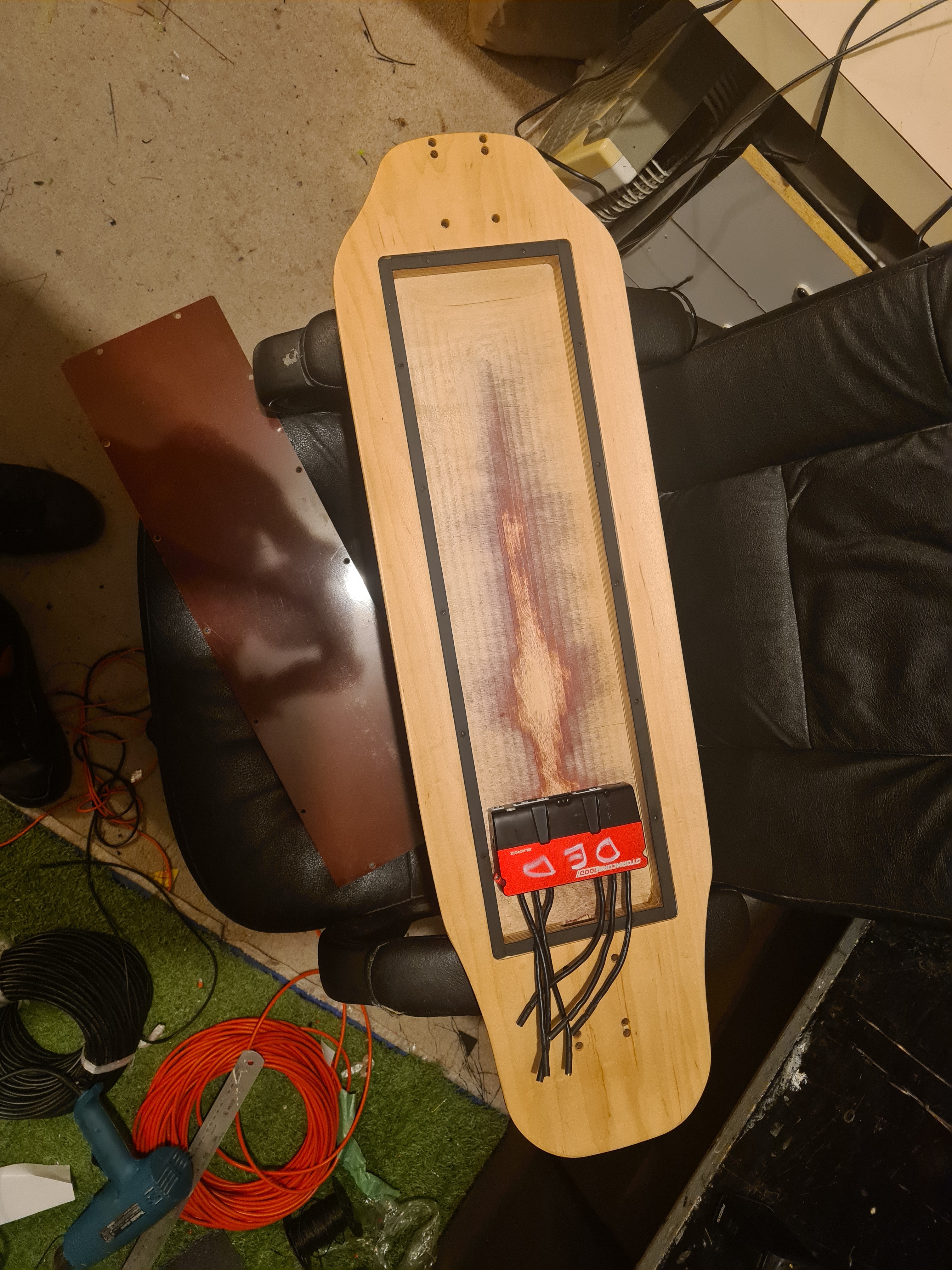

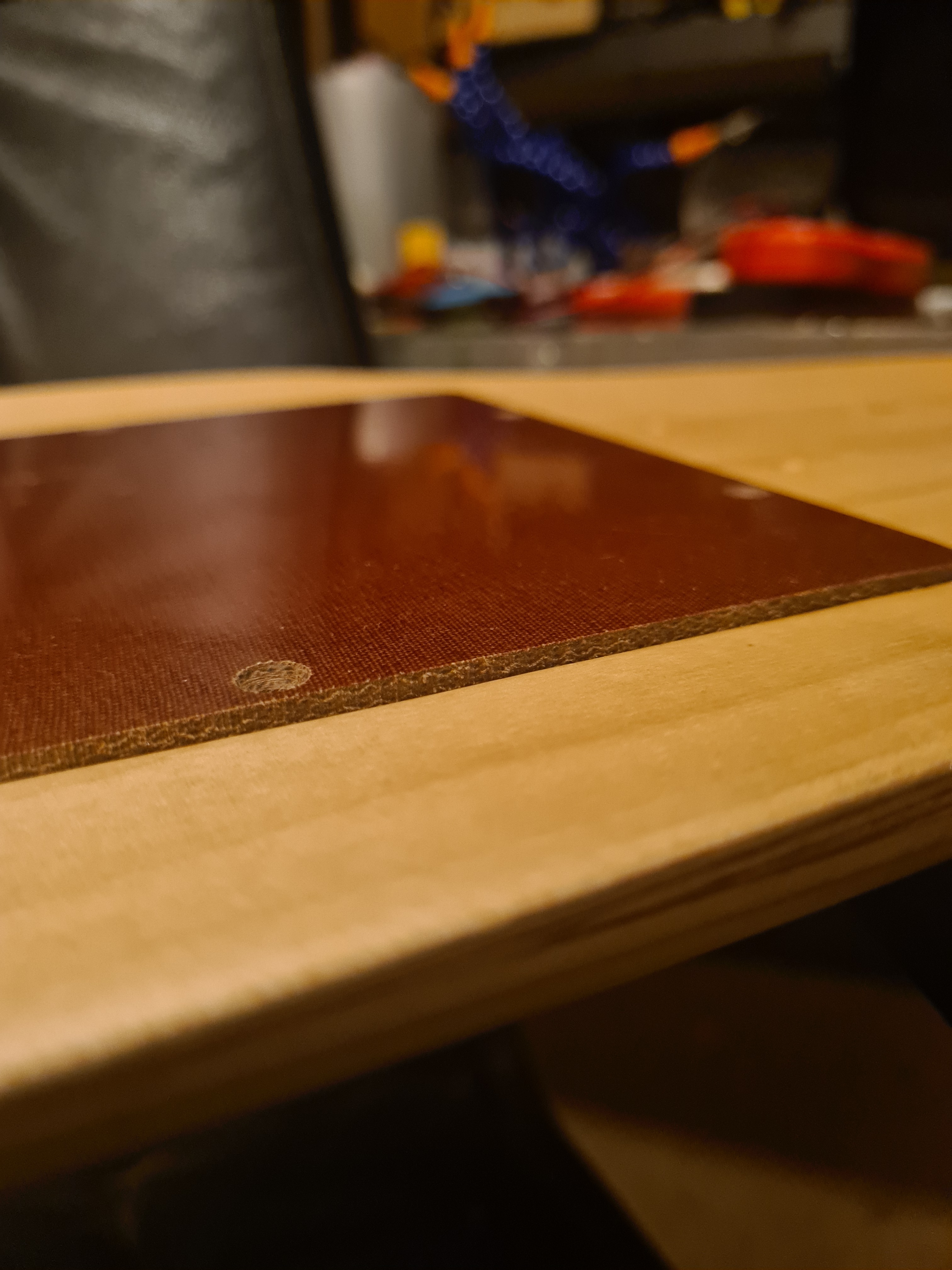

Working with a Luk-E deck with kicktail on hubs, wondering if anyone has managed to fit a stromcore d60 inside?/and how much one can widen the phase wire routing without risking integredy,
Running 1850x2W Hubs
Will start making this into a Journal as well for the build.
The Goal is to Build a Short Commuter that has 20-30km Range
Living in a Wet Country corrosion and humidity/salt water is something that can be encountered. to keep it clean Im going for an Intergrated Deck keeping components protected, and for the clean look to top it off rocking some powerful 1850W Hubs. Quiet and not noticable.

You won’t fit a stormcore in there without a lot of fuckery dude.
You can fit a unity or Xenith, but definitely not a stormcore because it’s thicc
It’s 3mm too tall
Yeah thinking of removing part of the stormcore heatsink.

Stormcore seems like overkill for a hub build.
Why not just go for a smaller, cheaper, more suitable v4 controller?

been still contemplating that hub build for 2 years now… i did notice i could remove the heatsinks on the stormcore and it should fit (the top heatsinks). considering the hubs are not so intensive the heat should still manage. a unity would work as well but i’d rather run a 3 phase controller.
