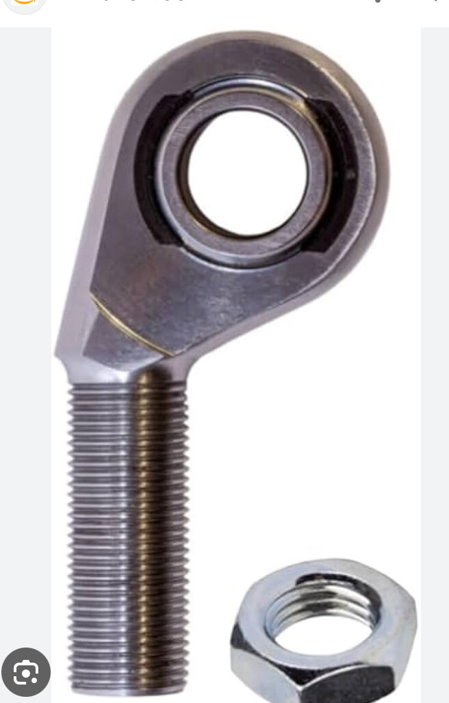

  1. the heim only allows so much turn.
  2. the rodends bind when not adjusted properly and actually give you less turn than what they are set for. So if you have your truck set at 45°. And the rod ends are not set properly. You might only be getting 43° When in full turn.

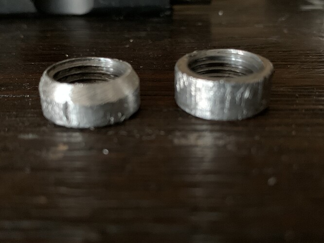

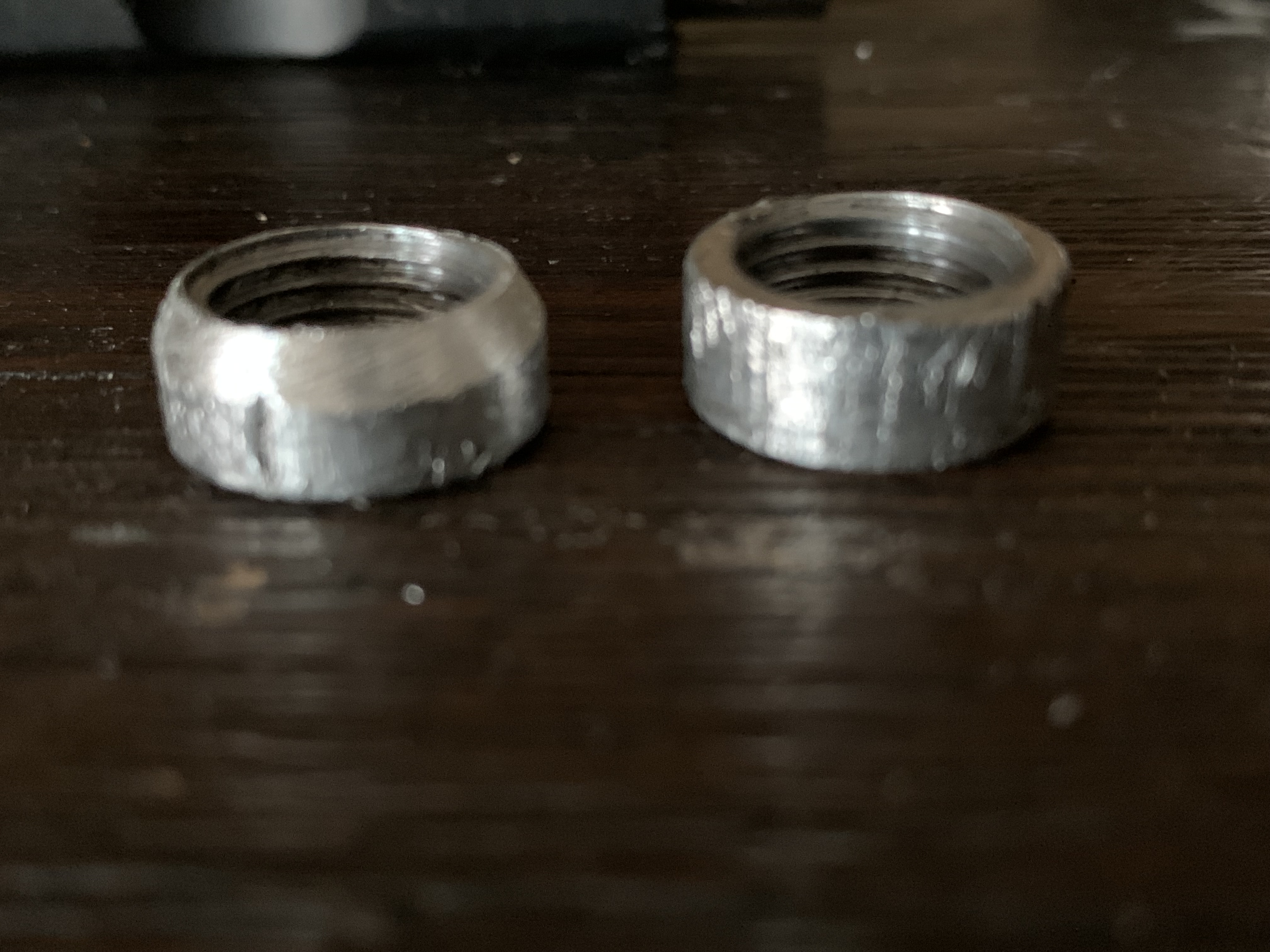

Second thing you can do is angle the axle locking nuts that keep your axle from moving side to side. The heim hole is 1/2”. The nut is .625. When you add an angle to the nut it gives you about 2 more degrees of lean.
Left is angled, right is stock.

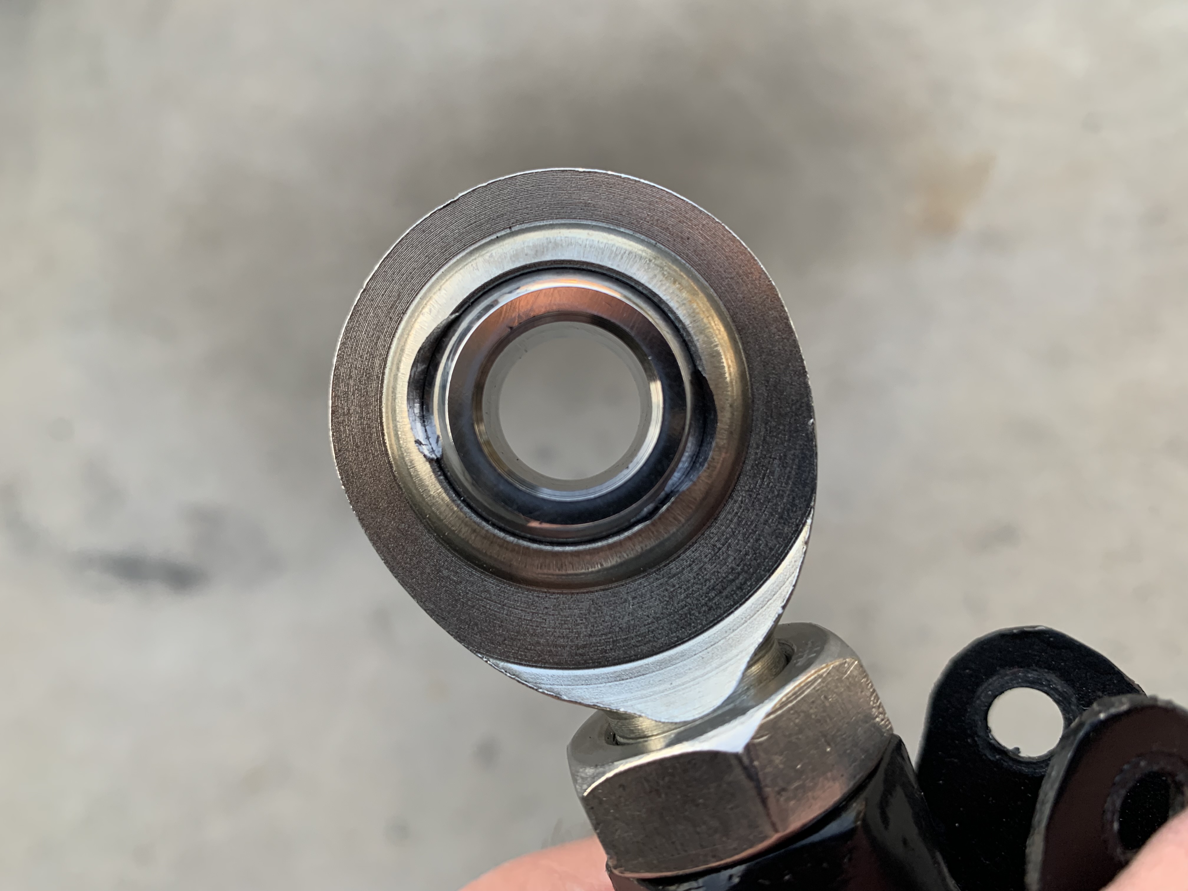

  1. then with the board in full lean mark the heim housing with a marker where the axle touches the heim housing. Then do the same thing on the other side.
  2. remove the axle, use a drill gun and a 1/2” drill. Insert the drill through The half inch bearing hole. Turn on the drill and angle it to cut about 1/16 off of the heim housing where you marked it.

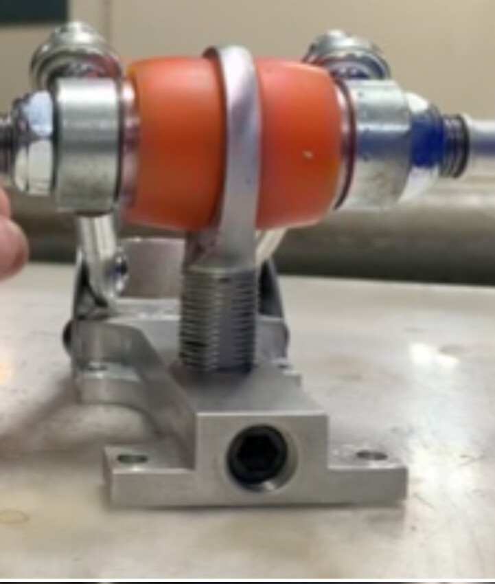

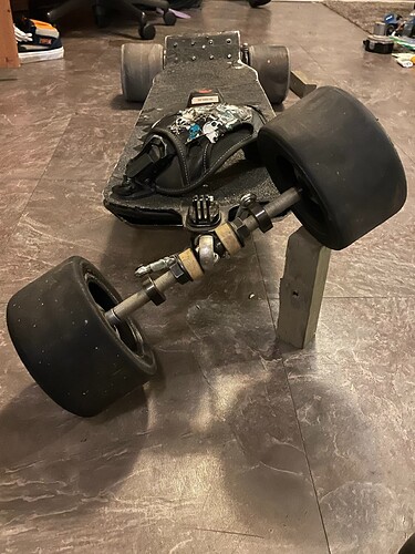

On old three link base plates with a single 5/8 hole. You can use an offset heim. Then switch out from short rod to long rod Just by turning the Heim around.
IMG_4710

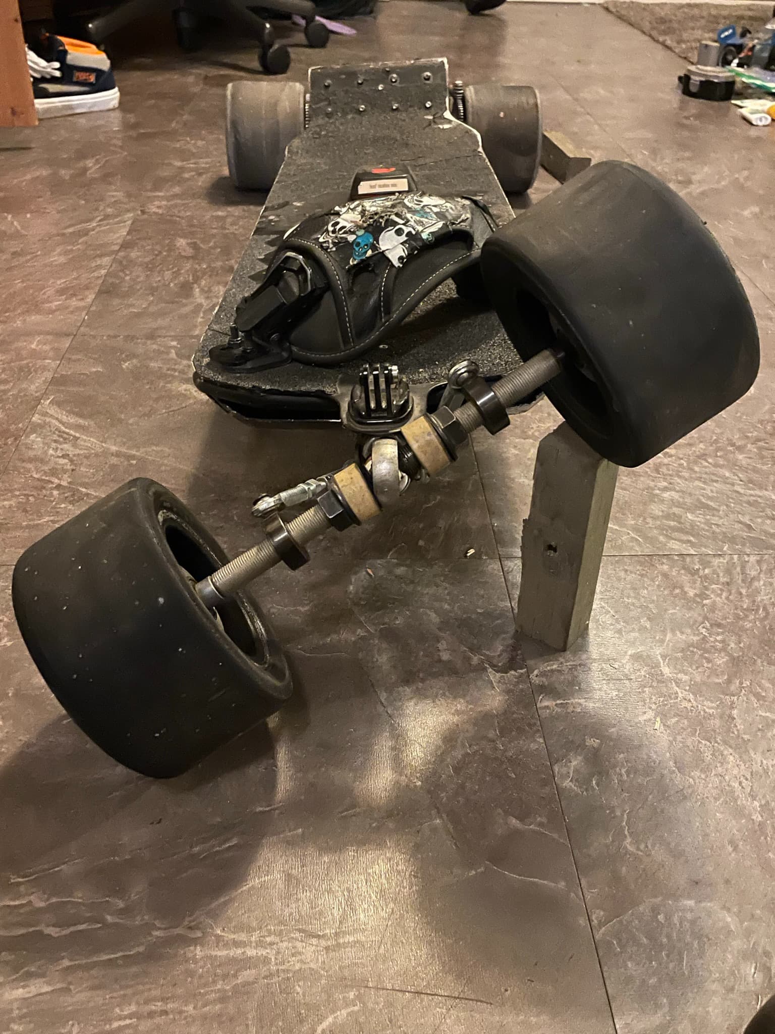

I suspect this isn’t the datapoint you think it is. Esellita in this shot is recovering from fully falling over. She’s on both pucks most of her weigh is off the board. She’s an extreemely light rider. I don’t know if they had produced the new lighter bushings yet for this race. It’s very probable that the only thing preventing articulation in this shot is the bushing stiffness with no weight on them.
But still the problem you found with the collars was real. and is real for anyone still using them. Which is why SRB addressed it in later versions.
Fess
The picture is there to show that the wheel is coming off the ground in full lean. That’s it.
I understand you say that he has modified or revised the newer axles by welding them. But I have never seen a post made by him explaining how to fix any of the older stuff that is out there.
That is what this post it about.
Anybody that has three links that is having an issue and or wants more turn. This is what I did to improve what I have.

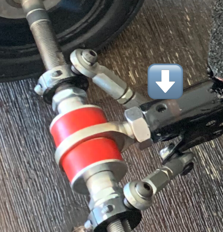

The new billet collars have sorted the issues with rod binding in the rear or the need to be particular with adjustment I should say.

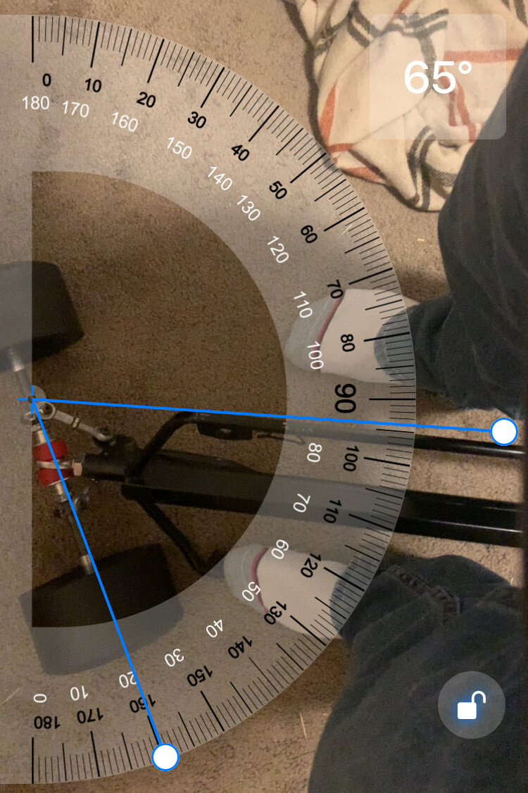

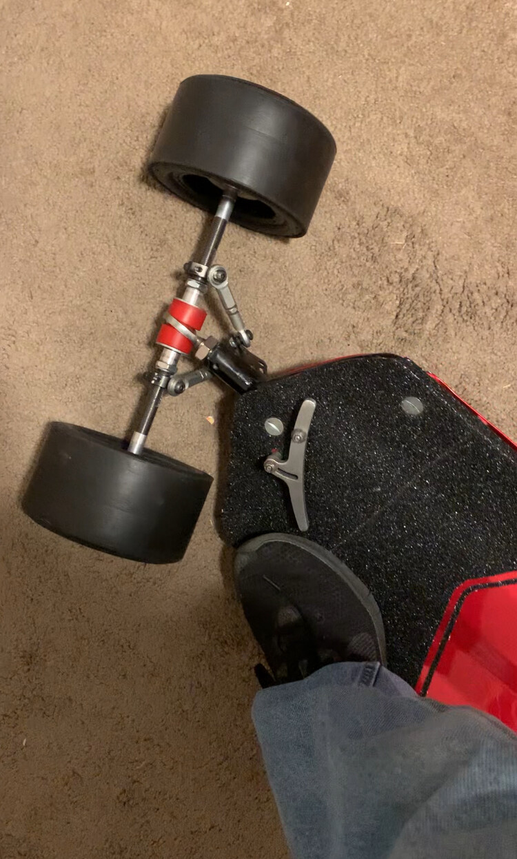

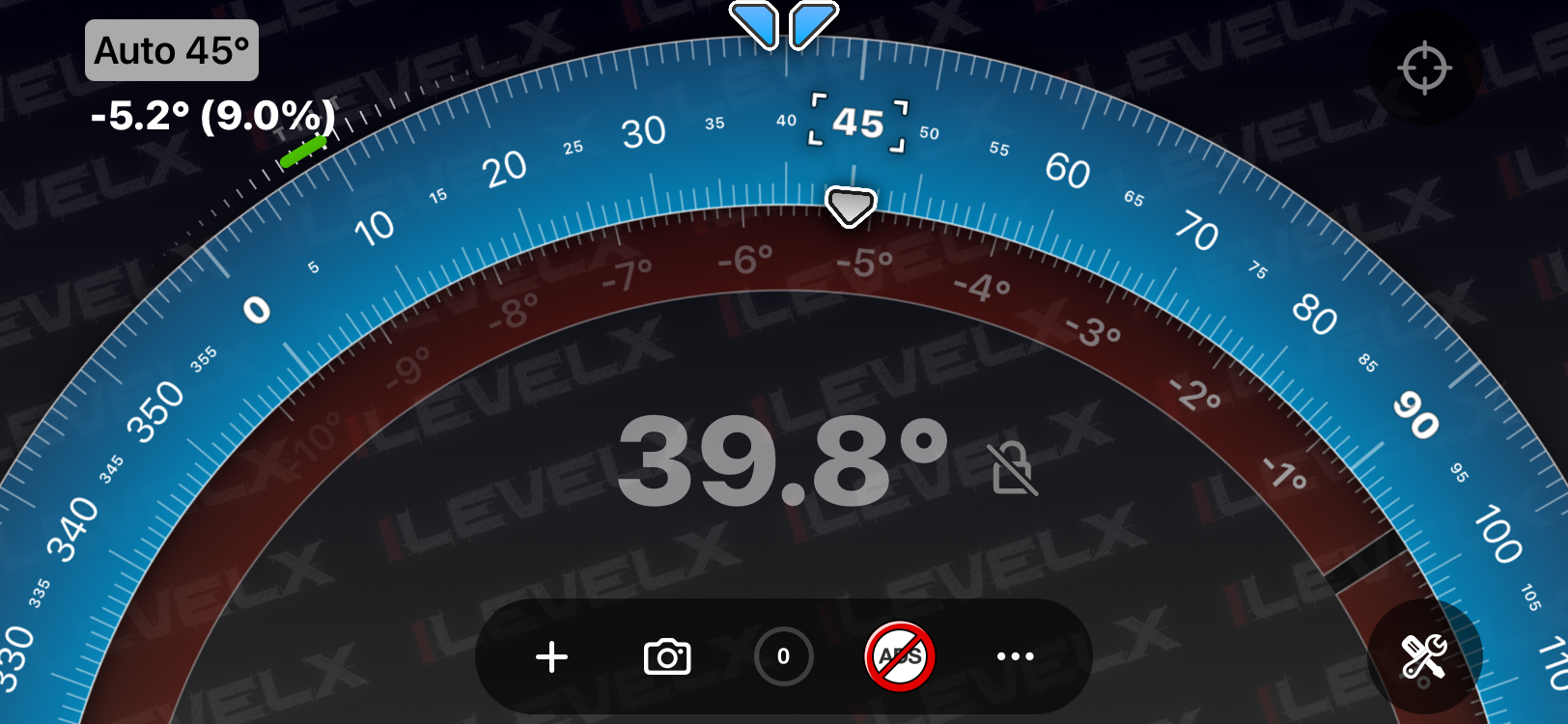

Can you post a picture of your SRB V5 for comparison to show the difference in full lean that I get?

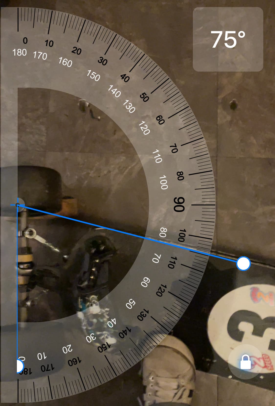

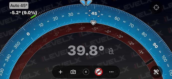

I used a protractor app.
It shows I get 65° of axle turn at full lean on 45° angled rodend.
And 39.8 degs of deck lean

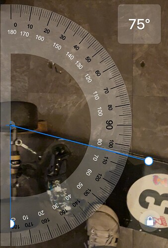

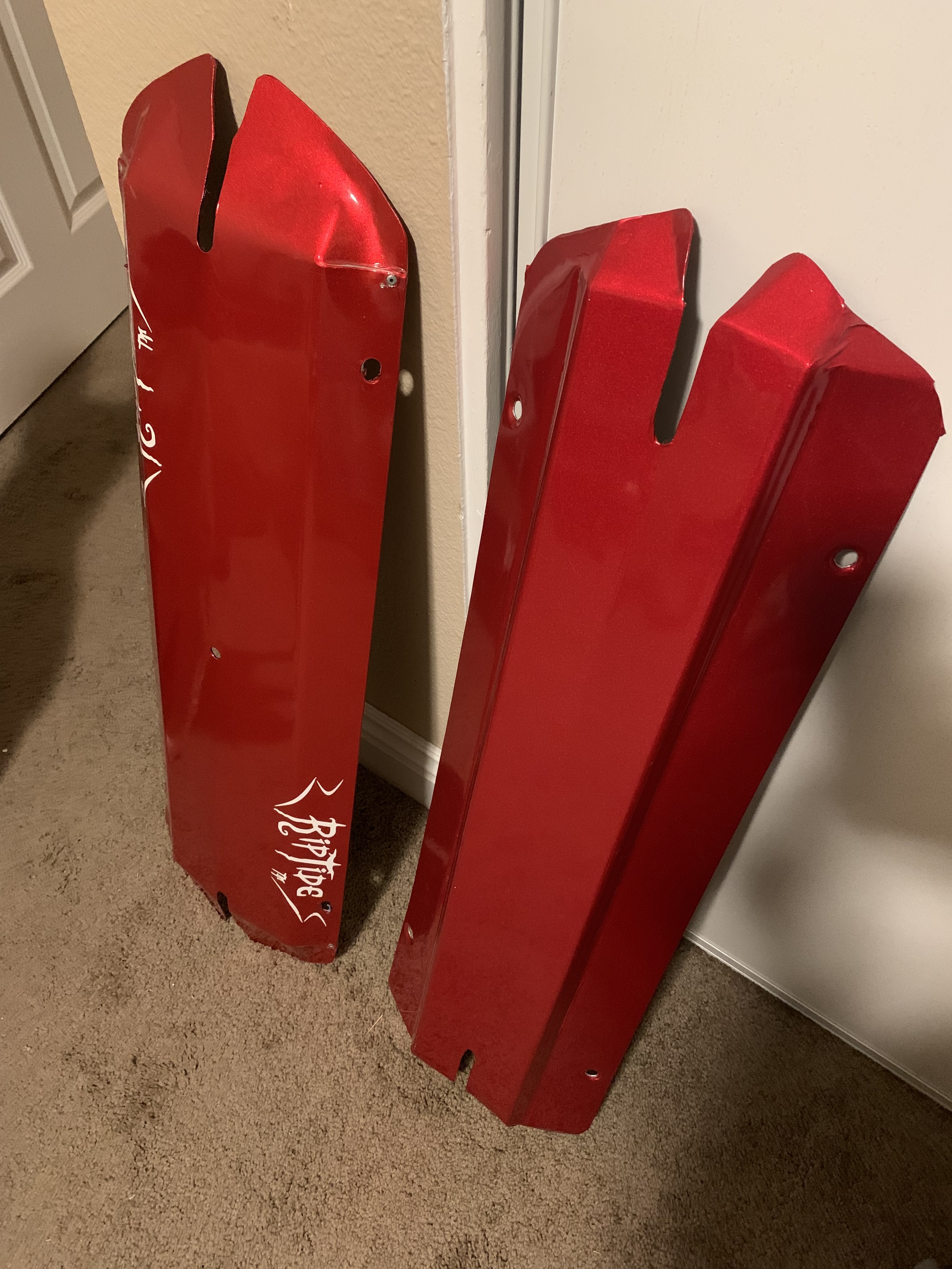

Did you modify your enclosure for more clearance?
I have 2 enclosures. The stock one, and a deeper one for larger batteries
The stock one doesn’t hit the ground with your modifications?
You’re getting more lean and steer than me.
my Enclosure hits the ground at 75° with 24° deck lean.
not sure how accurate my measurements are tho. varies quite a bit as you try to lock things in.
my radius rods appear to be somewhere between 35° to 40° from the ground. that’s also hard to measure. but it sounds like it’s less than your 45° so the protractor differences are probably not a good comparision.

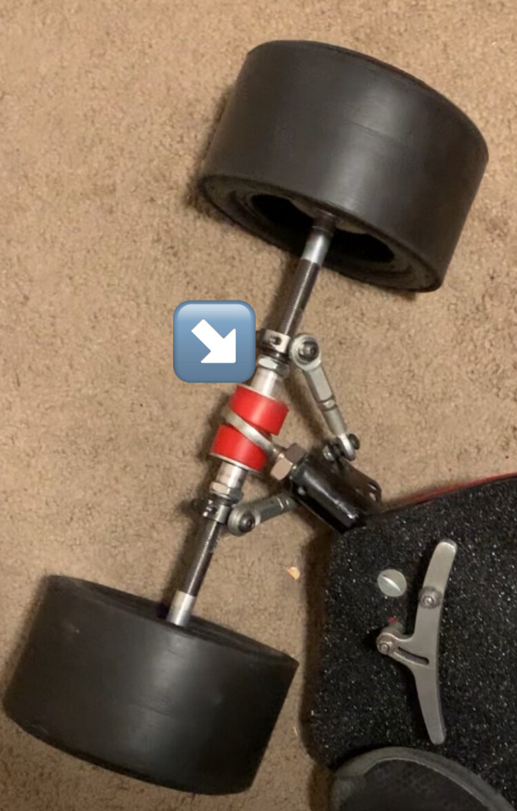

Full articulation on my axle ends up with my wheel almost above the deck. and the thing it binds on is the axle hitting the case of the heim.

Sure, I loosened them up to show the full articulation on the peice of wood without having to stand on it and hit the ground. with them tight I can still hit the ground.
your bushings are softer than mine but that also shouldn’t matter.
Softer bushings or looser bushings shouldn’t have anything to do with what the max articulation constrained by the collars is and which is what i understand your technique of beveling the collars to be about.

The stock enclosure I have is stock. I can put it on my stock v5 frame and see if the pan hits.
But really. The mods I did really just add more axle turn without binding. In reality. A 45 deg radius rod should give 45 deg lean. But because the rods now travel past centerline I get 45/45 up to centerline. But past centerline I get more turn and less lean on full lean. It is strange And goes against the functionality of normal trucks. But three links are not normal. And don’t really fall under the same category.
As far as my modified frame. Goes… I added w concave and moved the top of the deck up 1/2”. But the bottom pan is stock. I had to add 1/2 spacers to the W frame so the stock pan would fit in the stock location.
