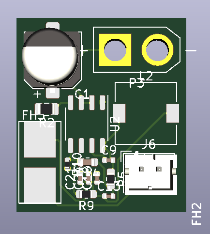

The 3 designs are far more unified, with more uniform component choices, such as caps. You can see on the left a new couple of pads labelled FH1. This is for the new fuse holder. Instead of direct board mount fuses, I found a small fuse holder.
Screenshot_2020-06-23 1809191943_Littelfuse-01550900M_C108518 pdf
They don’t look that tiny, but this is the smallest fuse holder in LSCS’s extensive library of products. 9.73x5.03mm. And the fuses are user replaceable, and also support up to 125V if you wish to make your own VPU with a higher output or for other devices too. Very cool.
Boards currently measure around ~20x35mm. Trying to maximise space to get it lower. Almost definitely will be going down to XT30 I think.
PS: XT30 upgrade done, takes 3.5mm height off the board without changing anything else. And I can totally work on optimising further.

20mm x 23mm With XT30 I don’t think that it can get much smaller. I also expect more people to power only a single device with these boards, so went down to 1 output. More devices can be paralleled onto the single output, unless y’all have another connector I could use that would take up less space?
I still need to make sure that current carrying traces are thick enough, and that the silkscreen references are actually in position.

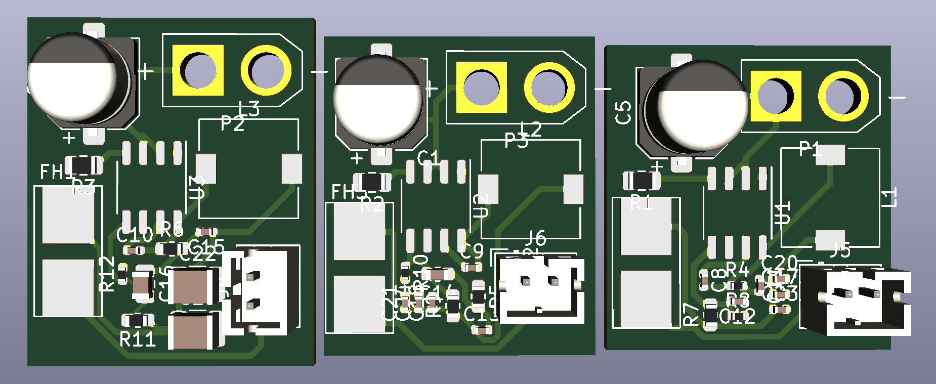

From left to right is 12v, 5v and 3.3v. All boards have now been shrunk, with the 12v being the largest at ~26mmx21mm. Just need to finish the silkscreen, and then I would consider about as finished as the first units are going to get. Still waiting for Kevin’s parcel, shipping from China to Australia is fucked right now, still waiting for a pair of shoes that I ordered towards the end of May.
Very tidy unit indeed. I will buy some off you.
Good to hear mate. It’s a slow process for my first time but I hope that once I’ve got the hang of it and shipping is better then I can start to focus on designing more modules, as that is the plan for this.
You need the exposed ground pad for the buck regulator chip.
Or is in the PCB design, just not in the preview?
You’re right, I have completely forgotten about that. Will add
