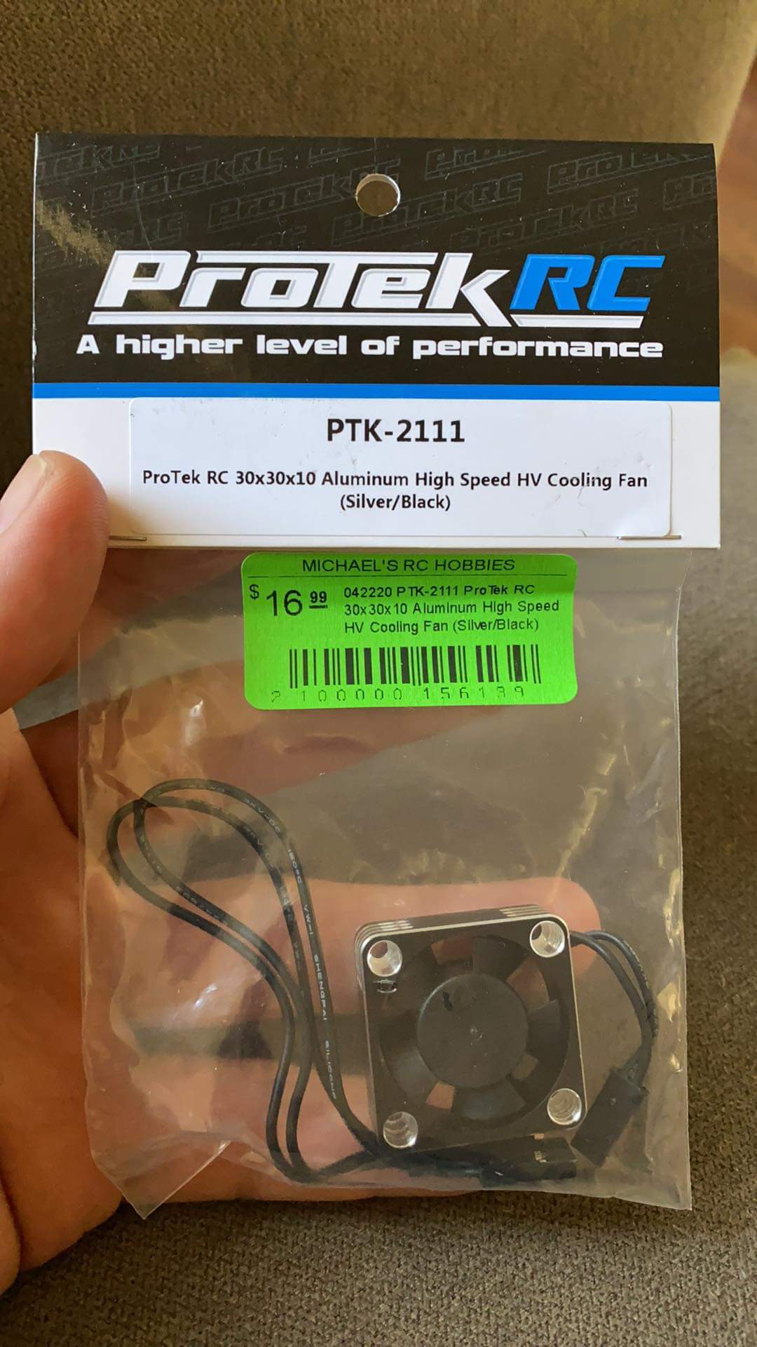

Oh damn that would scream, 450ma draw. Would be perfect for my board, just under the spec with 2 of them on 5v
Product Model High Speed HV Cooling Fan
Application 1/12 - 1/8 Motor & ESC
Fan Speed 28,000 RPM
Dimensions (LxWxH) 31x31x10.5mm
Mounting Pattern 24x24mm
Material Aluminum Case w/Plastic Fan
Weight 12.5g
Operation Voltage 5V - 8.75V
Connector 2 Pin JST
Current 0.45A
