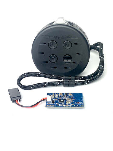

What remote? If you don’t know the name, post a photo of it.
Maytech MTSKR 1712
Oh yeah the Maytech remotes are notorious for this stuff. Its the remote/receiver, not your ESC. Buying something better is your best bet

That remote shouldn’t be an issue. Did you set your center point and mapping correctly? Also check for debris or loose connections with the receiver.
how to define its central point and its cartography
Re-do throttle mapping
