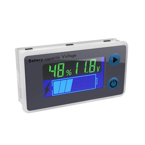

Use one of these in the board, it will beep really loud when it falls under a programmable voltage, plus a couple of other things
