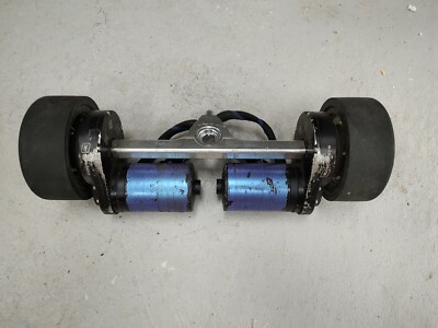

anybody got a set of @3DServisas FatBoys that work for street wheel setup?
(preferably the widest mm-axle you have the better, its for cruise-stabiltiy reasons)
If anyone can think of any other brand of trucks that would work, LMK!
The only stipulation is that it will work with gear drives,
is fine for street wheel setups & preferably is closer to 12”
(Anything less than that is too small for my personal build)
I was trying to see what they looked like. And saw these.
Are they just regular RKP trucks?
boardnamics 270 may be similar.

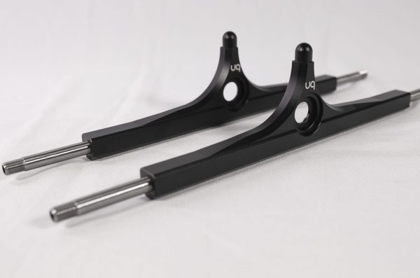

You should really consider Tito’s Duality trucks dude.
I think most of the vintage stuff you are looking for is cool.
But these trucks are so much better than RKP…
im not counting them out, trust,
but that price tag is, well, pricey
im trying to justify that cost for’em
Worth every penny…
I am not sure any street gears would fit Dualitys though…
You can certainly match up BN M1 with the BN 270

you selling those savage trucks?
how long are they (from end-to-end)
3ds trucks are obsolete from an era when people didn’t know better. Rakeless hangers with very restricted bushing seats… So they don’t turn. But don’t confuse lack of turning with stability. They are still sloppy because standard RKP geometry doesn’t fully constrain the hanger, thus they aren’t stable either. And their adjustable baseplate also sucks, the set angle gets loose all the time and causes even more slop. The wider the hanger the more leverage road imperfections have and the more slop there is in feel, hence why all downhillers run narrow trucks with better geometries. I have a set of 3ds 275s with their old POM drives installed on them that I don’t ride.
Dualities turn multiple times better yet still manage to be multiple times more stable regardless of width due to their second pivot fully constraining their motion.
TLDR @TheLostRider get Dualitys bro…
