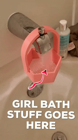

I’m selling stupid bubble bath products, no judgment.
Don’t mind that ugly seam on the yellow one. Forgot to change the stupid z seam alignment
Good to know that girl bath stuff is doable. :joy:
