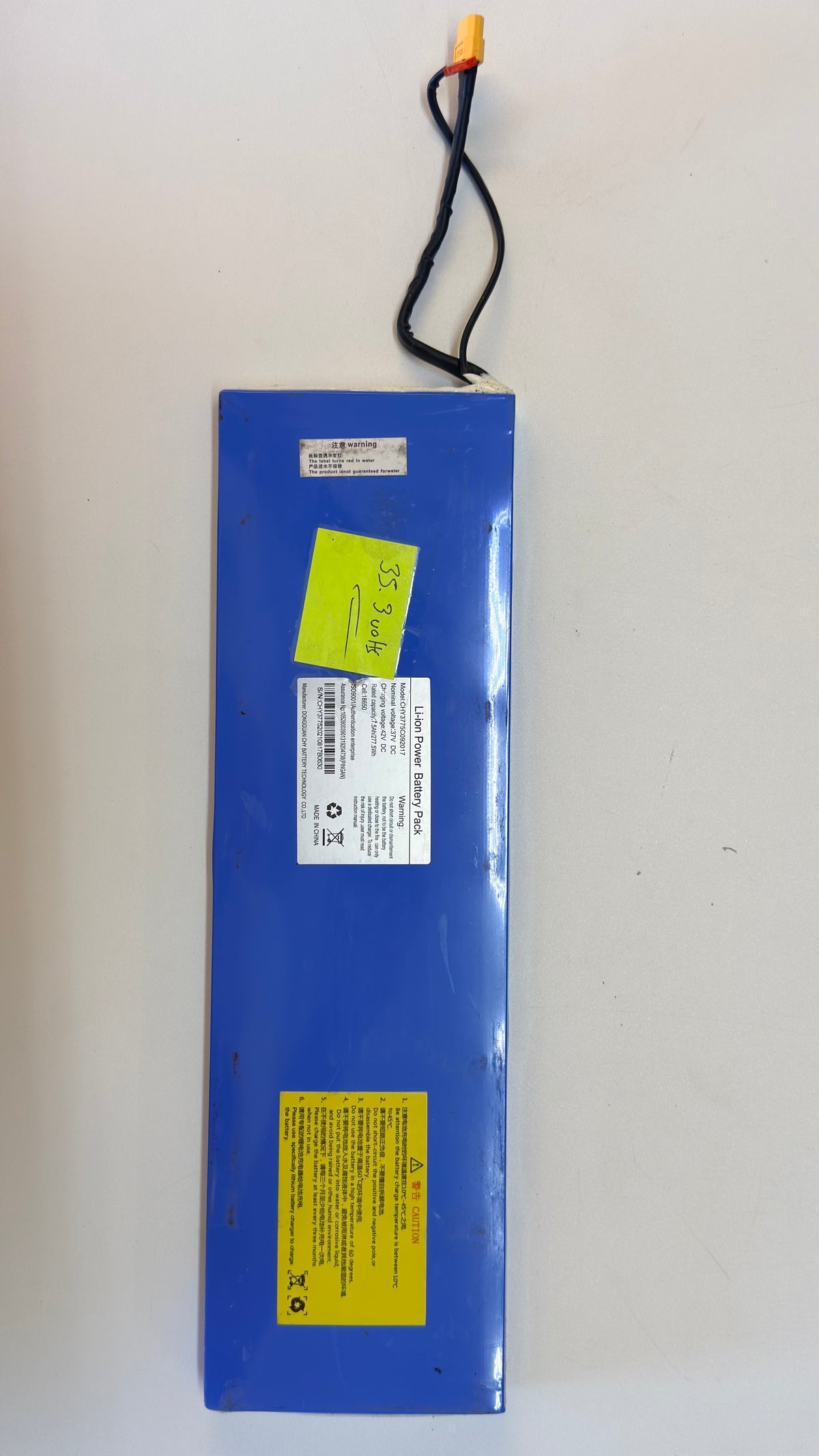

Hey all, new to forum and looking for a battery for my diy. My budget is about $350 plus shipping in the US. (I attached photos of the board)

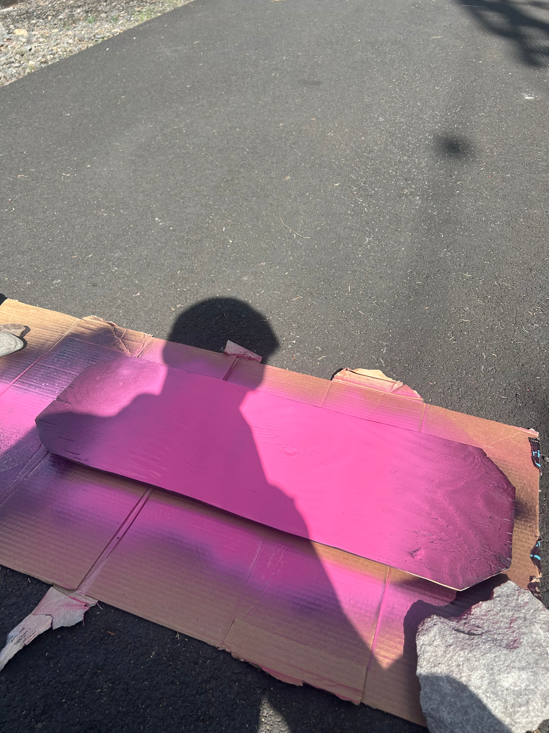

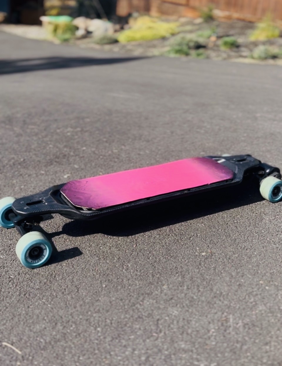

Did you make that lid yourself? I’m wondering because it looks like it might be raised at the front and back.
I bought one of these decks, or at least one that looks really similar, but mine didn’t come with a lid. I’m thinking about making one myself, but was worried about a slight incline at the front/back.

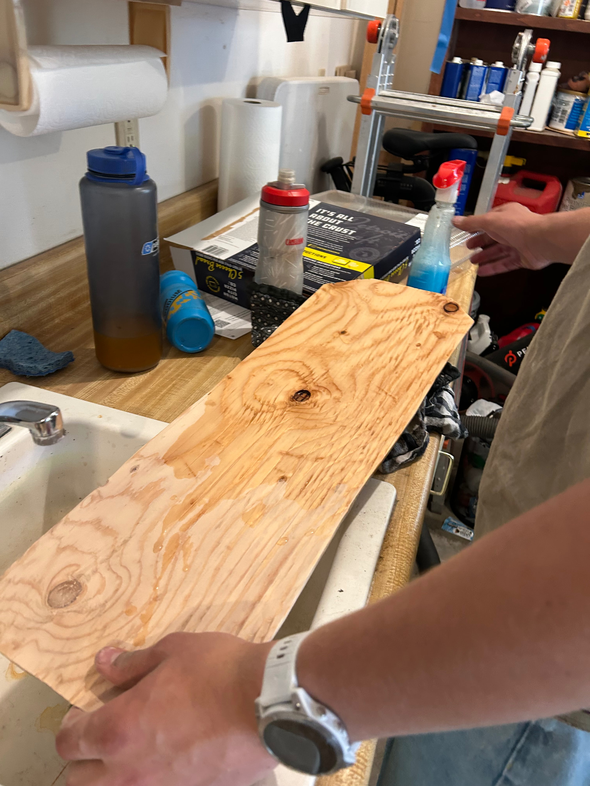

It’s a custom lid for a metro board deck that I bought of mboards. Me and my friend build it out of 3/4 in plywood then sanded it and painted it.
Oh, that’s awesome! I never would’ve thought to use wood.
I was thinking about using a sheet of G10 for mine. Do you have any tips for someone trying to make something similar?

Make sure to line the inside of the board with fish paper because it being carbon fiber it is conductive and can cause a fire if that battery were to vibrate enough to wear through the thin PVC wrap.
That battery seems like a cheap Chinese builder, also I don’t think it would have the range I would need to get to class and back. It’s pretty straight forward to make the top plate. Cut out the rough shape, then sand down the underside edge until you get the chamfer or edge you want. You can sand the top to paint it or just grip it.
That’s actually super helpful, thanks! Any fish paper you would recommend or just any generic? Also, anywhere I should look for a battery in my budget and specs?
Once you stand on the deck the bump goes down a substantial amount. I have weather proofing on the deck.
