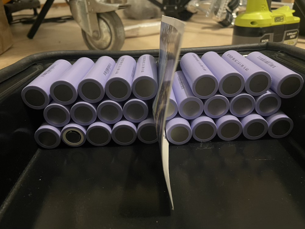

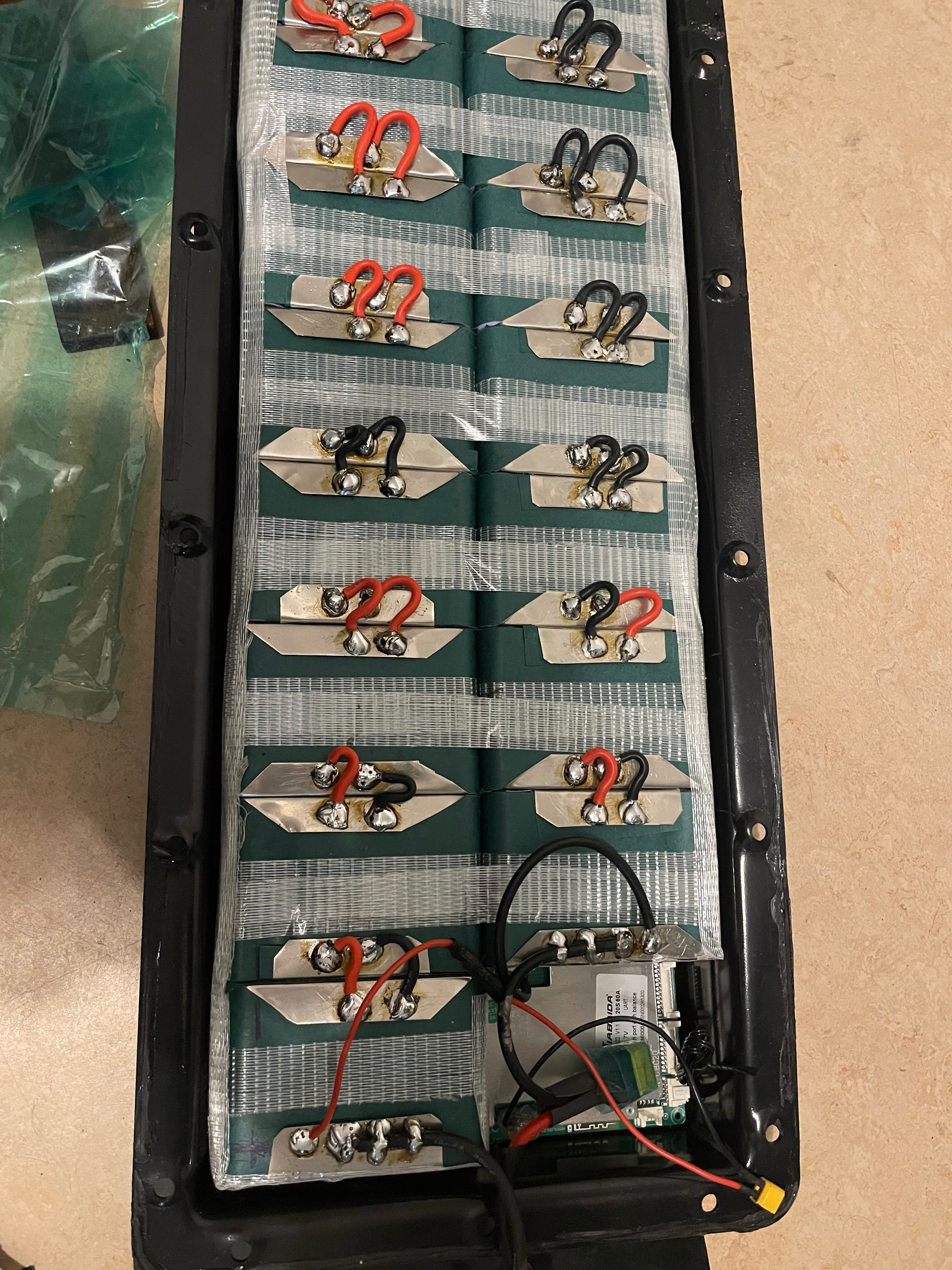

Hi, I have tomiboi Odachi V2 and wanted to built 18s14p battery what you think?
BAK N21700CGP 4000mah - 40A

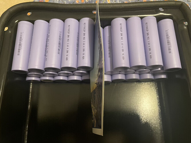

Looks like it doesn’t fit. The enclosure should be taller than the battery.
i will make thick gasket
Build up the sides with fiberglass and make it taller if you want it to be safe and waterproofable. Using the cells as a structural members, also in a way that makes waterproofing bound to fail, sounds like a bad idea.
I would do 10P using 5Ah cells. 50Ah in that setup vs 56Ah in a 14P 4Ah setup and much less fuckery involved. No need to make a thick gasket, lose ground clearance, etc
If those cells are free hell ya, but if you gotta go through all that trouble to make a thick gasket to make it work and haven’t got cells yet go with a lower grade 5000mah power cell for the lower p count to not have to fuck around with a super gasket. I get 60 hard miles or 100 soft miles from my 50s 18s8p doing between 25wh a mile and 35-40 wh a mile respectively.
My suggestion: If you must make a gasket make two - one from solid neoprene rubber- not the foam kind but the solid almost non compressible kind to make your gap filler and seal it with butyl to the deck - then just a regular gasket on the enclosure. It won’t be as good as extending the enclosure like @b264 suggested but is more accessible to those who can’t work composite for whatever reason.

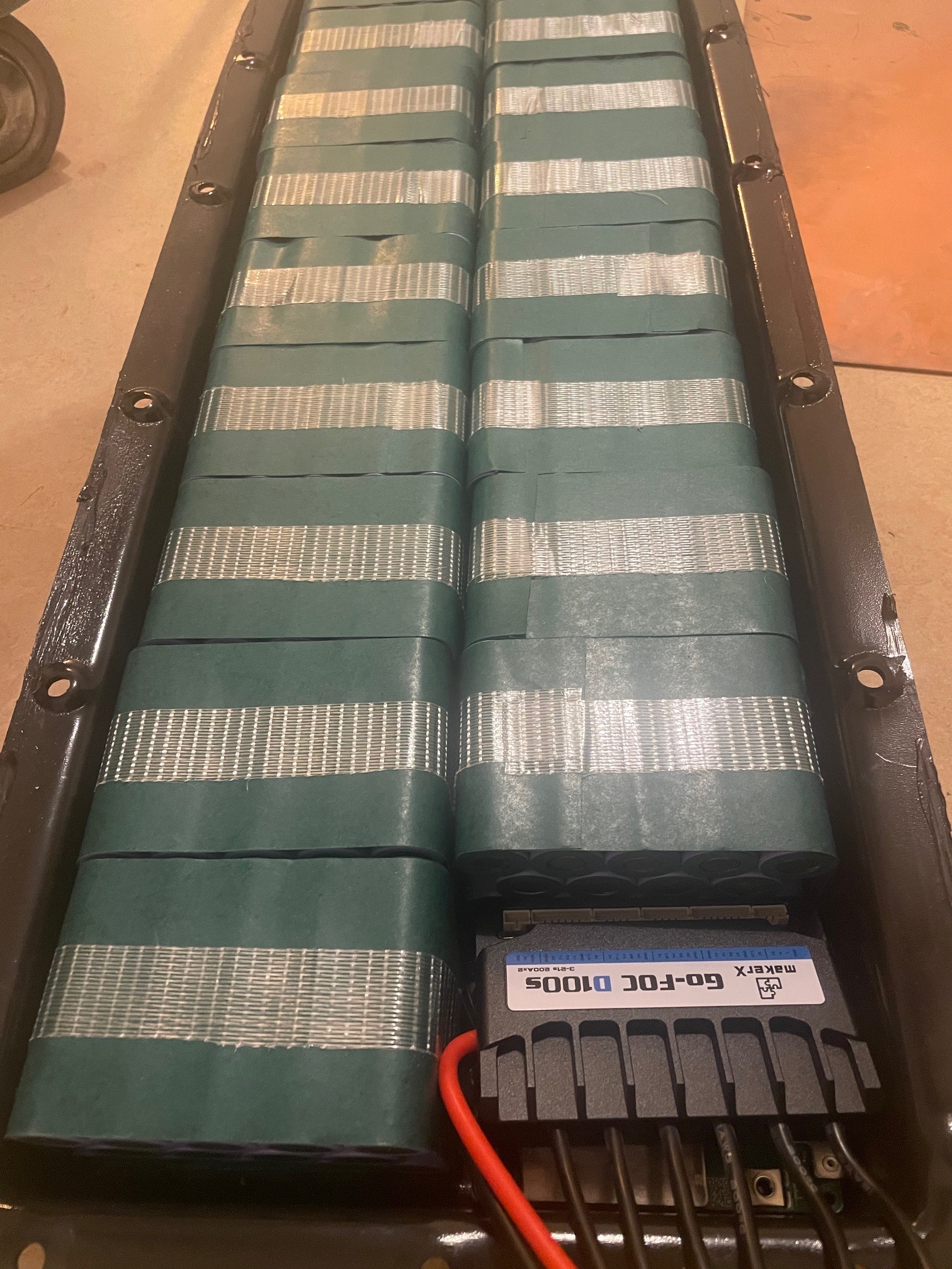

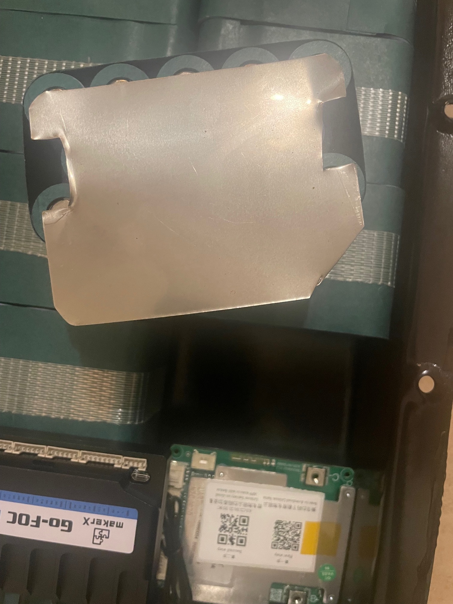

I considered filling the whole enclosure and going 18s also. Very interested to see your progress. You should make a build thread so we can follow along!
i decided go 17s and put vesc in enclosure without heat sink, here in summer weather seldom go over 35 celsius, I don’t know I will get heat problem.
Did you wind up using those 4ah BAK cells?
17s x 14p x 3.6v x 4ah= 3427 wH nominal.
16.66 KG/36.65 lbs of cells alone.

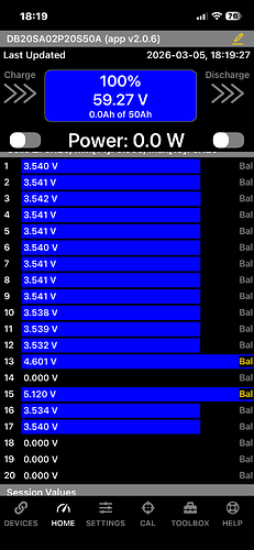

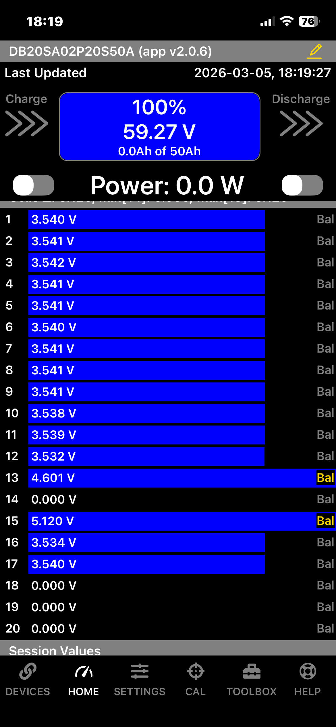

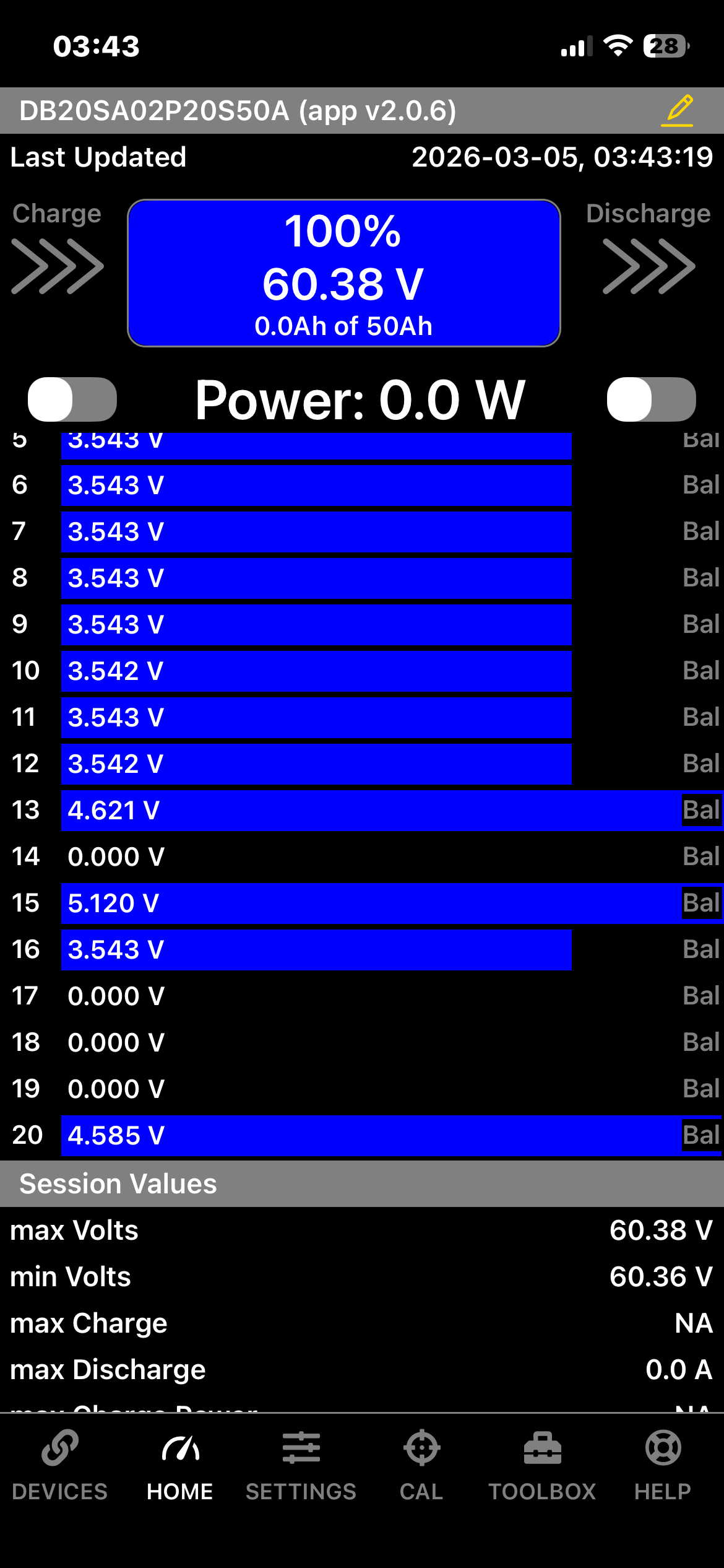

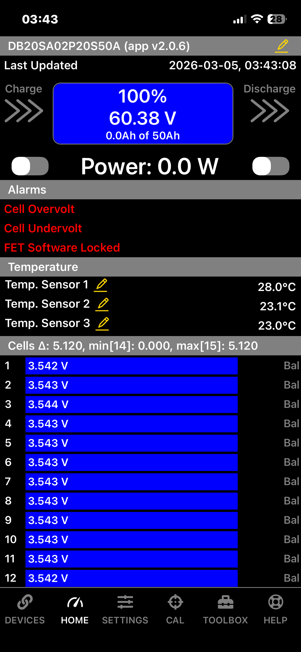

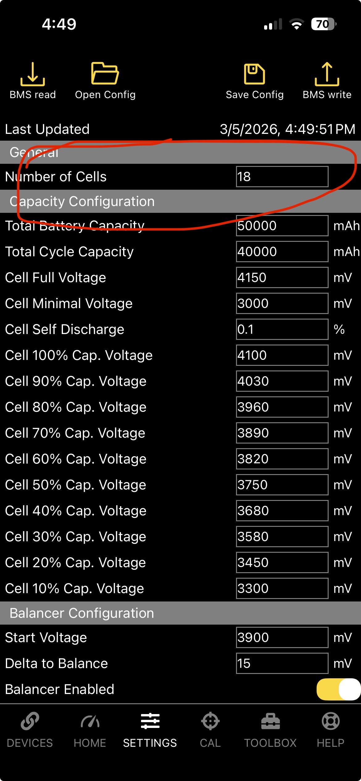

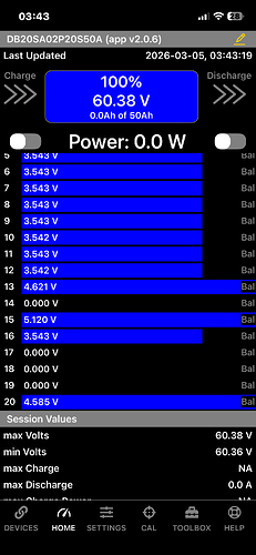

Connected BMS and it takes
charge

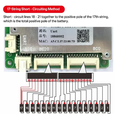

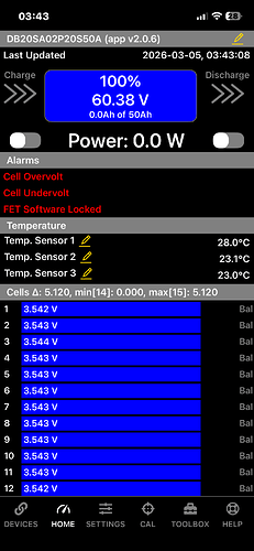

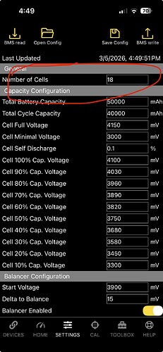

Need to do the jumpers on the bms? Seems like the balance wires are not all hooked up correctly
Is this the diagram you were working from? Careful leaving it hooked up like this as it could drain a group trying to balance because it’s not reading correctly
Also need to set cell count in the bms settings to 17
Yes thanks now is better but this 14 seems not maybe take it out.
Definitely double check the connections and don’t hot swap anything. The bms still showing 20s needs to be set in the settings correctly to 17
You’re almost there, just carefully double check all the balance leads with a multi meter and make sure they are connected to the battery like they are supposed to

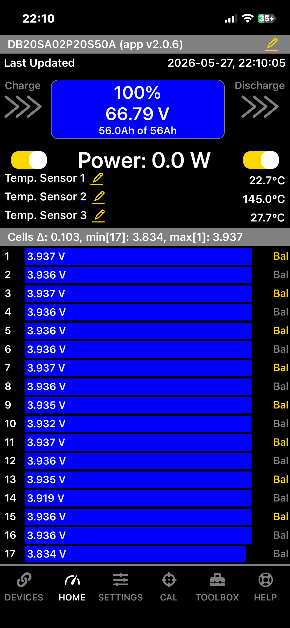

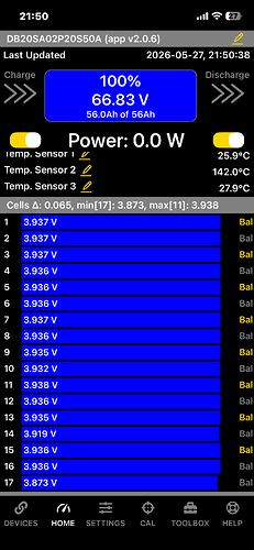

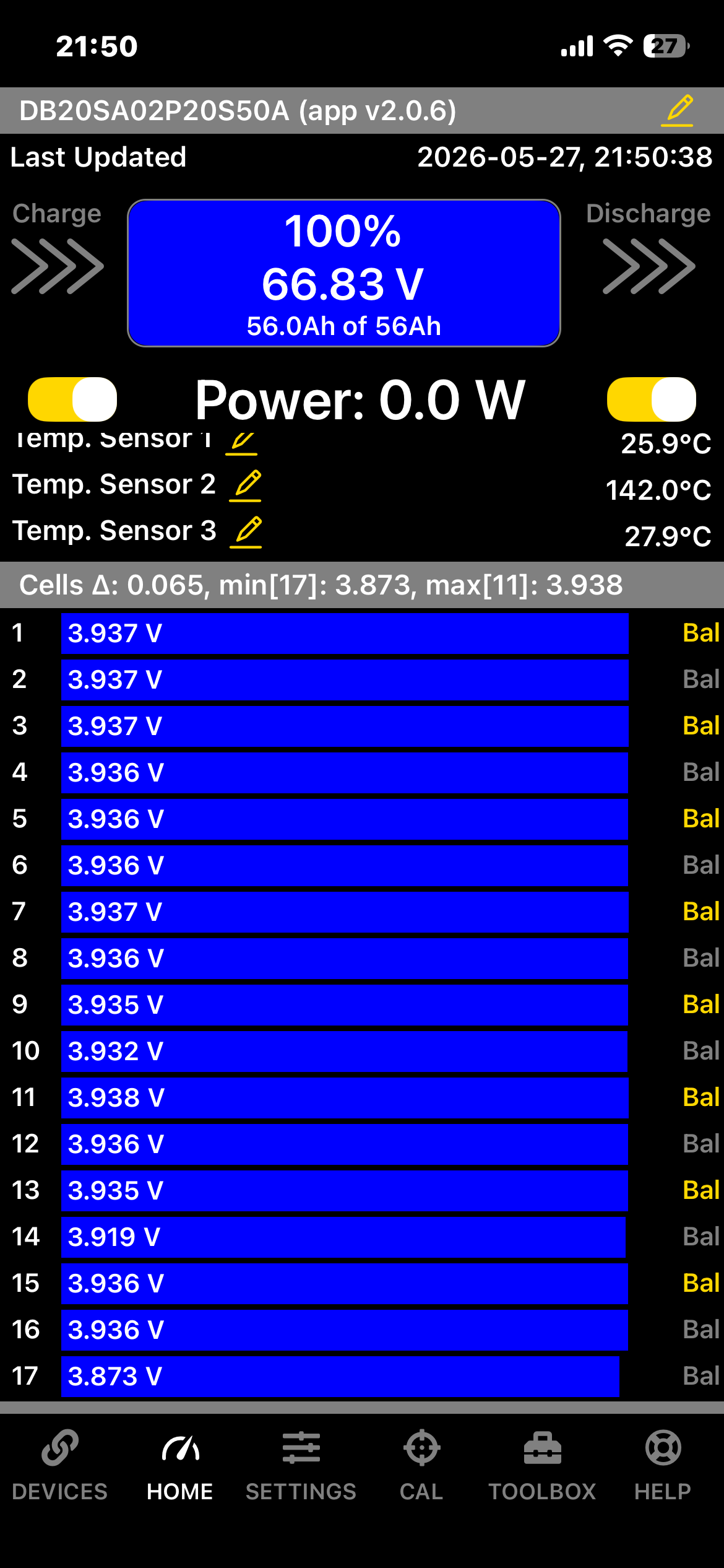

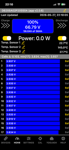

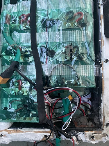

Hi it’s been 2 months i ride i do 100km range. Today i ride it under rain and when home i noticed remote is disconnected I tried several times its connected but i see one battery sensor heating up. I opened no water in and with infrared its ok. What to do
If it’s not actually overheating, Then it has something to do with that thermistor. Disconnect the bms from the battery. Figure out which one it is on the actual pack and check it’s placement and that it is undamaged and not on fire (lol). Swap the pinout of the two thermistors so Temp sensor 2 is on 3 and 3 is on 2.
Reconnect everything and check the readings, if the problem persists on temp sensor 2 then it is a bms issue and that bms likely needs replacing. If the problem switches to temp sensor 3 then the issue is the thermistors and you need to replace the thermistor.
Report back what you find. Might be moisture got to the bms - might be something else.
