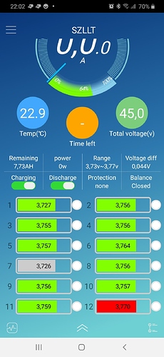

I have put the new BMS on my battery, this is my first time using a Smart BMS and before starting to charge it the battery was all balanced, but now after I started charging it there are two cells that aren’t balanced,I have my battery all wrapped up and I wanted to know if there is any way to balance it all again without opening the battery
I don’t have any picture of when I started charging it, but I have a few of when I noticed it and stop charging to see if with time it balanced itself again

0,05 Volt difference is in my opinion within the Tolerance, if it goes worse check the battery and replace them.
If it happens again check connection and reduce the Regen.
I also use that System, so im speaking from my experience.
Thaks a lot I was starting to get worried… :sweat_smile:
That doesn’t look too much out of balance.
If your cells drift more than 0.1V per p group I would start to have a closer look.
Not using the android version of this app, so maybe it just does highlight the lowest and the highest group in the pack.
If you worried you can also set the bms on static balancing. Means after you charged the pack the bms will start to drain the higher voltage groups to the level of the lowest voltage group.

go into the settings and uncheck “Balance only when charging” and it will start balancing itself. Be warned it will take a while. probably 3 days for that much, although I wouldn’t be worried about that little difference
As @Lee_Wright said.
I wouldn’t have it switched on all the time thou.
