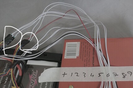

No. Put the extenders on the lipo balance connectors and then follow the wires in the order I mentioned. The color of the extender wires doesnt matter. They are random.
Also, solder one wire at a time and DONT EVER let two bare balance wires touch eachother.
Alright, I was going off this, also all I would have to do is twist the wires together and just solder them?
Yes. Twist and solder. lol
Alright cool, phew lmao, cuz I was looking at the tiny plugs and was like ā€œhow the fuck am I gonna solder that little small plug lmao
Yeah. lol. The white part you circled in the bms harness wires soldered to the extender wires. The extender then connects to the Lipo balance wires.
Ok, where does the rest of the wires go? I notice that there’s a few white ones and black that don’t look connected to anything
There aren’t any. Show me
These right here
They are connected. The picture is cut off. You can’t see it.
Oh, what do they connect to?
To the extenders which go to the balance plugs on the lipos. You can see them here.
Since I only have two, do I need them?
no, you only have 2 batteries.
