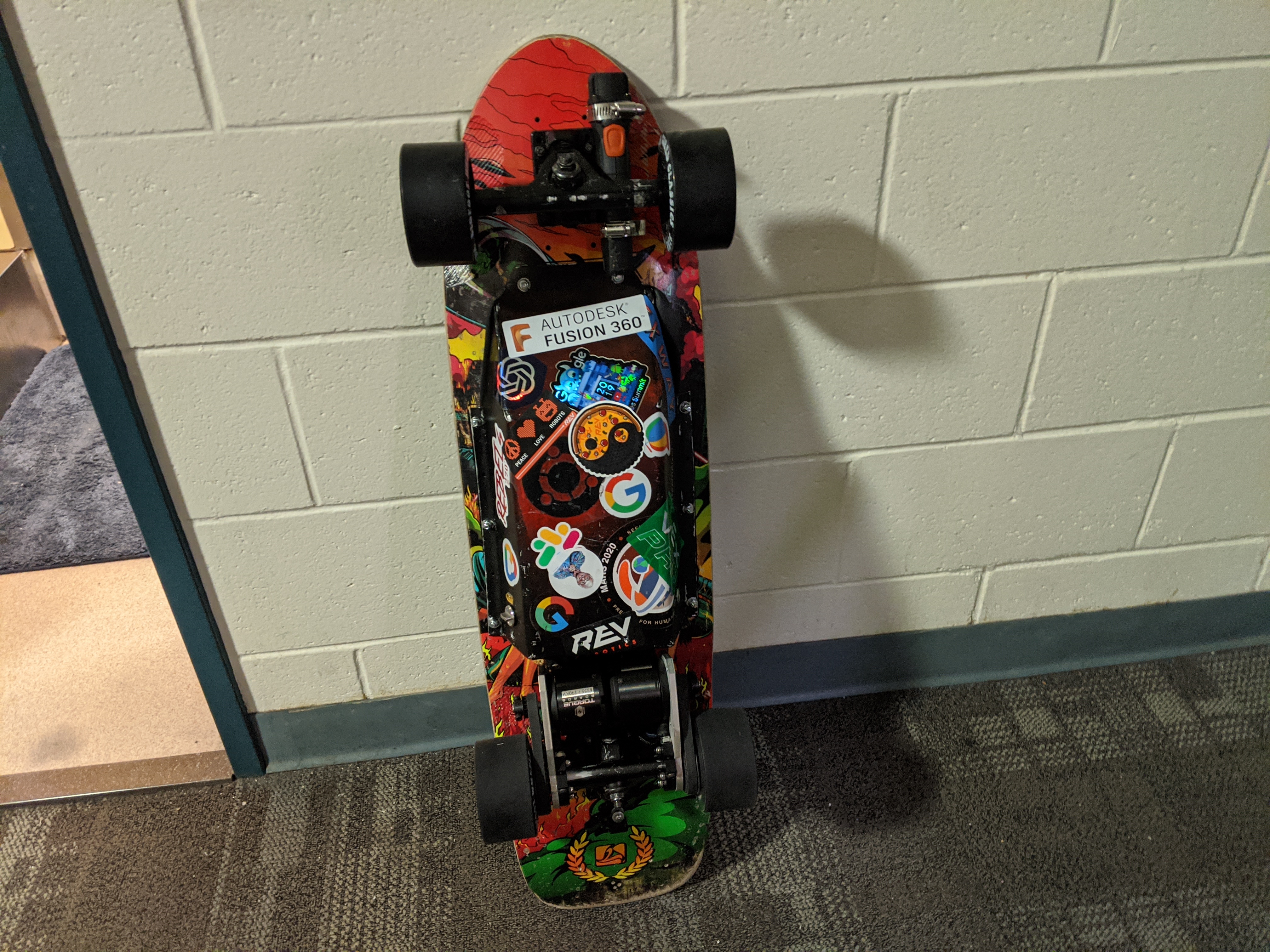

LILITH || - First build on Peacemaker 36"
I’ve finally got my first build to the point where I’m happy with it after (???) months/years…
So, I’m proud to present my abomination: Lilith. It may not be much, but it’s mine <3
Specs:
  • Deck: Landyachtz Peacemaker 36"
  • Trucks: Caliber II 50deg
  • Wheels: 97mm Abec clones
  • Enclosure: DIY aluminum abomination
  • Battery: 12S Graphene LiPo pack (8Ah/~350Wh)
  • BMS: Bestech D140 (charge only)
  • ESC: Focbox Unity
  • Remote: Benchwheel
  • Motors: dual @torqueboards 6355 190kv
  • Mounts: @Boardnamics short mounts (no idler)
  • Belts: SDP/SI HTD5 280x9mm
  • Pulleys: Exway Riot pulleys
Building this board was a blast, despite taking the majority of eternity to complete…
I originally started with my LiPos in parallel on 6s hobby ESCs, but switched to 12s and Unity after not too long. So far really impressed with the quality of the TB motors, lots of nice torque and they run nice n’ smooth.
The enclosure is mounted on screws right through the deck cause when I started out I didn’t know about inserts. The trucks have had the shit kicked out of them so the appearance is somewhat ah… rugged? But I think it adds some charm to the whole thing. The clone wheels actually ride crazy smooth despite being on the cheap side, which I’m really happy about. BTW, if anyone has stickers they want to send me, I’d be more than happy to add them to the enclosure stickerbomb :slight_smile:
I’ve yet to add my taillight so I’ll update the thread when I figure that out (also yes, my headlight is a flashlight clamped to the deck, get over it :stuck_out_tongue:)
Here’s the pics… I’ll get some better ones when I take it out for the first real ride.
Y’all have been a huge inspiration while slogging through a lot of setbacks building this thing, so I want to offer a heartfelt thank you to every one of you for being the amazing folks that you are. Cheers to you guys :beers:

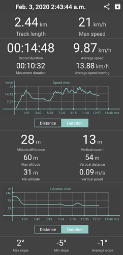

I was having trouble sleeping, so I decided I’d stop waiting for drier weather and take the board out for a little run. I have to say, after far too long tinkering trying to get this board to work, the wind on my face was so nice.
Did just shy of 2.5km (just a loop around campus) at pretty slow speeds (avg 10kph, don’t get mad at me, the roads were wet and I nearly skidded out twice).
So far I have to say I’m seriously impressed with the @torqueboards motors and @Boardnamics mounts on this thing. Motors run ice cold and make a real sexy hum, and the mounts held up really well so far. Excellent products from both vendors! :smiley:
I don’t have metr so I’m just using geotracker on my phone which seems to work pretty well, except the elevation and slope data which appear to be borked.
EDIT:

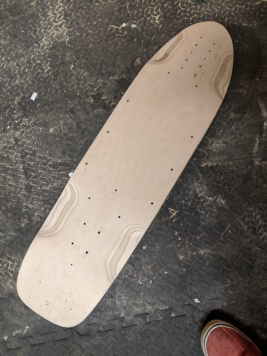

Further update - Since I have the board down for maintenance anyway, I’m working with a few friends to effect some overall quality upgrades.
The to - do list so far:
  • Replace a burnt capacitor
  • New, cleaner enclosure (most likely fiberglass)
  • Rubber gasket for enclosure - deck interface
  • Additional waterproofing for Unity, BMS & receiver
  • Closed - cell foam padding for internals
  • Sanding deck back to raw maple, staining and sealing (top & bottom) (possibly glass frit???)
  • Drilling and routing deck for phase lead routing through custom wedged tunnel riser
  • Replacing xt60 charge port with a 3-pin interlock connector, which allows the next upgrade:
  • Custom charge port disabling circuit which will disconnect BMS from charge port unless charger is connected
I only have a week to complete as much of this as possible, so wish me luck! I’m super excited to see how this turns out!
ÉDÏT: additional pylons to construct:

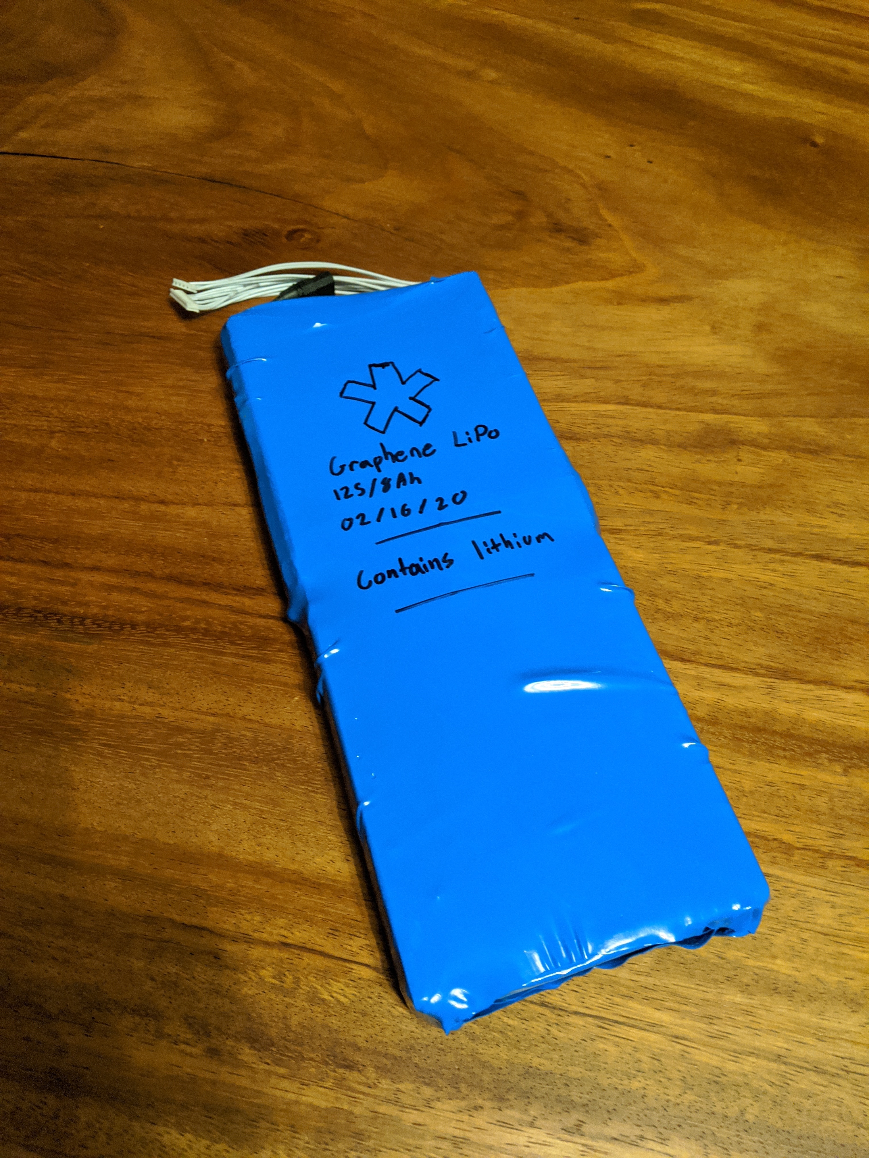

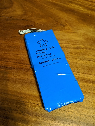

  • unfold lipos to make a longer, flatter enclosure
  • move baseplates to accommodate longer enclosure
  • route bottom of deck for wire channels
  • adding graphite powder to resin in the fiberglass layup to make a cool finish
    More things to come…
First goal to be completed: batteries have been unfolded and repacked into the new form factor!
I’m going to start working on the deck today but I don’t expect to get much done. I have to wait until Tuesday to get my fiberglass so tomorrow will also be focused on deck work…
I got a smidge of work in on the deck today… Took it up to 400 grit with an orbital sander.
Currently contemplating how I want to arrange the enclosure, how I want to finish the deck, and how I want to route my cable slots.
