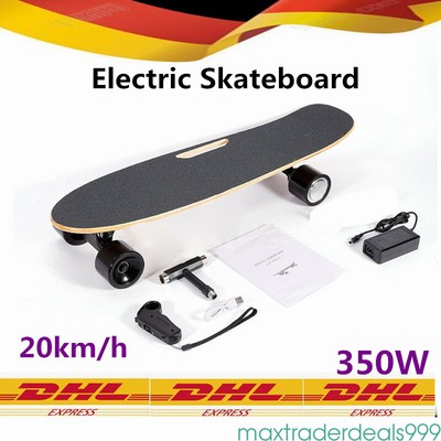

Something like this then? Lightweigt cheep and prebuild.
Maybe not if u are 50kg+
The batteries that come in that skateboard are terrible and will fail Within the first few rides.(I’m actually doing a battery upgrade for one now)
Damn i must have ben lucky i bought one for my sis kid 8yr and this is the second summer hi ride’s it. and he is not kind to it. but stil running. but he is no more then 30 kg.
For someone light it’s fine as your not pulling too many amps but with someone heavier you will pull too many amps and damage the battery.
