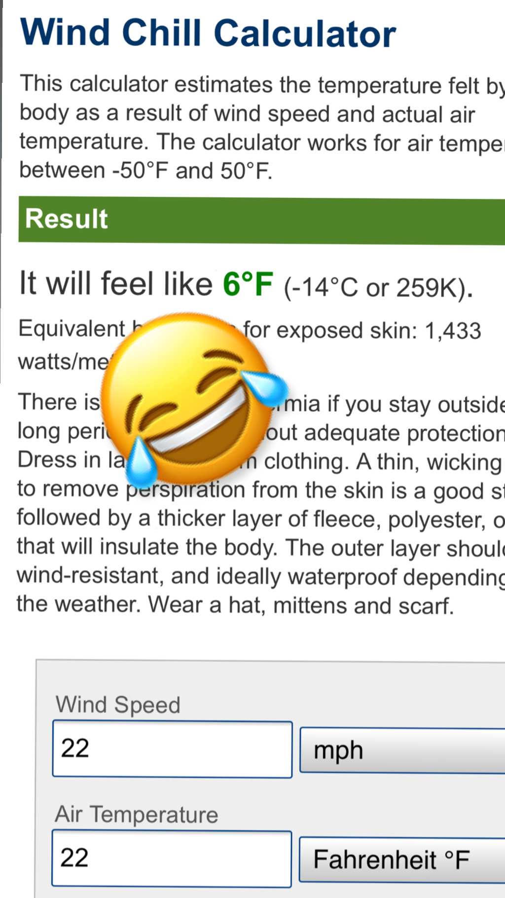

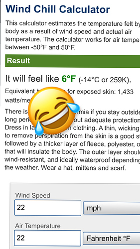

Cold weather?
:rofl::rofl::rofl::rofl::rofl::rofl::rofl::rofl::rofl::rofl:
As you were.
:sunglasses:
it’s going to be 80s here all week… in November… crazy…
