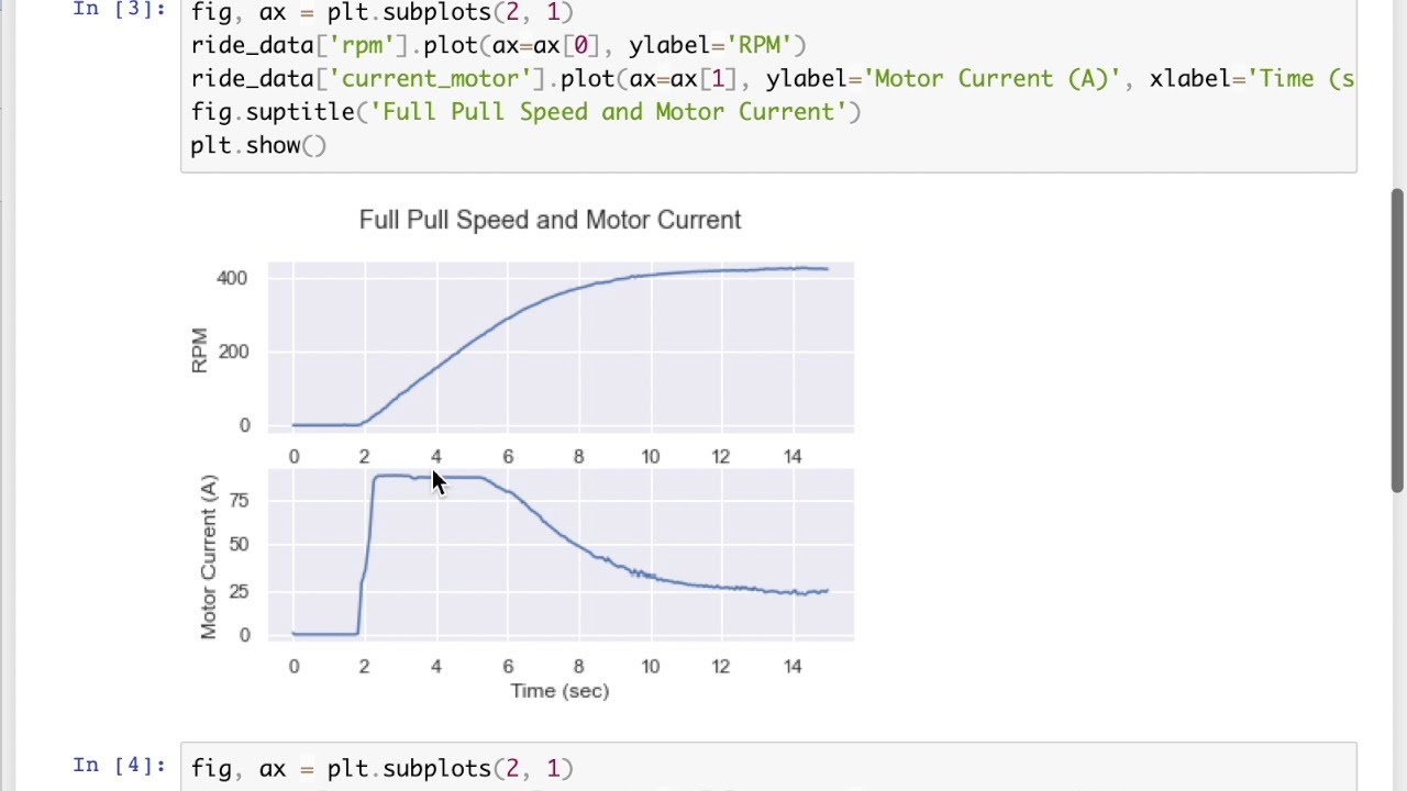

The motor current per motor will always be higher than the battery current per motor (the esc lowers the battery voltage… higher current and lower voltage on the motor side is the same wattage as the lower current and higher voltage on the battery side)… so you need the motor current limit per motor to be higher than the battery current limit per motor.

This is confusing motor current for battery current, which are two different things. You can run two motors at 60A each, while only consuming 20A total from the battery.

At low speeds. Then once you get past 1/3 of your top speed you’ll be pulling less and less motor current until youre only getting 20a at full speed. Basically, you will never pull more than the battery current setting from the battery but if you set the motor current higher you will be able to get more current (without pulling more battery current) while at low speeds)
