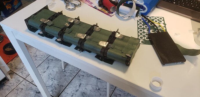

This was intense, battery building aint easy. Had a couple small accidents, but luckily the high current just melts wires quickly…I took a small ride and it’s awesome. More battery sag than the 6p obviously but so nice to have it all in the frame. Right now set at 50% power so around 2800w feels great. Waiting on heatshrink for the battery now.
edit:
gave it the beans, absolutely crazy of course with bms bypassed. I did sag the battery from 78v to 62.5 on hard acceleration. It did bounce back really fast to 78 ish again. I’m not super happy about my connection tabs, wondering if they are good for 50A let alone 80a pretty much throughout the battery. I did want to use the diagonal ladder style nickle but it ends up so small on the connection points idk. Also the soldered points are kind of meh. I cleaned them up since this photo but wondering if I should have just spot welded those too.
