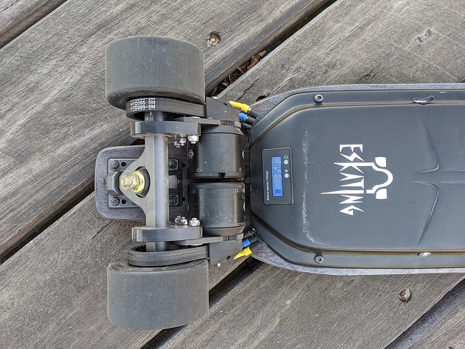

I’d like to present my first build. I learn’t a lot, both from research and error, and overall I’m pretty pleased with the result.
PARTS LIST
THE BUILD
After falling in love with the design of the Landyachtz Evo Falcon, I didn’t hesitate in deciding to base my build on it. The deck performs just as well as it looks providing stability at speed whilst still allowing for comfortable carving. Learning that @Eboosted made an amazing enclosure for it absolutly sealed the deal. The enclosure Alan made is truly a work of art, it fits the deck like a glove, has enough room for all the components and looks amazing all at the same time.
The battery I used is a 10S4P 36V 12000mAh made locally here in WA buy @Marsen Energy. The quality is top notch and construction fast with a three day turn around. Attached to it I have the Bestech BMS bypassed for discharge.
Considering this was my first build the electronics were quite intimidating at first, but after some decent research and planing I managed to get it all together. I ended up removing the connectors between the switch and VESC soldering the wires together to simplify the wiring, and secured all the parts using velcro strips. I ended up having to cut the end of the enclosure off as the motors had zero clearance.
The motor set up was also quite a challange. The motor mounts from eskating eu are top notch and fit the caliber trucks perfectly, however they do position the motors quite low resulting in minimal clearance. The angled riser pads did help, but as mentioned before I did have to remove the end of the enclosure. Combined with the massive 97mm wheels from @torqueboards the buisness end of the board turned out nicely. The rest of the build was securing everything together and although mistakes were made along the way I’m happy with the over all product.

Solid build, only thing I would change to improve it is the wheels (they’re just cheap clones I think). Shame you had to cut the end of the enclosure, I wonder if that’s an oversight when designing it. I guess others just have more risers on their Evo builds?

Nah, I run mine out the back is all. I ran into this problem when I first wanted an Evo build. I had to dewedge mine and it kinda sucked. I switched to rear mounting mine with BNB 63mm idler mounts. The clearance is pretty good.

I run my evo with no risers and 50 deg surfrodz rkp! I would never dewedge that thing.
I wasn’t keen on the risers, but without them the motors touch the deck.
Yea, a flat riser shouldn’t be too bad, just dont do an angled riser.
If you want to try angles, adjust 5 degrees at a time, nothing more than that. You can really tune the geometry of that deck and your handling with +5 -5 degrees.
