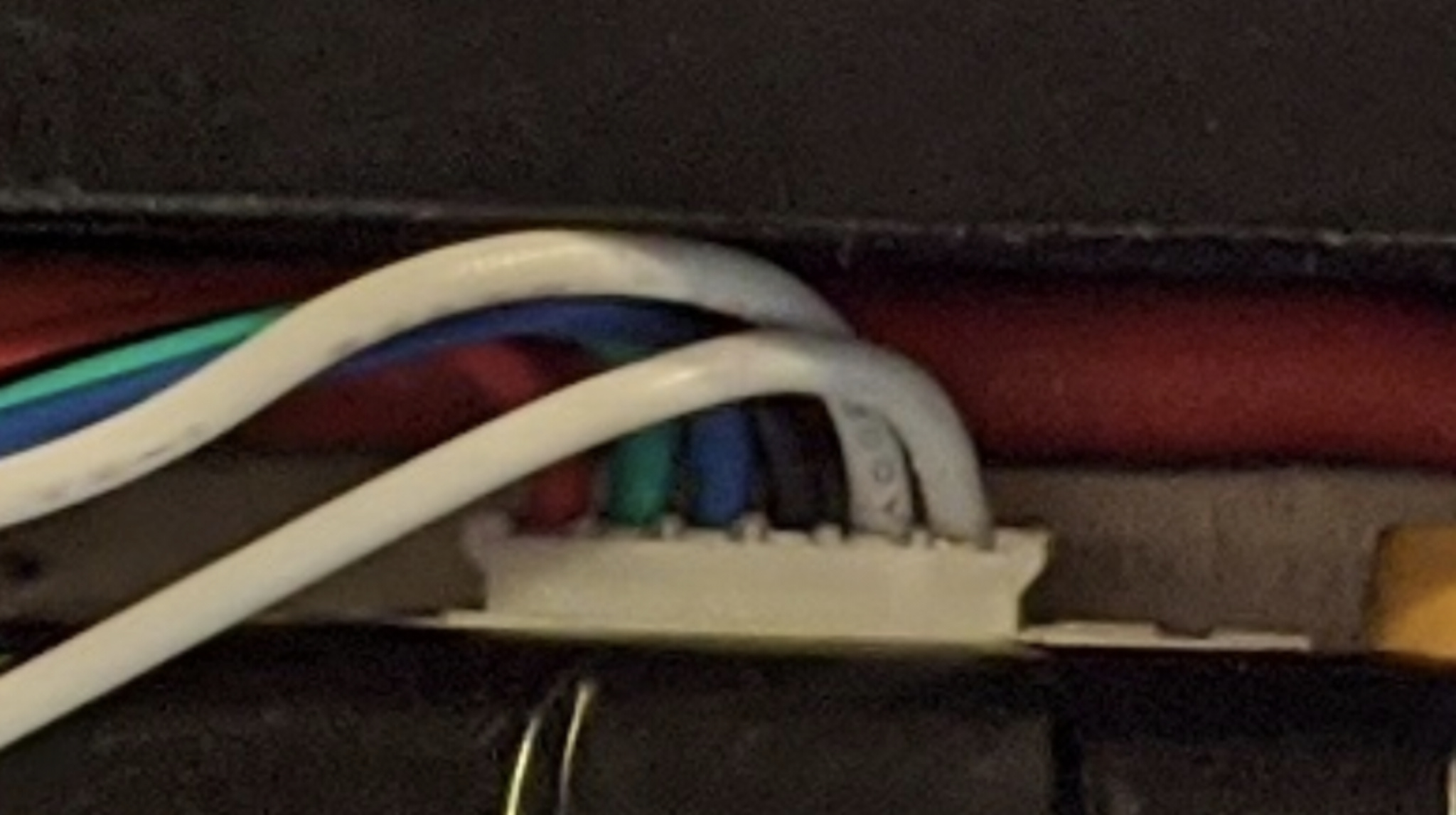

Seems like this changed at some point during development. My beta unit also has something odd with the switch. On beta 6 my red and blue are switched on the button so the voltage indicator colours are wrong, but I have been told this is fixed the the build they ship with and will be fixed in the main vesc branch before the next official release.
EDIT: checked my wiring. My plug is red green blue black White white.
It matches what’s printed on the case but my colours are still wrong in beta 6.

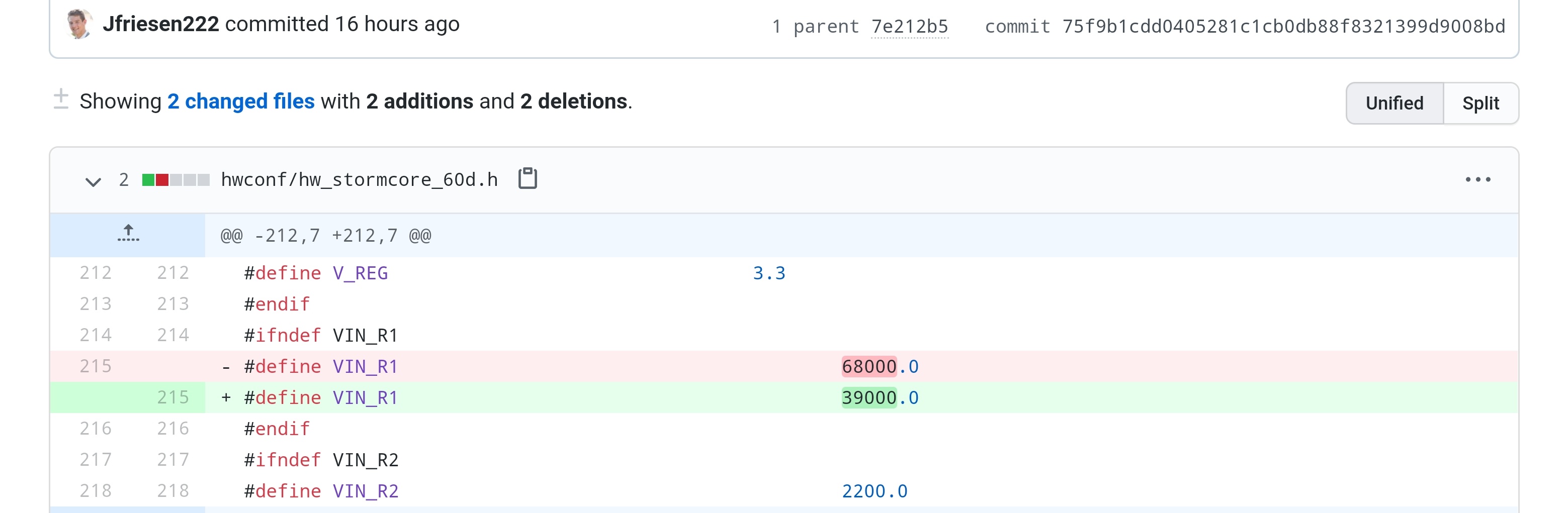

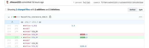

I did reflash stable and it didn’t fix the voltage issue I was seeing.
But apparently flashing using a test jig fixed it. (I am assuming its an swd flasher).
I was also surprised nobody else reported seeing this bug…
This should be fixed in the next release

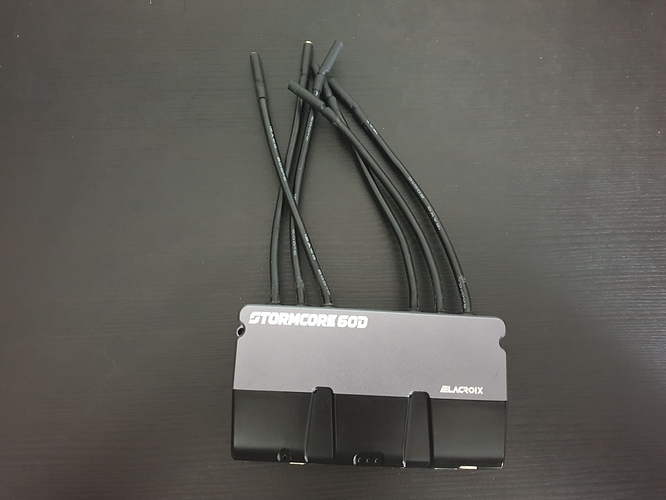

It took a while but I finally got it
I had some problems with customs…
Had to pay another 110€ but I still think it’s worth it
€127.79 here. I think we’ll be happy all the same. Buy cheap, buy twice.

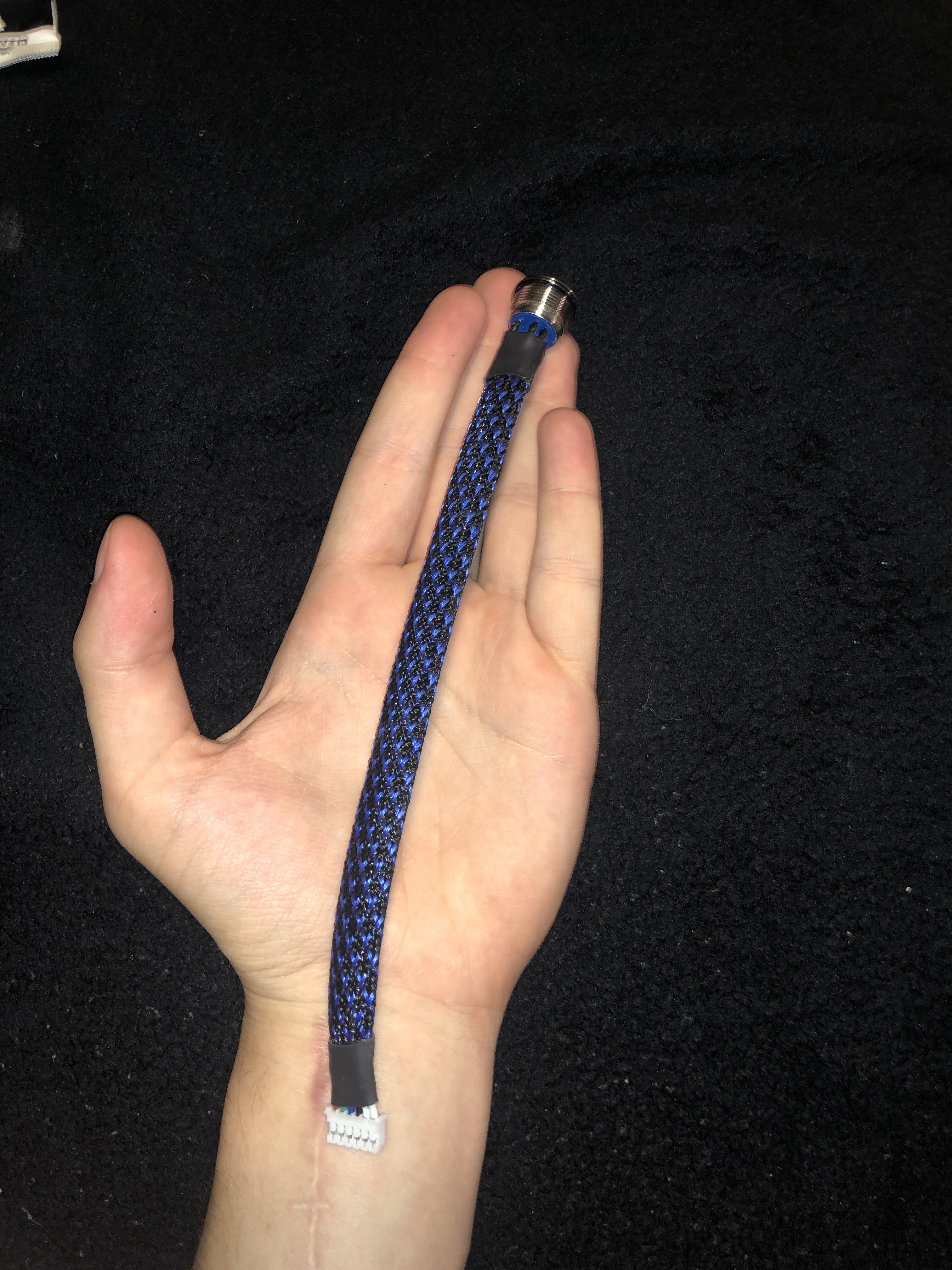

@Skyart made it pretty
Very pretty! But isn’t that going to be inside an enclosure?
Should have said it turns him on now
