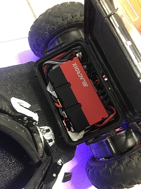

This puppy is running 100D since today. Time to test the Stormcore tomorrow. At this time, the Stormcore is temporarily mounted in the housing without an additional heat sink. Very curious how fast it heats up.
Yeah baby, can’t wait to see feedback from other testers! Is that 18S voltages I see there?
Yeah! Running 18s5p with Samsung 40T.
Unfortunately currently no motor temperature with fw5.1
Awesome! What’s your kV and gearing? Are those Bioboards 6396 140kV motors on 1:5 e-toxx GBs?
Yeah fully correct! But I am already thinking off swapping those motors out.
They get very fast very hot…
Get something that’s open can with a built in fan. I haven’t had overheating with my SK3’s for example.
Yeah I know… running a sk3 on another board for almost 2 years. Only a little bit warm but not hot.
And at the end, I hoped sealed was more sealed then this… you can look straight from the motor wires into the windings. And also a to big gap between the mounting plate and can. Maybe I take a look at some APS motors.
