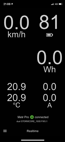

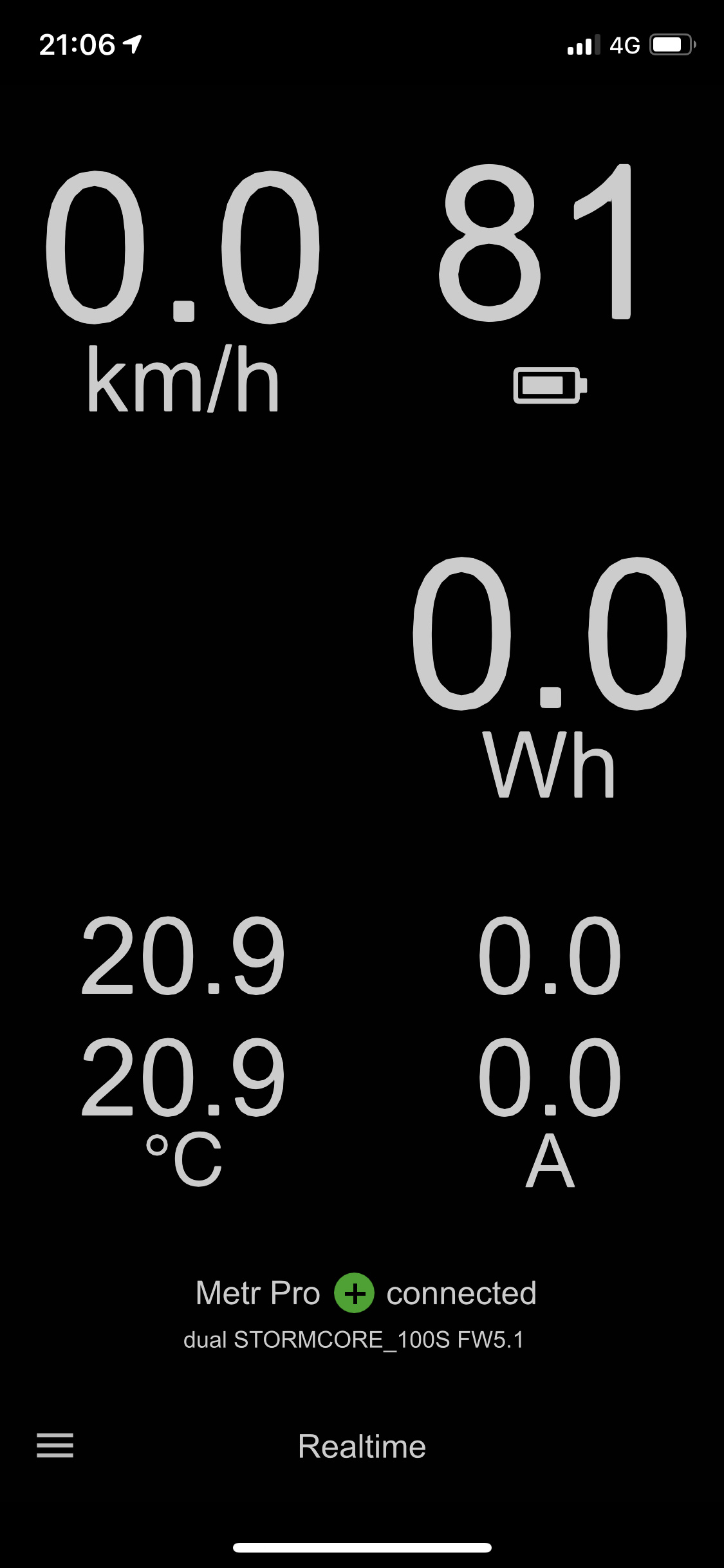

Really want to get started with logging but assume that I’ll need the unity metr instead of the one that works with the flipsky once I switch to stormcore?
Correct?
No, actually a Metr Pro Unity will not work with the Stormcore (without building an adapter cable) because it doesn’t have a 2.0mm pinheader port like the Unity but as far as I know the Stormcores come with a standard 7 or 8 pin JST PH UART port so a standard Metr Pro or also upcoming Metr Pro CAN module should work out of the box.

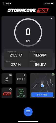

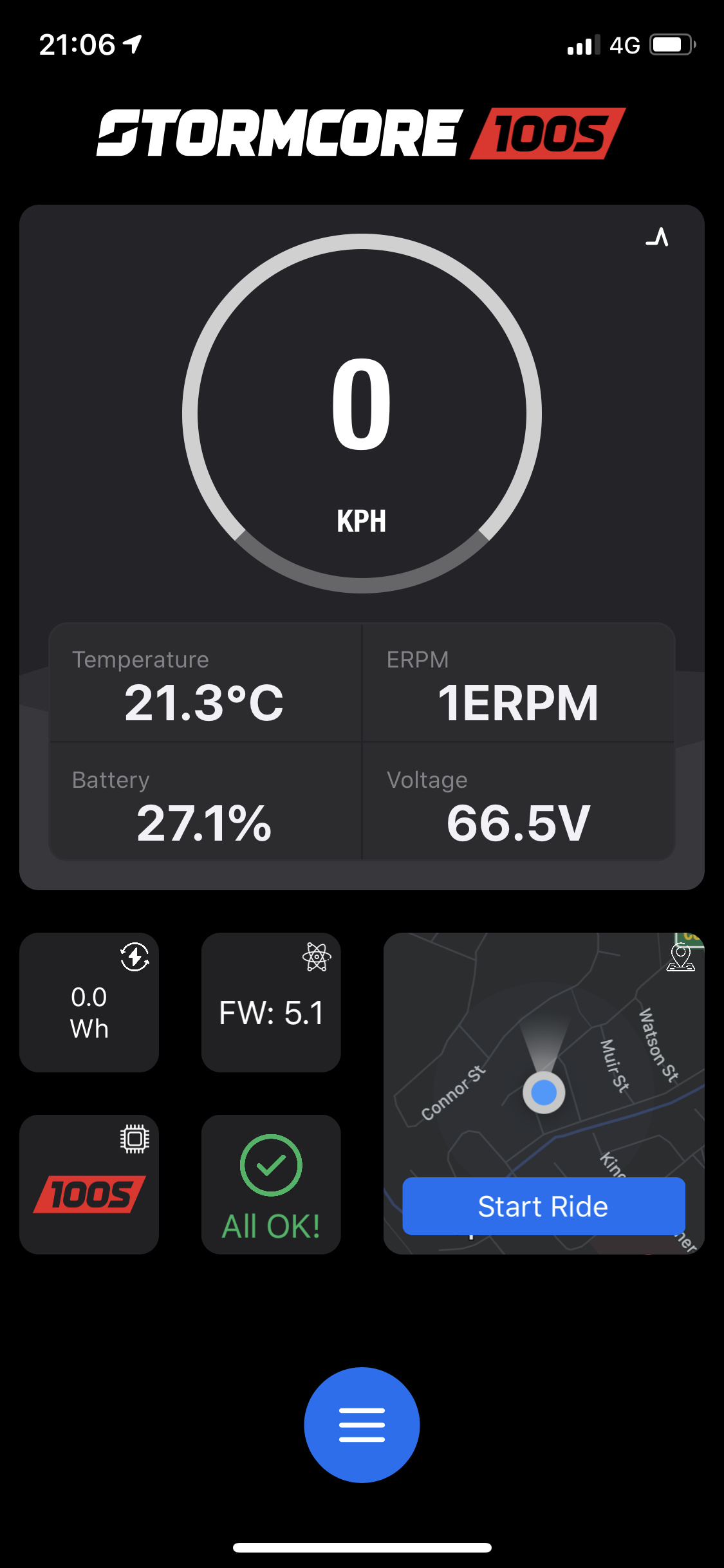

Telemetry is on! Hopefully the weather plays along tomorrow!
