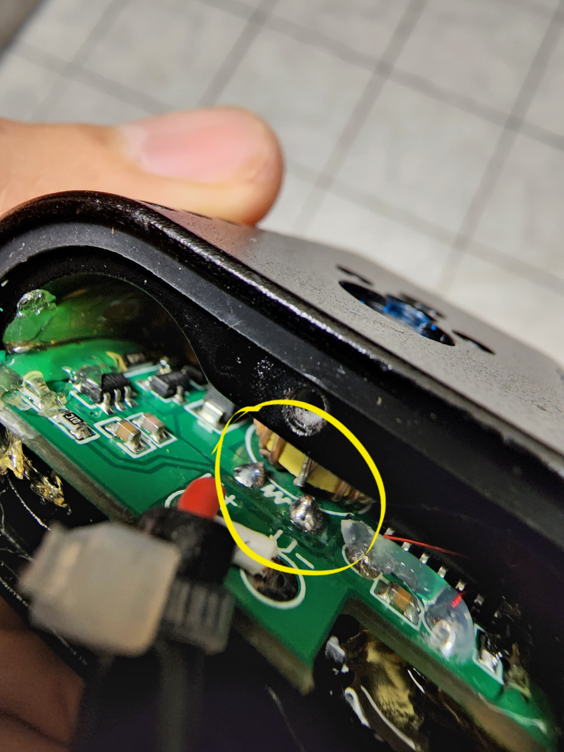

When mine went out I had to resolder these to get my light working
Possibly same issue with you?

Mine got done with the coil breaking itself from the contacts. Resolder and a bit of glue to make sure it no longer vibrates against the pcb did the trick.

I actually just got two of the four lights that previously stopped working from my lone Star to work just now!
couldn’t find any bad solder joints but turns out just by lifting the coil a little bit to check the one that runs under the coil somehow the act of lifting it up allowed the light to work again.
Now that I’m putting it back in the housing I’m seeing that it’s possible for the coil to touch the enclosure copper to aluminum… which that can’t be good.
I’m wondering if I get this thing in a position where it’s working can you just hit the circuit board with some hot glue to keep everything in place or does that not mix well with circuit boards and potentially conformal coating?
maybe that’s why they’ve got the white glue on the top of the coil… to keep that copper from hitting the aluminum light casing perhaps?
anyway just ID-ing those solder joints you pointed out on the coil got me moving in the right direction so thank you thank you thank you thank you!

Maybe a cold solder joint?

I don’t think it’s the cable though I noticed when I put the board back into the light can the slot they have for it is like 3/16 of an inch and the board is like a 16th of an inch thick so it’s not really held in place very well inside cases so probably rattles around a lot in there🤷🏻
