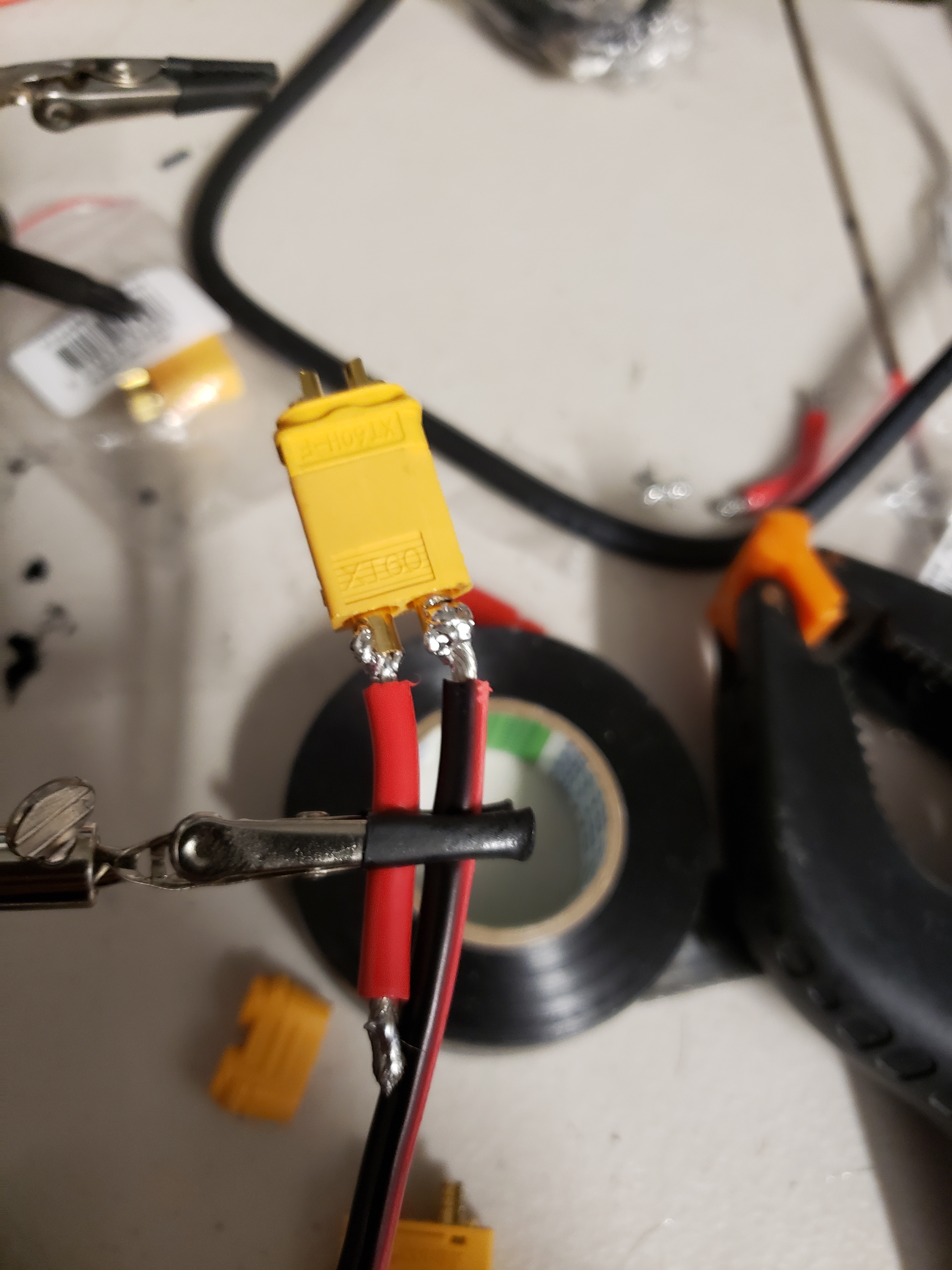

And my first attempt at a loop key was much harder than expected. My soldering of larger wires/plugs sucks! I think I need a hotter iron (I’m using my old man’s iron which is at least 30 years old haha).

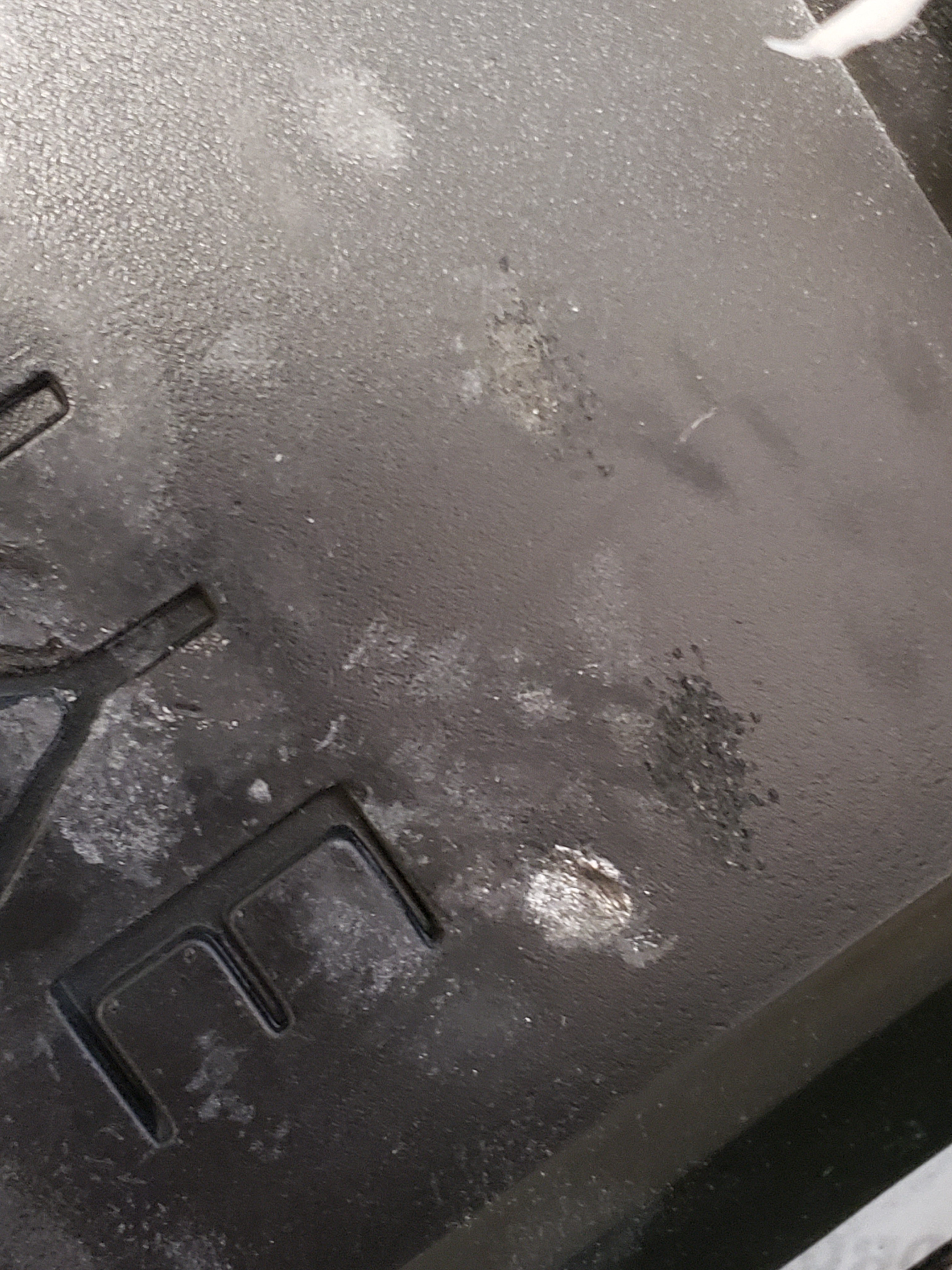

Opened her up and realized I’d fucked up. I didn’t secure the esc properly to the deck and saw the inside of the enclosure had melted where exposed bullet connectors had been pushed in by the loose ESC. Two bullet connectors had burn marks (somehow heat shrink had shifted!??). I think I’ve killed the motor but I guess it could be the bullet connectors (definitely not ESC as switched sides with motors to check). The motor in question does weird shit like work sparadically but with strange noises and shudders particularly under brakes.

Ah fuck!!! Same shit happened again but on the other motor this time. I don’t know WTF is going on. First I thought it was because the esc came loose. This time that is not the case but the phase wires have melted at the bullet connectors same as before, just the other motor this time.

As the pics hopefully show, you can see the heat shrink that seems melted or somehow shifted on connectors. Definitely some melted spots though. And on the enclosure where phase wires touch.
Edit: Thanks to B264 for the help! It appears I just suck at soldering and had a cold joint. Will do a pull test on the remaining connectors and hopefully good to go with new connectors again. Time for a new soldering iron although a good craftsman never blames his tools. So yes, I’m not a good craftsman haha
