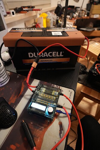

Recently switched to a 100Ah 800CCA car battery and I can now weld an entire pack (or more!) in a day; no more recharging small lipos :partying_face:
The prototype:
As Hobbyking is often out of stock on my recommended Lipos, I’ve bought and tested a few more models. I can recommend these two:
https://hobbyking.com/de_de/turnigy-nano-tech-plus-5000mah-3s-70c-lipo-pack-w-xt90.html (calibrates at 1570 amps when fully charged)
https://hobbyking.com/de_de/graphene-5000mah-3s-75c.html (calibrates at 1520 amps when fully charged)
Unfortunately, as of writing this, also these have gotten out of stock… My order was just a month ago.
Any one heard anything new about it?

  • Turnigy nano-tech 3S/5000mAh/130C Lithium Polymer battery (link or link). I have stress tested one of them for several complete discharge cycles, and it shows no visible swell thereafter. The measured current is 1300-1500 amperes.
  • Ultracell UXL65-12 (link). According to feedback from a user, the current reported by kWeld is approx 1000A when tested with 0.15mm nickel strips.
I use 2x of the ones you linked in parallel you want as many Amps as possible but don’t exceed t2,000A
How many welds can you do with 2 in parallel?
I wanna weld 70-100 cells before having to recharge. (a complete pack in one go)
That will be a piece of cake for this machine. I am about to stress test it with 200J pulses once per second (at output terminals, that translates to 100…150J at weld spot depending on output leads). It is designed to sustain that. The setup will include water cooling the test load in a bucket with water exchange via tap water.

I got my K-weld and just got it all set up :slight_smile:
Any Joules recommendations for 0.2mm nickel plated steel?
I started with 25J and it looked fine. And ripped up leaving dots.
I tried 18J and it looked almost the same. And ripped up leaving dots too.
Should I keep lowering until it stops leaving dots when I rip the nickel? And then increase that minimum by 5J?
Thanks
And what grit of sandpaper do you guys recommend to clean the probes?
Thanks
Are you sure you have .20 nickel lol
Are you welding these into real cells and testing?
I weld my .15 at 37.5J and your thickness at a higher amount
He said nickel plated steel, makes sense he needs less energy
