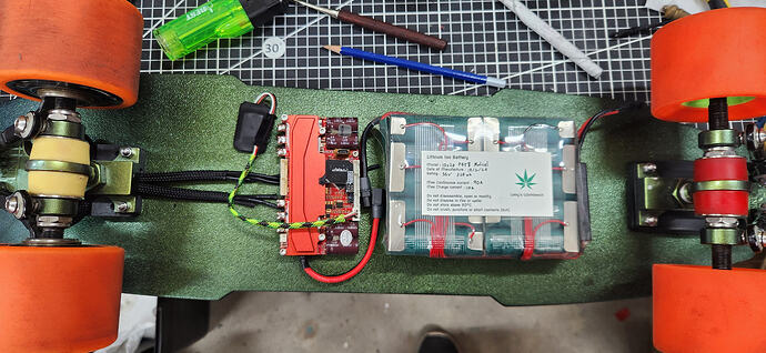

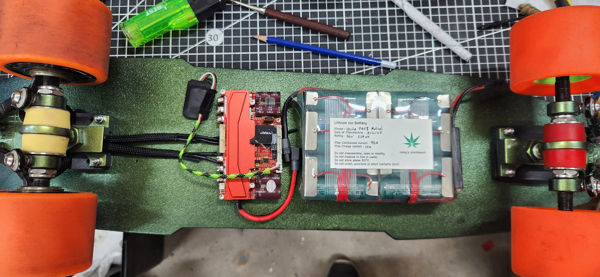

Kushboard Nano, not so light anymore | 121C Orbiter deck | 3 link trucks | 10s2p P45B | Loaded Hubs | Xenith
Wow, this orbiter deck really has seen everything.
I was very close to selling off this build to a friend, but he ended up getting an ebike so after scrambling parts and stuff I figured it’s time to upgrade this since I have the Kushboard Pico already, which is a more precision and lighter board than this.
So one time I left the board on and the battery drained because the antispark was the old ones that dont automatically turn off….
So I thought of doing something very odd, taking the small DH stooge 3 links with Loaded hubs and plopping it on this deck.
Paired with a 10s2p P45B pack and a Xenith, I got to work.

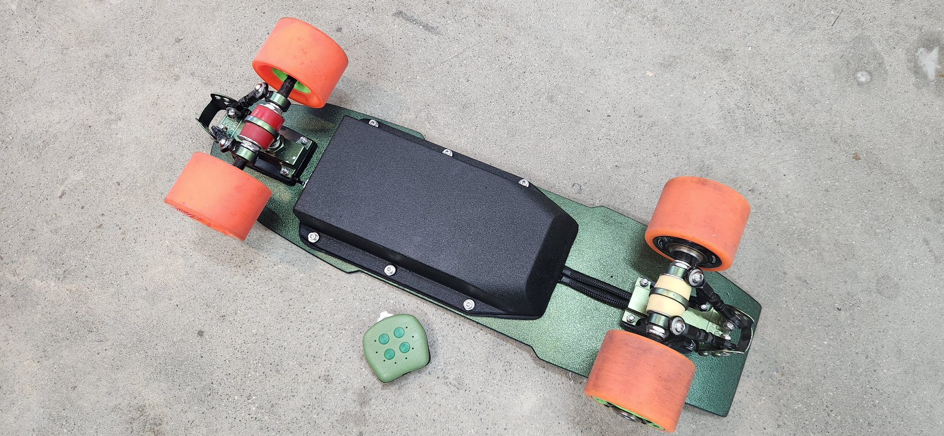

I had to sand the previous holes and seal it with epoxy. The old enclosure gave up so I re printed a new one in PETG CF, and painted it too.
same goes for the deck. A sanding job on both faces and a new coat of paint.
This has the best truck size to deck ratio if you ask me. Both are proportionately sized and fits so well.
7 years old and counting, i give this board new life. Can this be counted as a submission for BOTY hmmmmm
