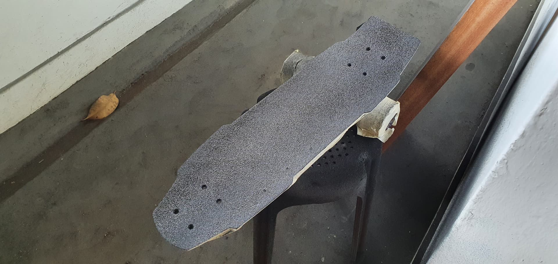

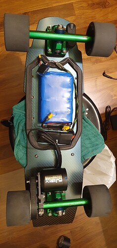

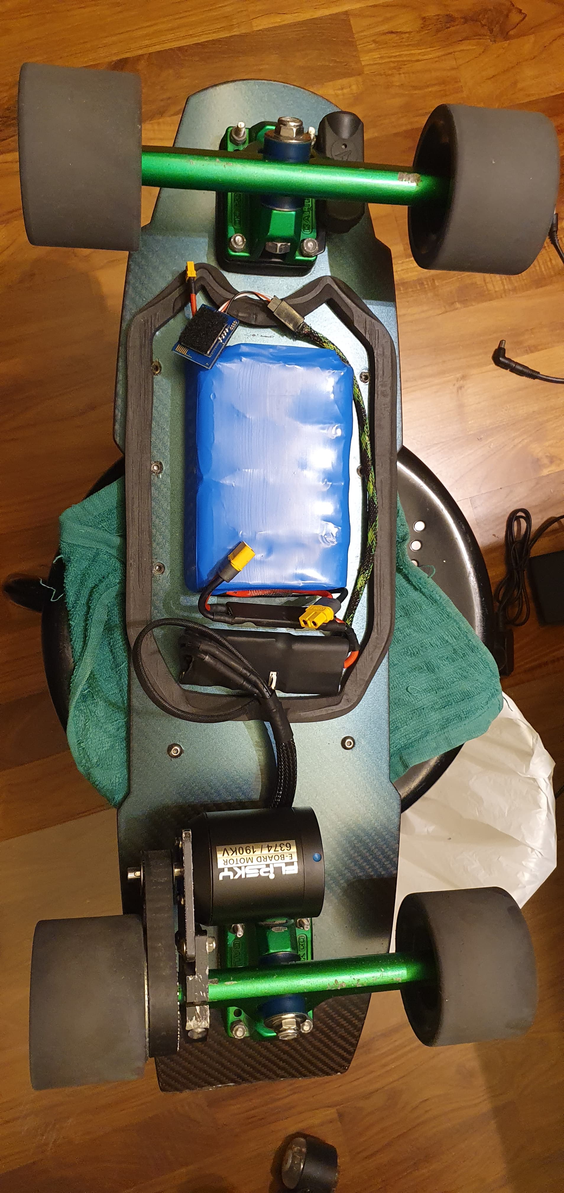

Been awhile, I’ve been using this board everyday as a commuter to work. Unfortunately the battery seems to have a few groups that may have drifted. The battery is also pretty worn so I figured it’s time for a little makeover as well as a new battery build! This is what it looks like now.
Here’s my plan

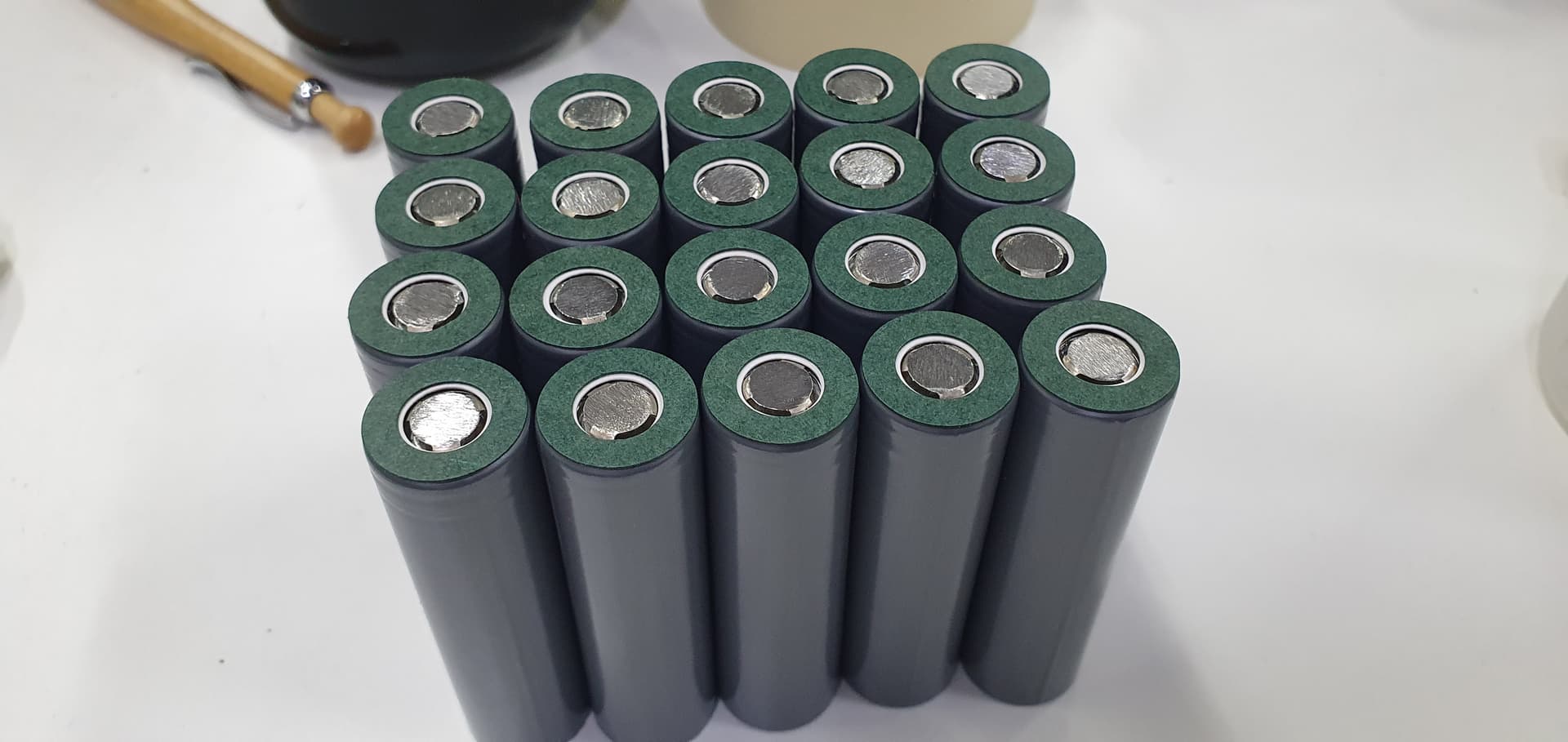

Using salvaged Sony VTC6 cells to rebuild a new 10s2p
Change to a Flipsky battle hardened 6374

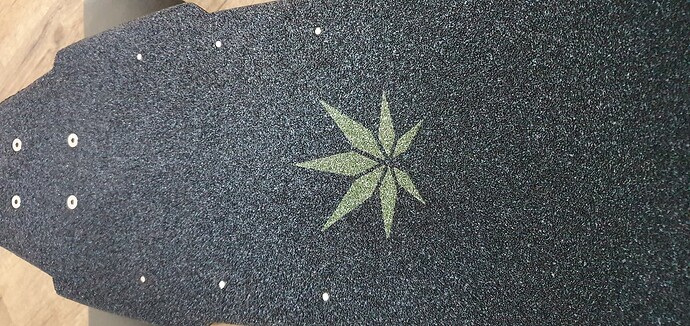

Remove griptape and spray bedliner on the top of the deck
Let’s see… anything else to suggest?

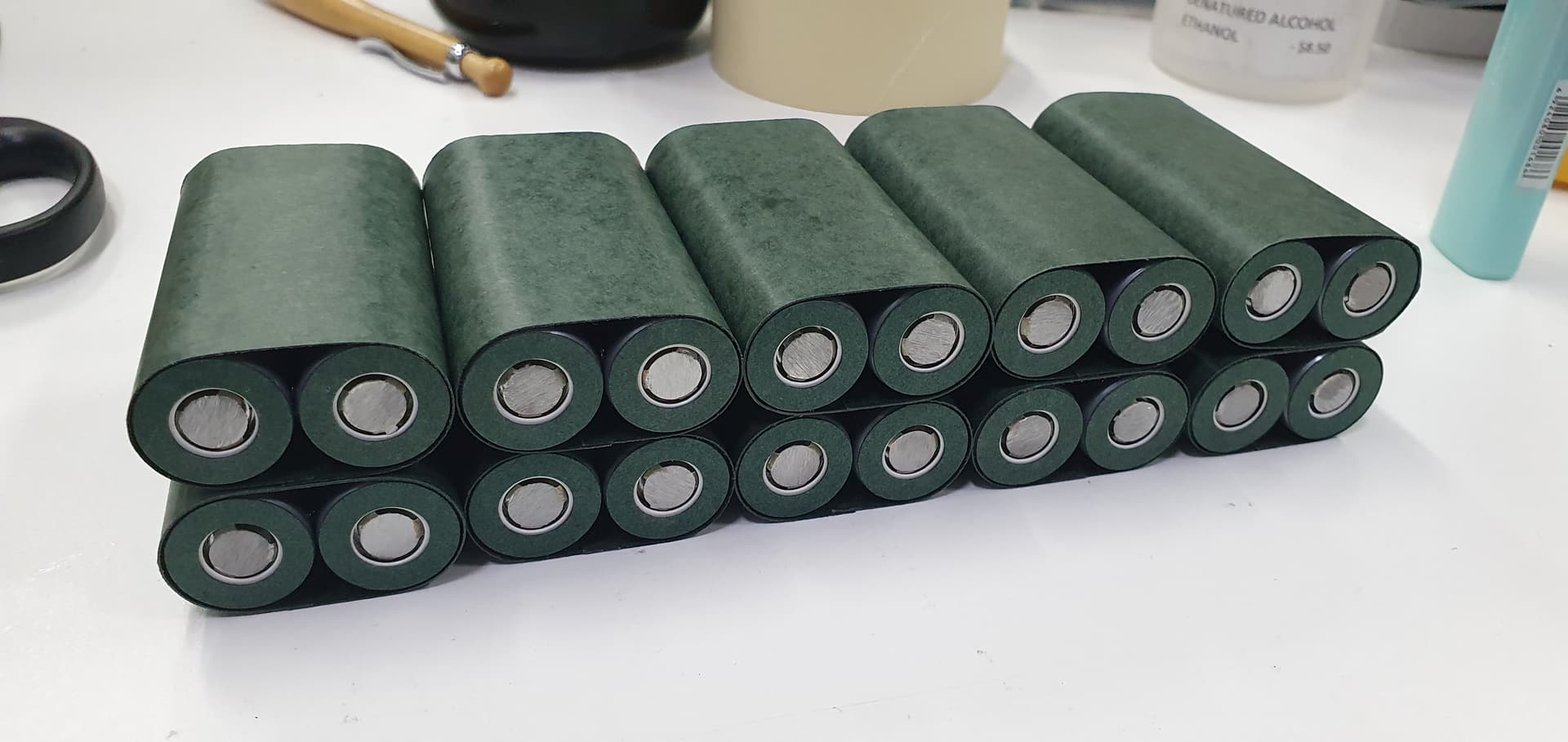

Incoming battery building pics!

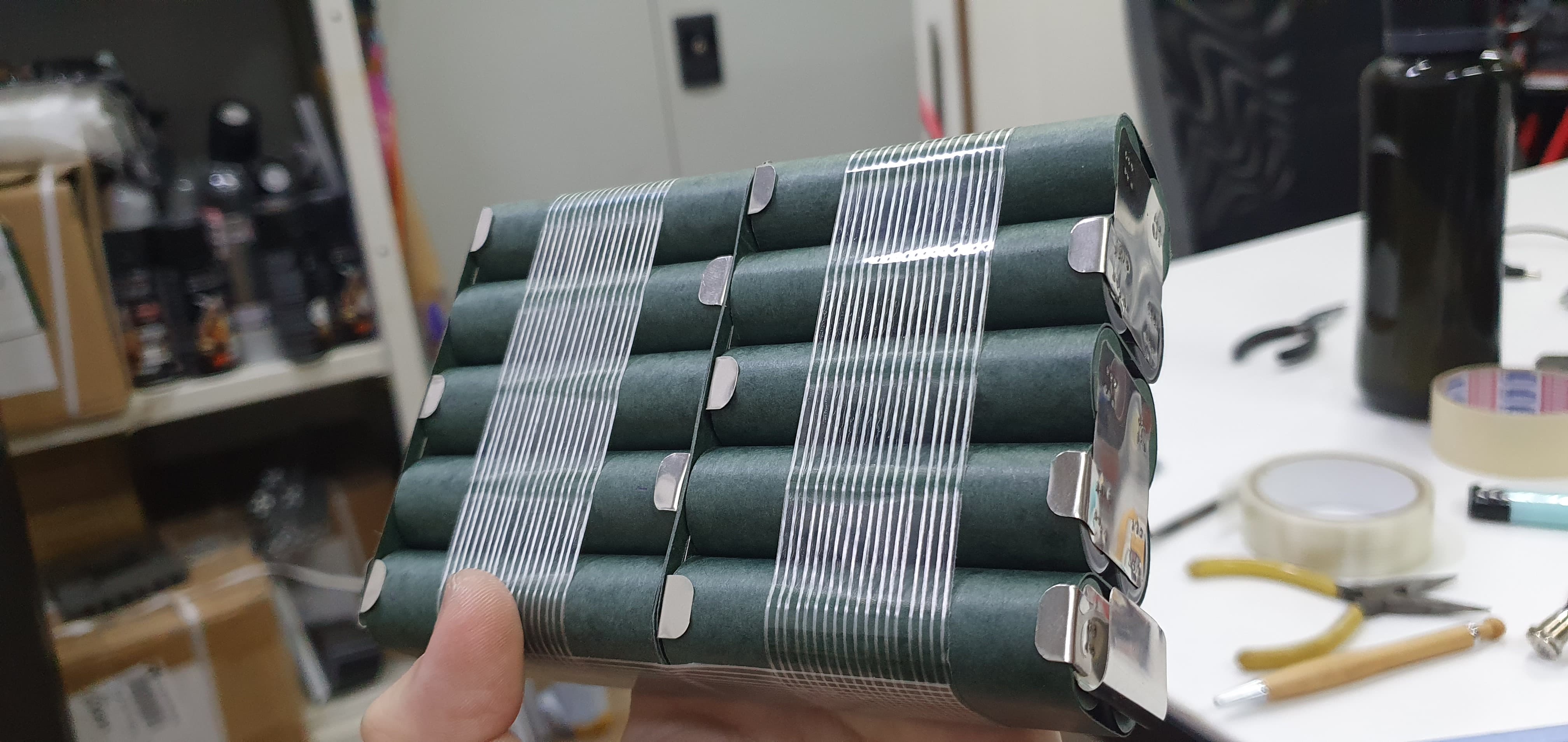

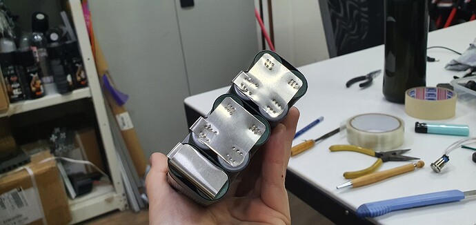

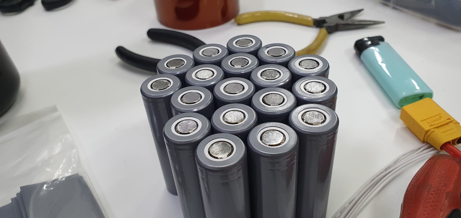

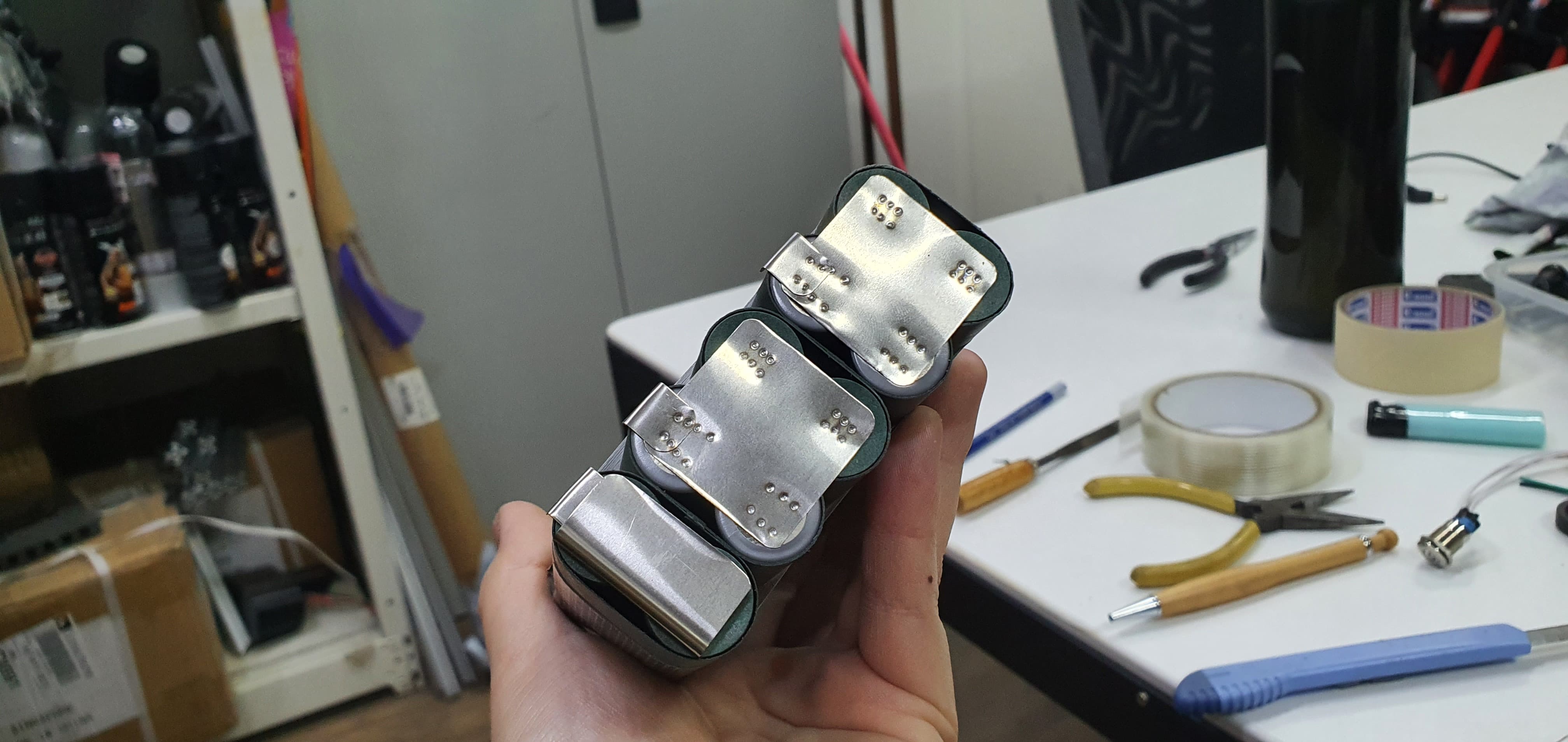

I cleaned and ground the terminals flat, and re-sleeved the cells as the old ones were slightly scuffed.

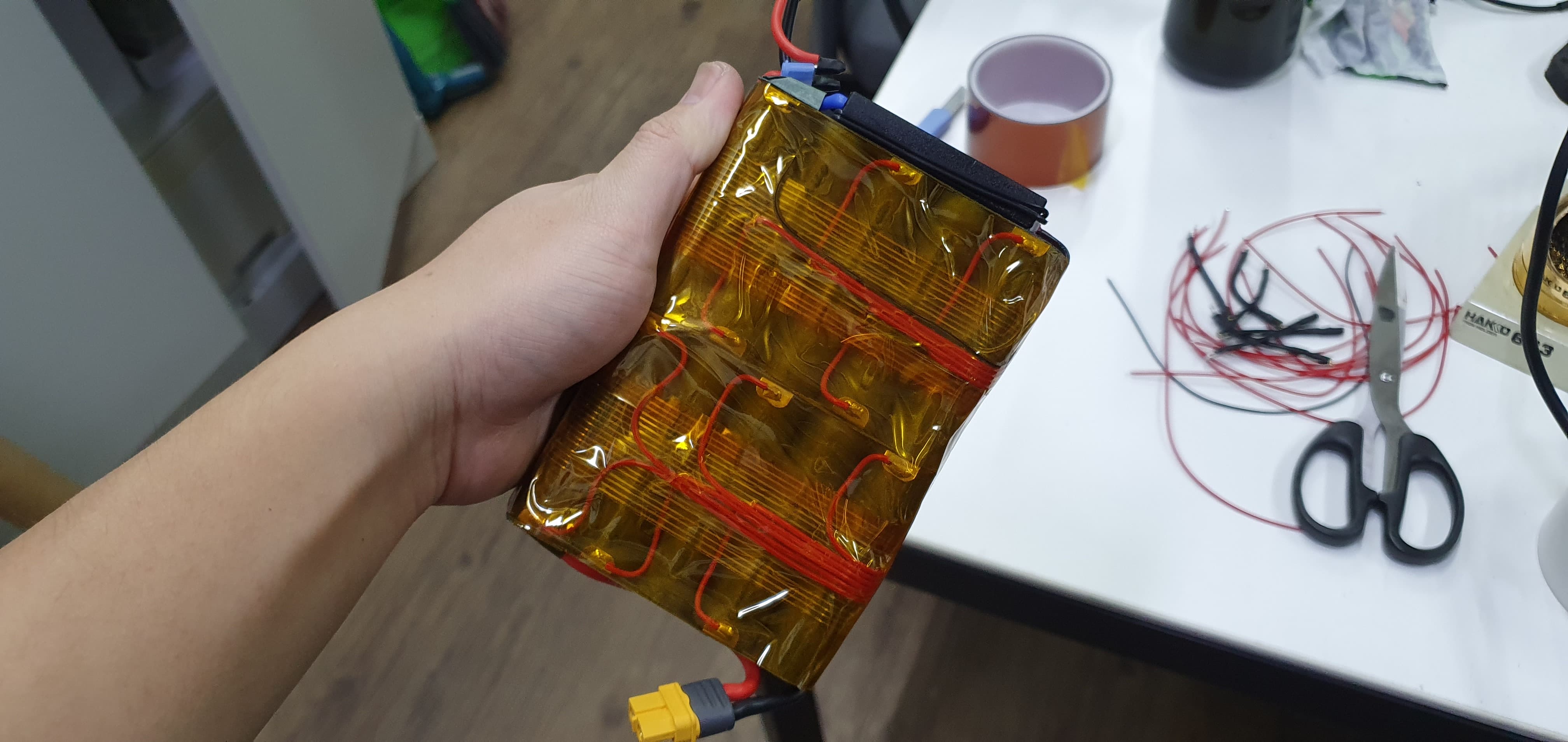

Then I siliconed and wrapped them in fishpaper. And it’s welding time!

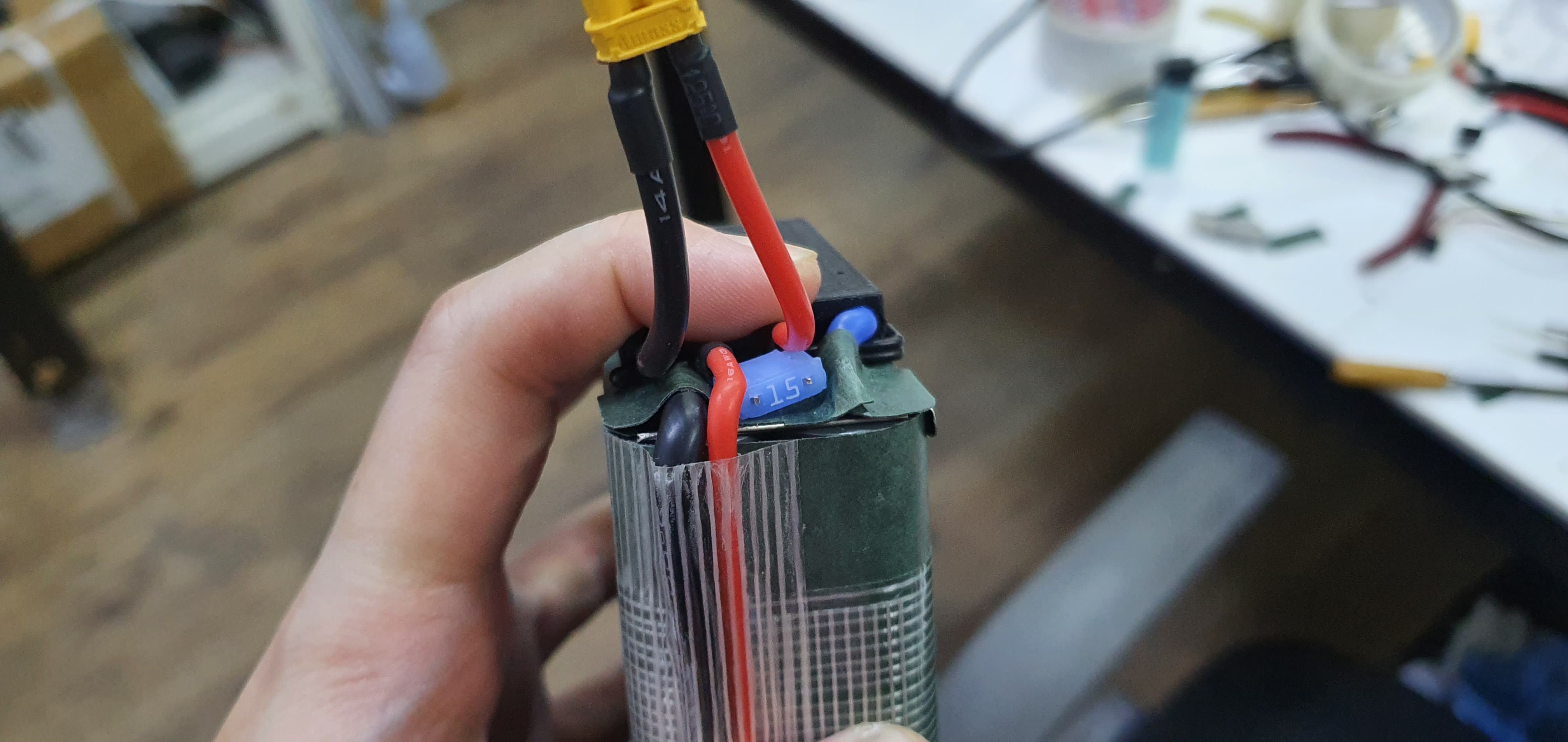

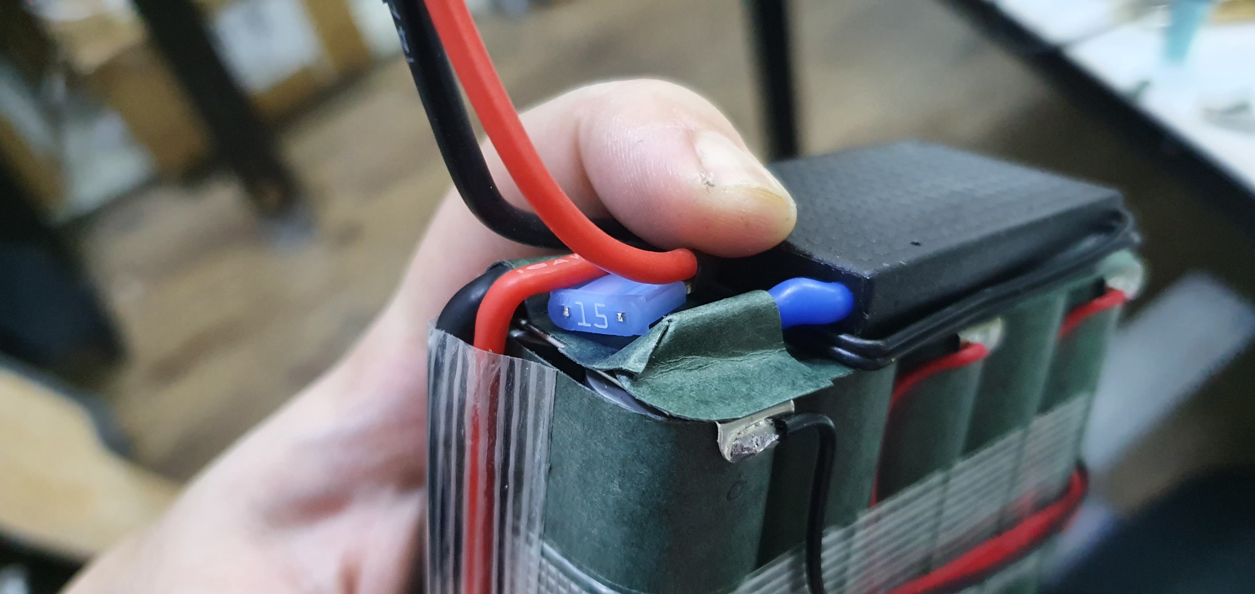

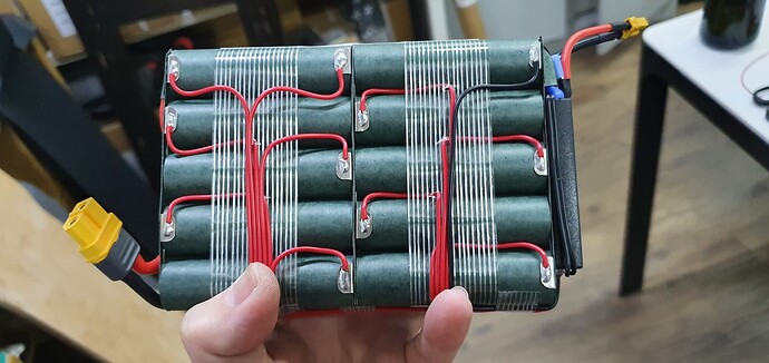

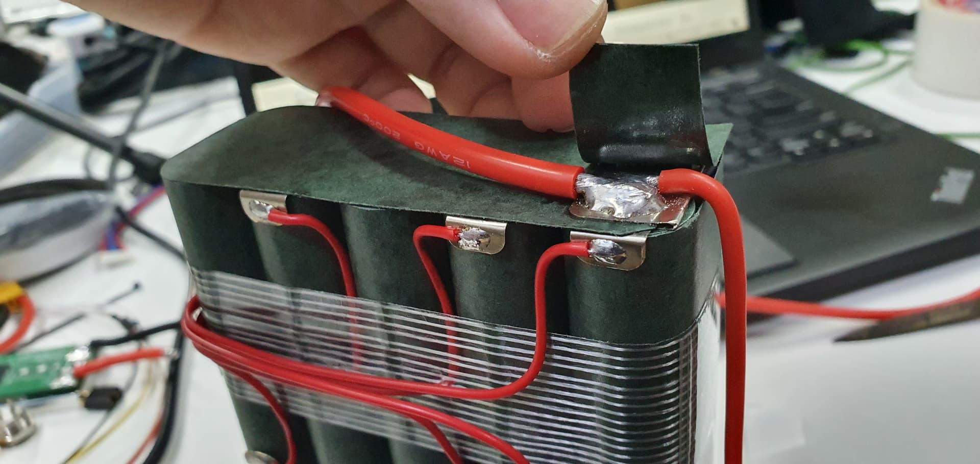

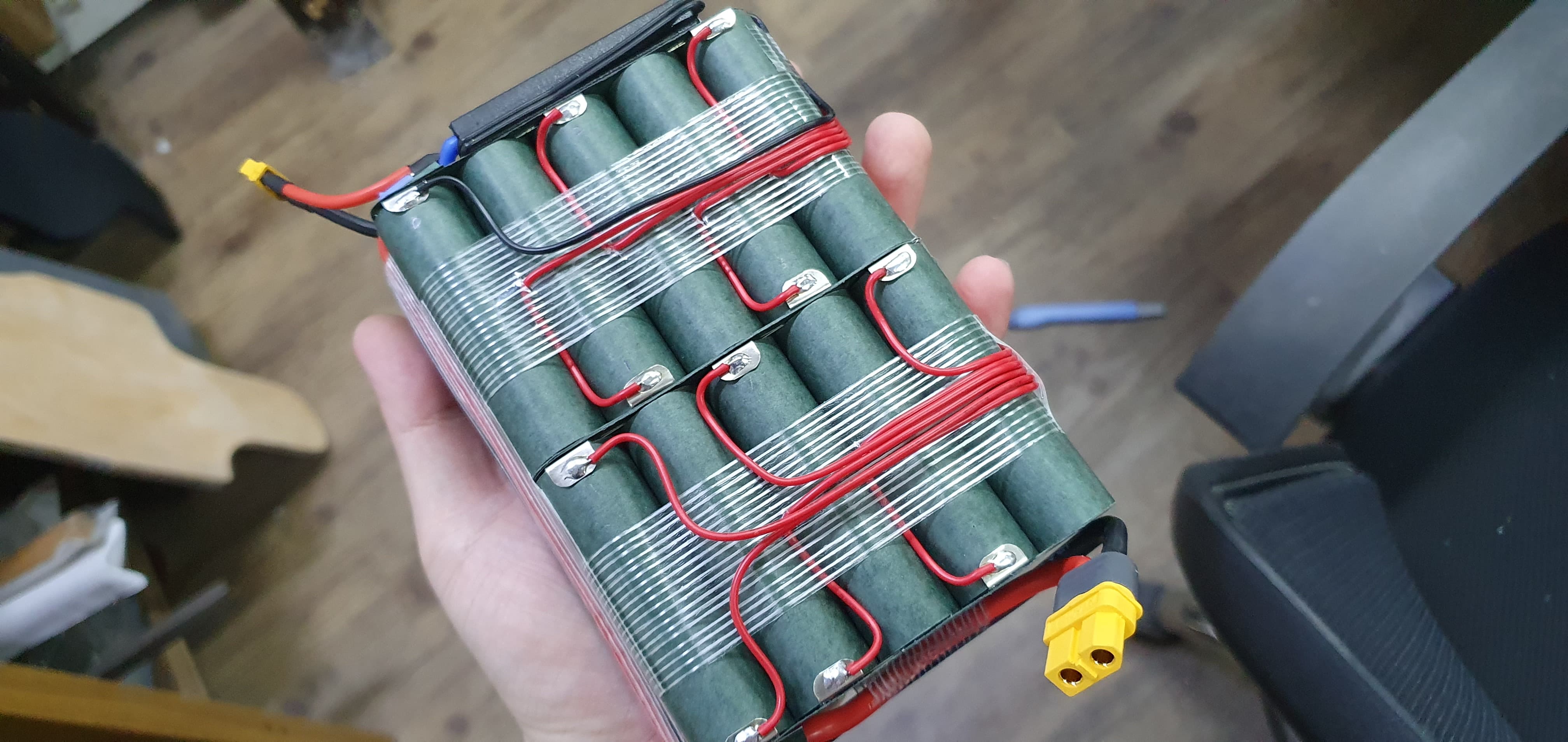

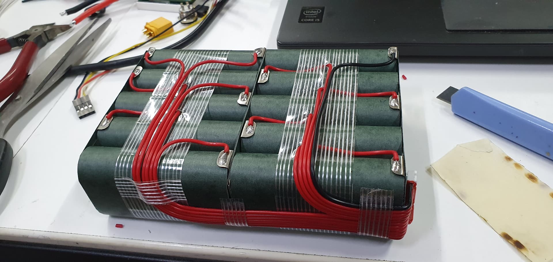

Okay. I’ve finished up the battery pack. I’m gonna install it tonight, and do a small range test with the old motor, then switch to the new one. Just to see if there’s an efficiency difference from switching motors
I liked building this pack, also let’s me play around with the BMS wiring

Really pretty battery!

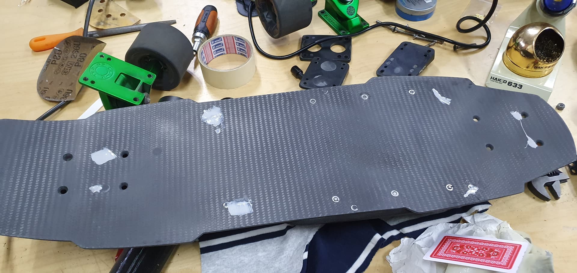

Putting it together. Woo, the new motor should make it a little more silent at lower speeds. The old one has been well abused for 3 years and has a low speed hum.
Sealing up any holes with JB weld, and sanded smooth once hardened.
And bedliner. I’ll probably put my logo in the middle and something else around the logo, not sure what yet.
Yeah goddamn I’ve shot myself in the foot so badly with that

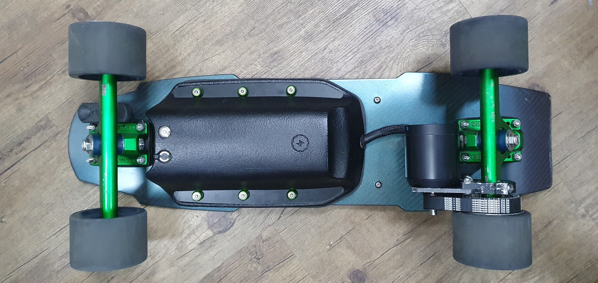

Okay! All done. Looks $500 more valuable now, because that’s the amount I probably spent in terms of parts and effort.
