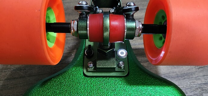

The stooge DH trucks are interesting… it’s quite different from the longer ones for esk8. I haven’t tuned it much but at its current setting, which looked like a high angle for the front truck at least, is not turning as well…
I like a soft, sharp turning set up, this one is not it. It can lean a LOT, because the red bushing is the softest, but yet the turning does not feel like a lot. Here’s a reupload of the angle i set the linkage rods to
Front
Back
But yea, right now the problem is that it is very loose feeling till it feels unstable-ish, and yet when turning, it does not turn as well as I thought it would
Anyone with experience with tuning stooge’s 3 links? How should I adjust the linkages further to make it turn better?
I think youre running into the same thing i did. They just dont turn as much as you think they should, and if you get them to turn at all they feel unstable
Another way is to add wedge risers i guess, but it could be an issue for my set up cus I have my power button and charge port there already
I might have found out the problem with the crappy turning radius.
The heim is flushed with the baseplate now, i will try to increase the overall height of the truck, and that should hopefully increase the turning radius.
You could also try making your own mounting points for the rod ends to increase angle without having to run a taller truck?
That was harder than i thought
Also had to scratch the paint sadly.
I adjusted the height by increasing 3mm. That did nothing much. Then i adjusted the collars to be further apart. So i removed the lock nut and have it closer to the bushing, and then the collar. It seems to have increased the turning radius by quite a bit. That is good.

What’d you end up doing truck wise to get them to turn better? Got any video of how they turn?
I changed the front trucks rods to be further apart, scroll up and take a look. I basically had the bushing, then washer, locknut, and finally the collar.
