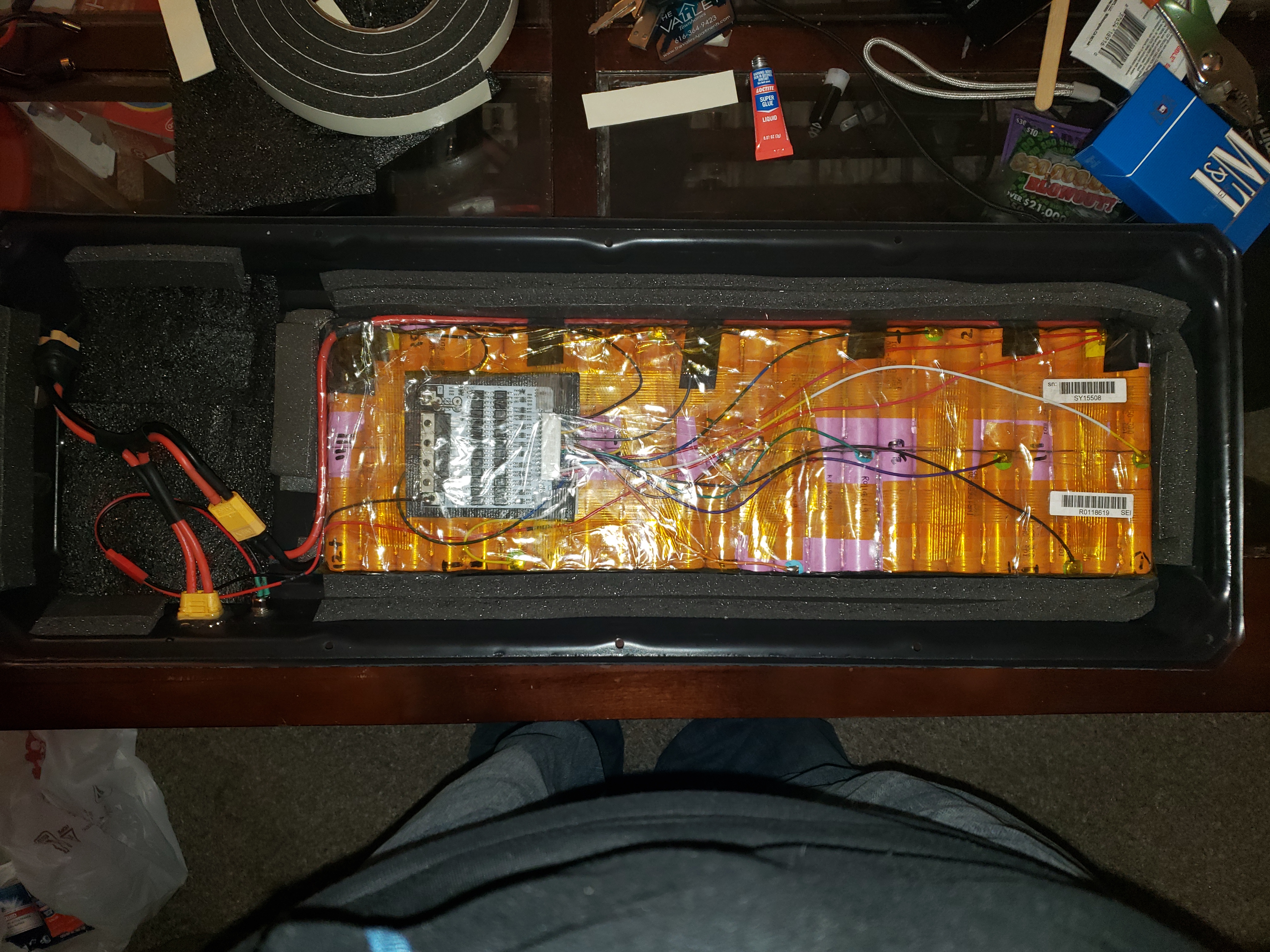

Got a bunch of spare shit laying around, and wanted to get some things ready for my killshot deck anyways, so I slapped this together for now. Obviously will be ditching the garbage ass diyeboard battery when the deck comes. Got a 12s4p 30q waiting for it.
Dickyho At Kit, (wheels, tires, mounts, gears, crossbar) $161 used from @ZachTetra
2x Tb Vesc, Nano remote, and random ass enclosure from @Frankenknolly $120
And then I used the Arbor Axis Deck, and bullshit battery from my spare board.
Actually worked well for my friends to use. Already has a bunch of holes in it, had the deck itself for close to 10 years. Looking at diyeboards prices we will say $200 for the battery, enclosure.

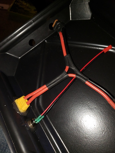

Tore out the diyeboards esc, resoldered the bullet connectors on the TB vescs to 5.5mm bullet, extended the power wires and changed them to xt-60, then picked up a parallel loopkey from @hyperion1 because I’m now out of connectors and that was honestly faster and cheaper, and mostly because im lazy. $22.

Only running 40a battery max because the battery is garbage, and -4 regen.
Through some crude foam padding and a light coat of silione around the loopkey areas in the Vesc enclosure today. Sorry, no pics, was in a hurry to ride.
Then crudely drilled some holes and mounted things half ass for now.
