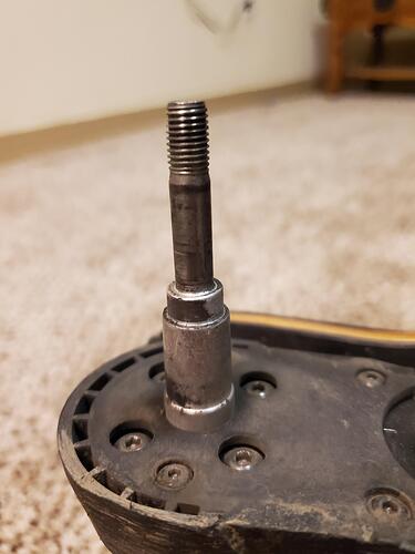

I’m looking for a larger (44-50T) Kegel pulley upgrade for my Exway Flex. I’m currently riding on 120mm Flash airless rubber wheels and the stock 36T pulleys aren’t cutting it.
The Flex truck comes with a step axle and the stock pulleys have 2 different size bearings.

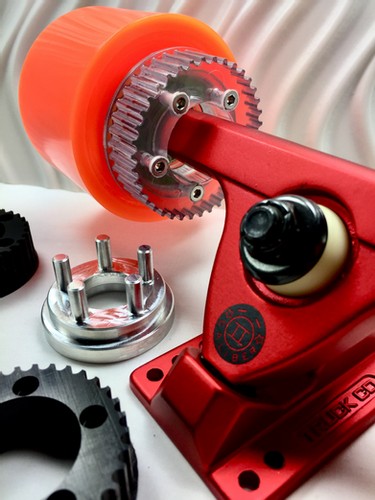

Any idea if https://shop.3dservisas.eu/collections/fatboy-pulleys
or
https://www.janux-esk8.com/product-page/abec-kegel-type-pulleys
will work?
was about to link him that lol
@3DServisas sells high-quality 48T all-aluminum kegel pulleys.
EDIT: {link died, product no longer sold}
Not sure about the Exway Flex though; I don’t have one of those.

These look nice! Will they work with the Flex’ weird stepped axle?? I’m a noob - don’t know nuthin bout this stuff.
Yes because they ship with a 10mm and 8mm bearing depending on whether it’s a stepped axle or not.

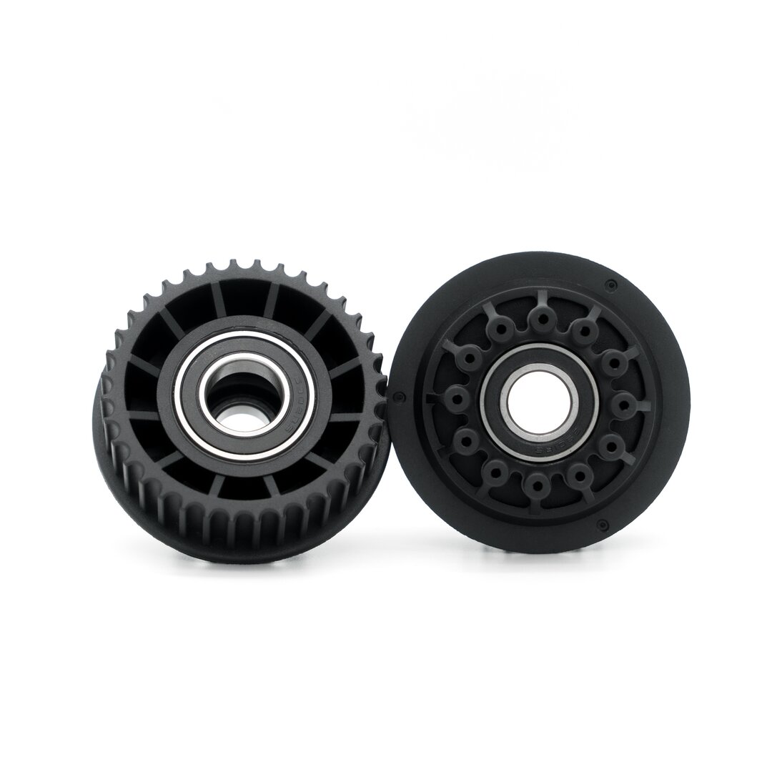

Pics of the Flex stepped axle and stock pulleys
Actually I am not so sure now. From reading off the bearing seal code, it’s a 6901RS which is a 12mm ID. There are no 12mm ID bearings that fit my pulleys ;( That is going to be a bit challenging to find
Aaahhhh. Thank you!
The 3D Servisas pulleys are designed for 608 or 6900 bearings
So they also will not work for a 12mm axle, because there is no bearing size for 12mm ID and 22mm OD
You’d have to use spacers either way or bore out the bearing seat or special order one with a bigger bearing seat.
Crud. Looks like I’m stuck goin slow until Exway makes some. Thanks :slight_smile:
