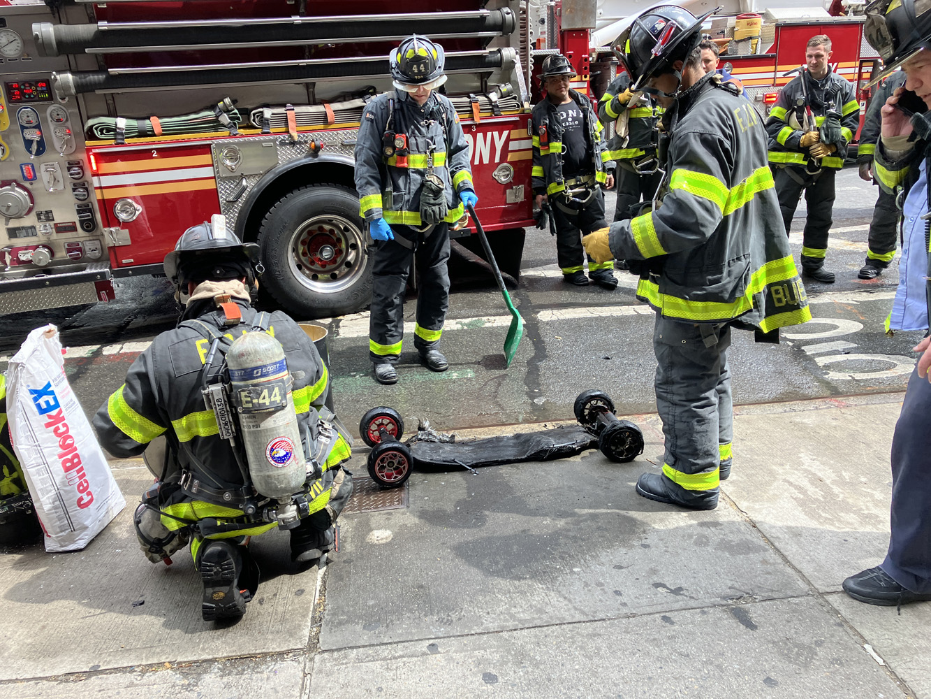

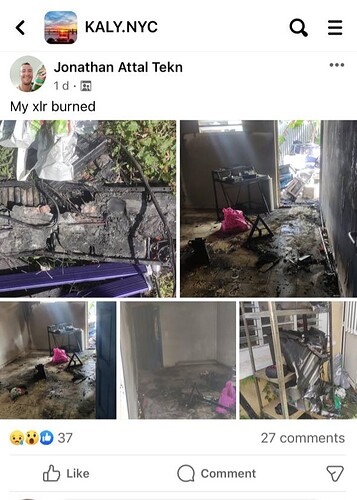

65000 e devices and 220 failures across the board… whilr any is a concern. That’s a pretty low percentage considering just how many battery cowboys there are out there.
This shit though
⚙️ About the ghost drain on battery… 🔋
The 12v buck converter that powers the servo motors draws about 100ma when “off”, and I’ve tested this on multiple XLRs.
The buck is the MAIN reason for the rapid battery drain when just sitting idle.
For comparison, the Spintend dual vescs have an “off” ghost draw of up to 3ma.
The math:
  • the fully charged XLR battery w/ 12v 100ma draw will deplete from 100-0% in less then 50 days.
  • The same battery w/ 2-3ma draw will deplete from 100-0% in somewhere around 800-1100 days
(Ideally both should be fixed, but if all you do is stop the buck drain then you’ll be significantly safer. Although, if you want to store it for a whole year, that’s another story…)
Sawyer post in Kaly.nyc FB group
Another one bites the dust :skull_and_crossbones::skull_and_crossbones::skull_and_crossbones:
