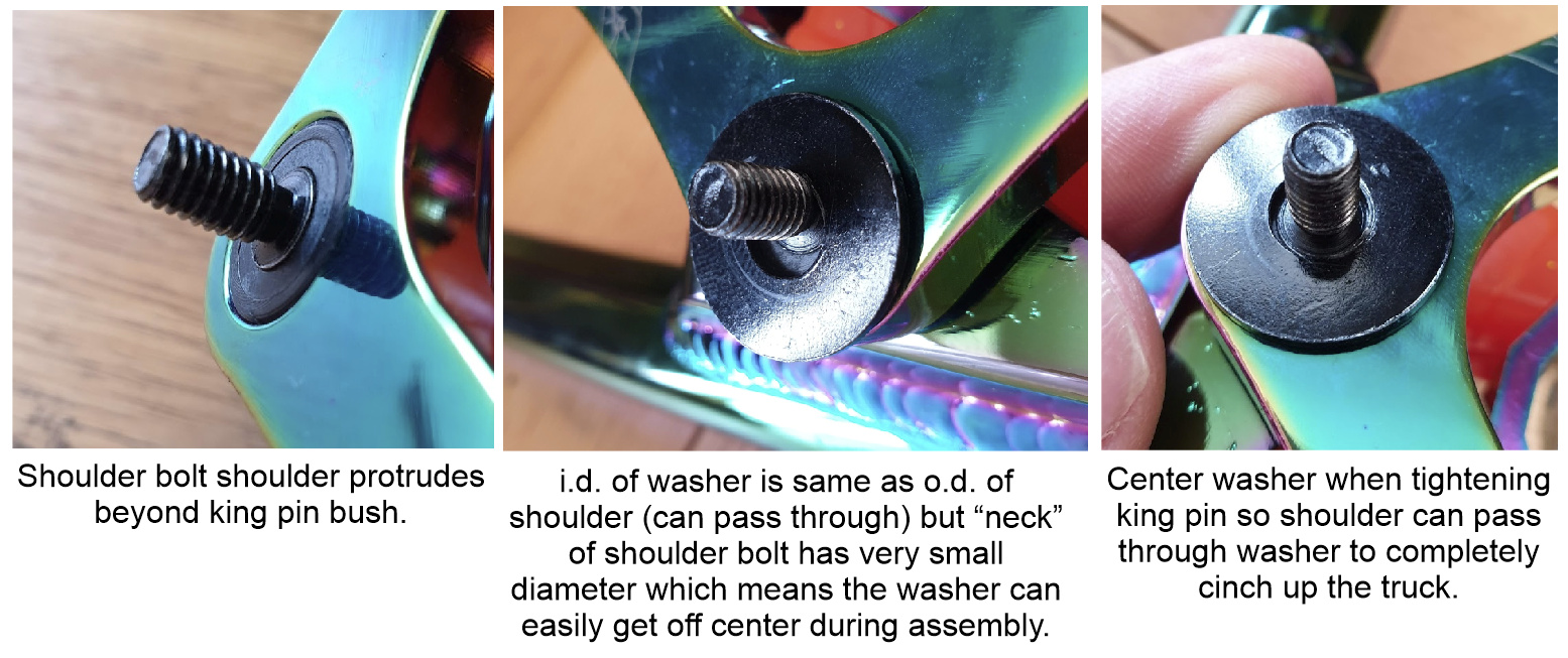

Glad you got that solved.
The “super rattle” shown in the video is definitely wrong (potentially in more ways that one), but it is not problem with tolerances. It’s an assembly problem. If the king pin washer on the nut side is not properly centered the king pin cannot be tightened properly. The following pics perhaps explain it best.
We’ve trained our assembly guys on this but obviously need to follow up again. The good news is it’s easy to fix - just loosen your king pin nut a little, center that washer and hold it in place while you re-tighten king pin. That should cinch it all up (gaps or no gaps). No washers required.
Ultimately, the fact this assembly error can happen at all means the design isn’t perfect. I’m handling this whole area differently in the next iteration of the Matrix truck (still a ways off). In the meantime, centered washers should give you the precision you’re expecting. Try it and let me know what you find.

Thank you very much for this hint Joel. To be honest I was a bit skepitical but tried it right now aaaaaaand it works, I can’t believe it :rofl: :ok_hand::+1::+1::+1:. @Andy87 maybe this also explains your loose washer. I’m gonna order the Pro bushings anyway (when the’re back in stock) as the angle is more straight at the hanger but that’s only because I try to have it perfect but your described method works fine! Also without your help I wouldn’t know about the 3mm flange Pro bushings.
That’s normal because they are mounted to the hanger but it could be that it looks strange because the hanger is upside down in the video. Or do you mean the play? There was also a gap which can be closed by tightening the bolts for the bushings, no problem. Also the size can vary a bit.

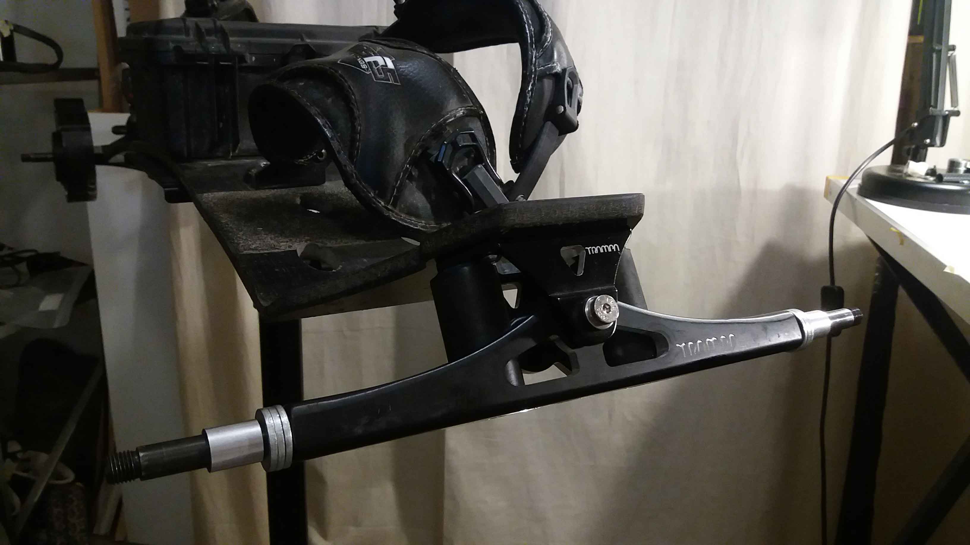

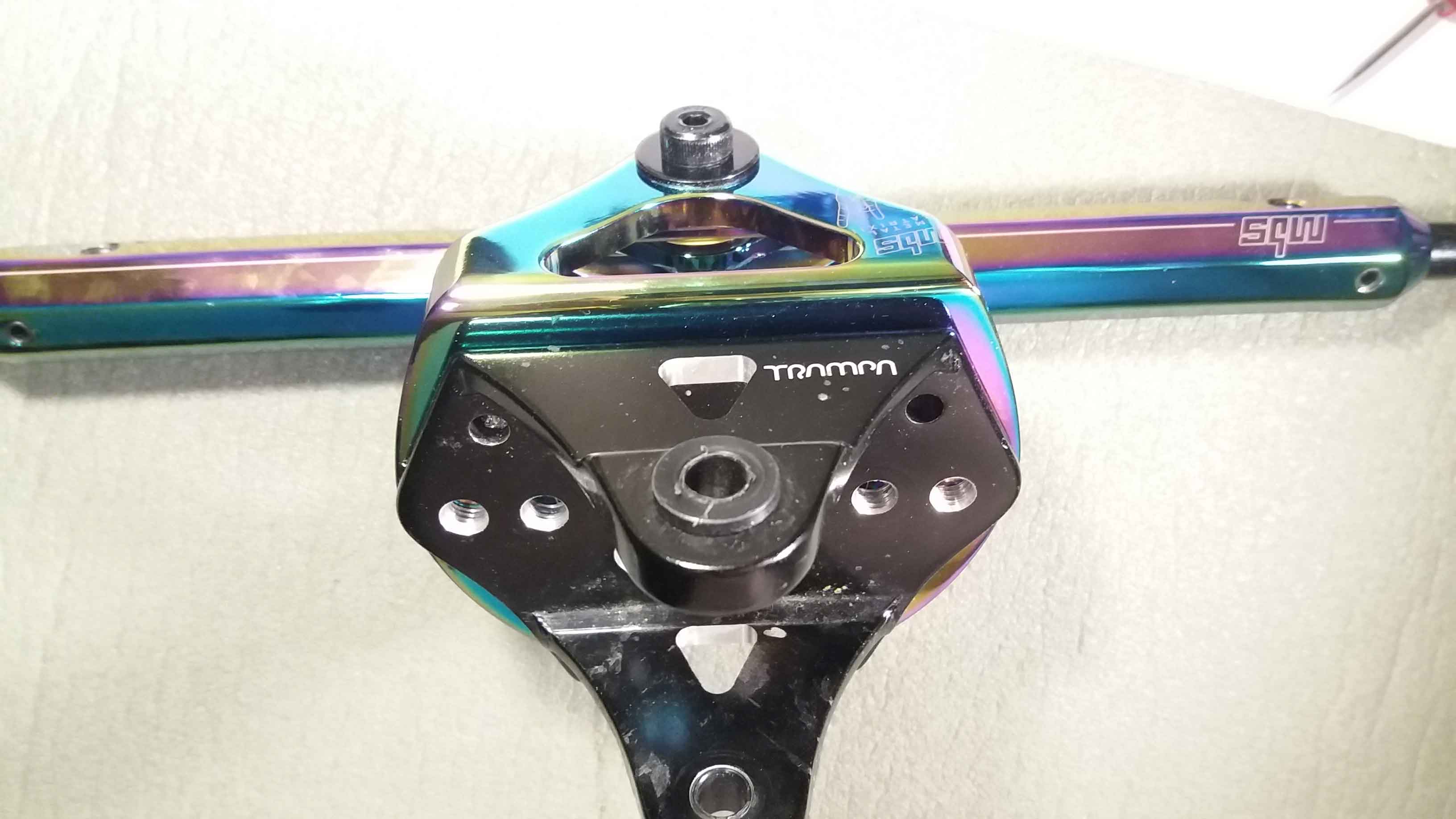

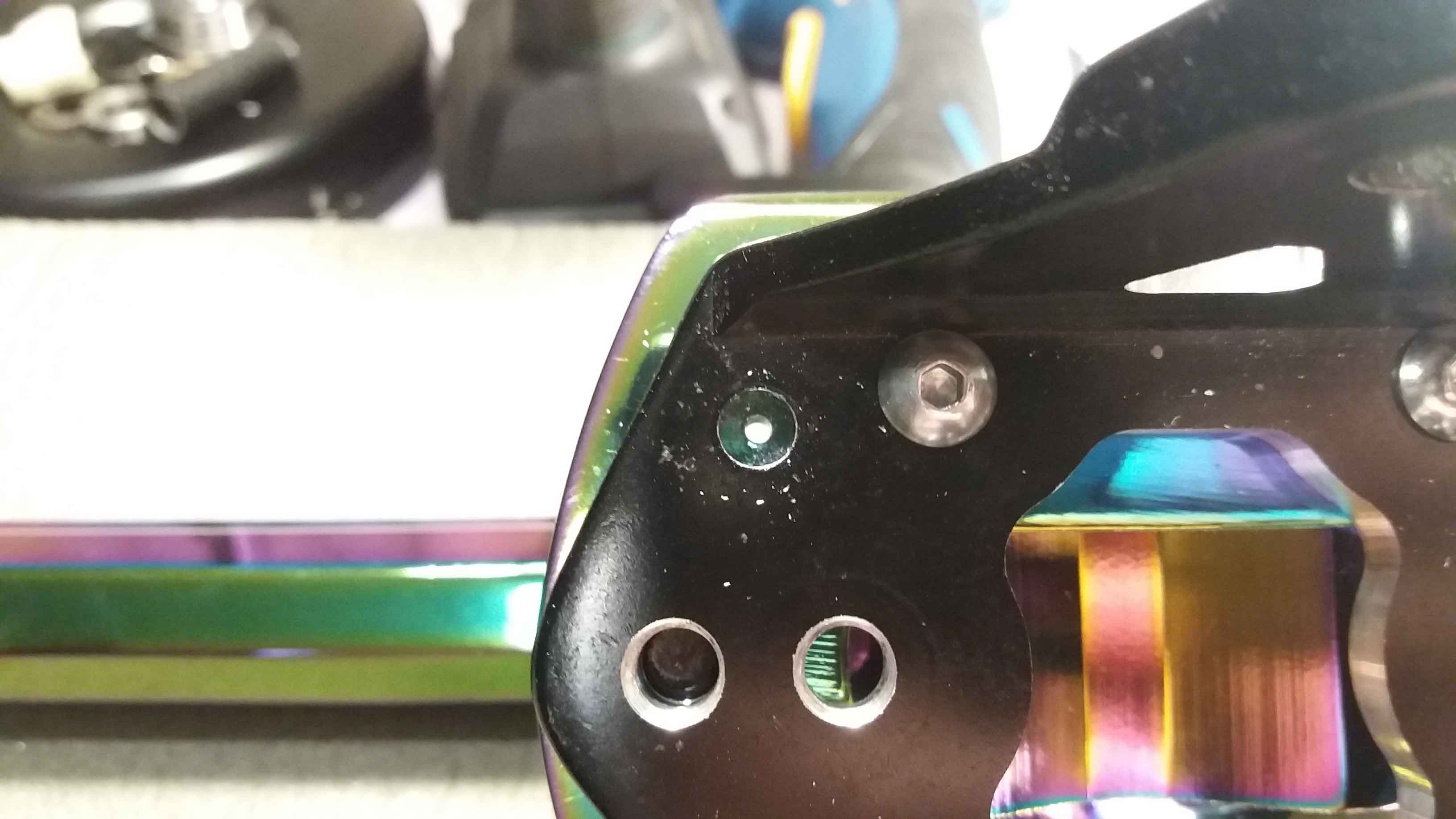

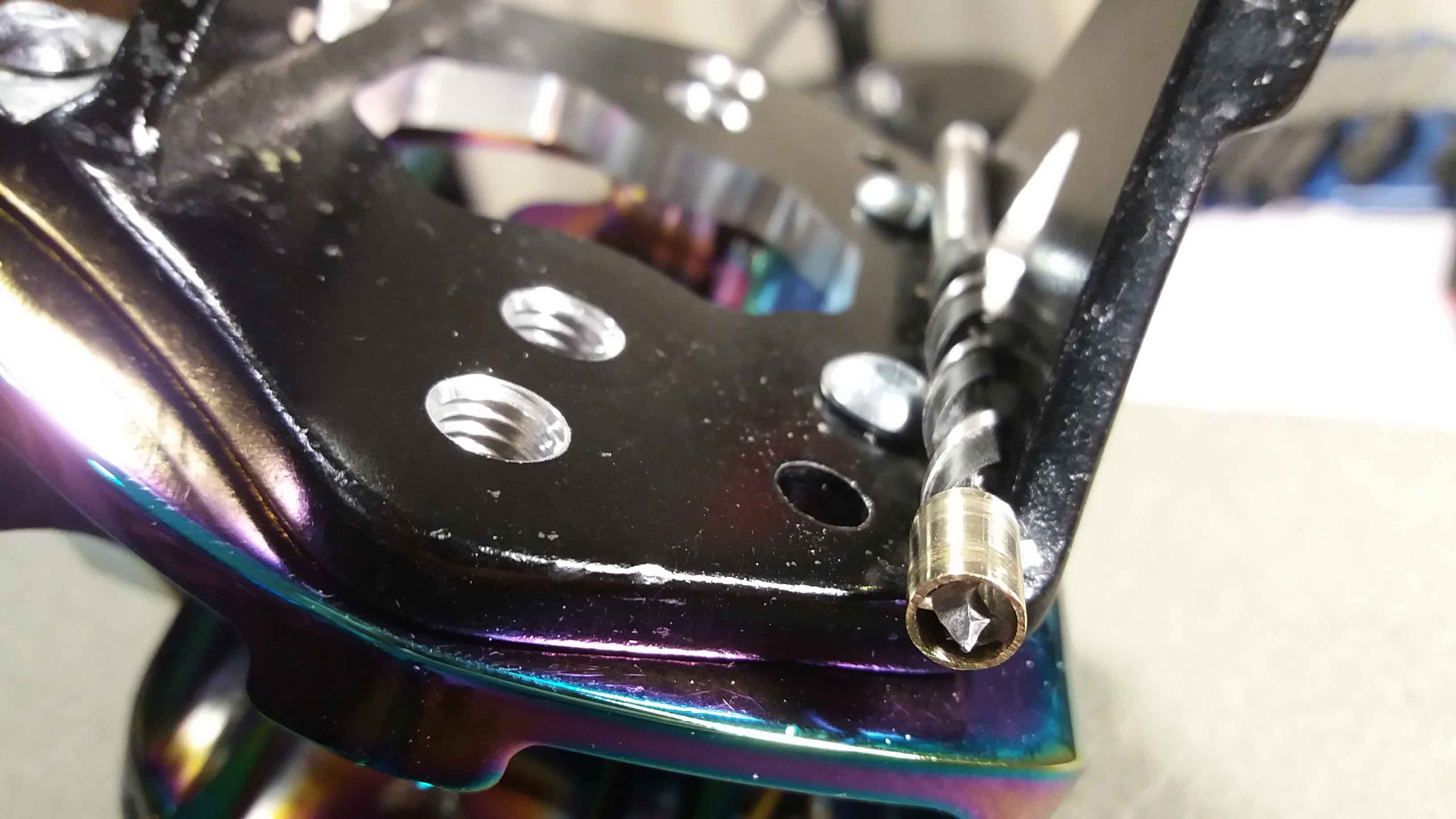

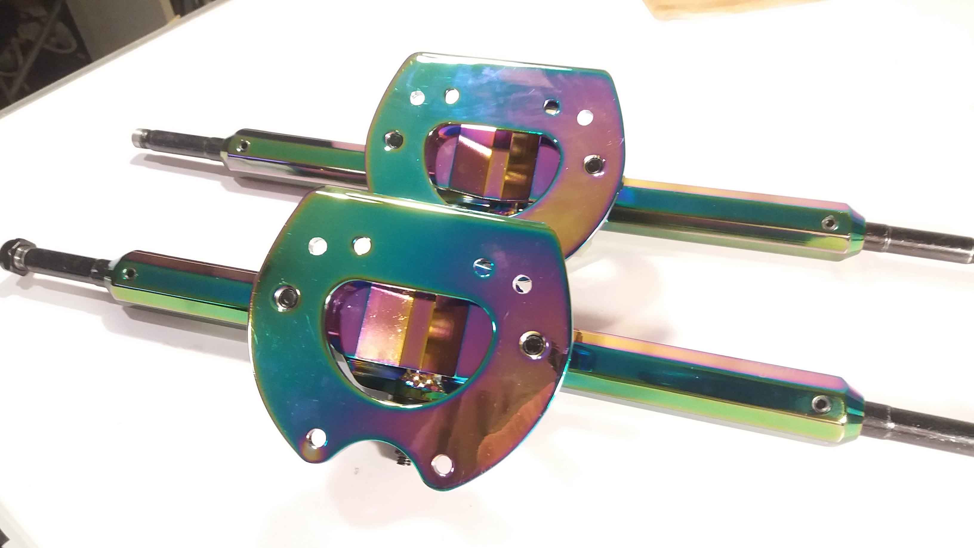

I had to drill holes into the baseplate to be able to mount the trucks on my Trampa deck (previous model). Bolted a Trampa baseplate to the Matrix II.
I used a brass tube (OD=6mm ID=5mm) plus a 5mm wood drill bit and a hammer to make a small center hole first. The aluminium is on the soft side so that worked almost too good.
2mm pre-drilled, then 3,5mm
For the 5mm hole I put the brass tube on the drill bit to center it inside the 6mm hole of the Trampa baseplate. One pre-drilled hole was off center but with this method I forced the final hole to the center.
Then final 5,5mm holes and it was done.

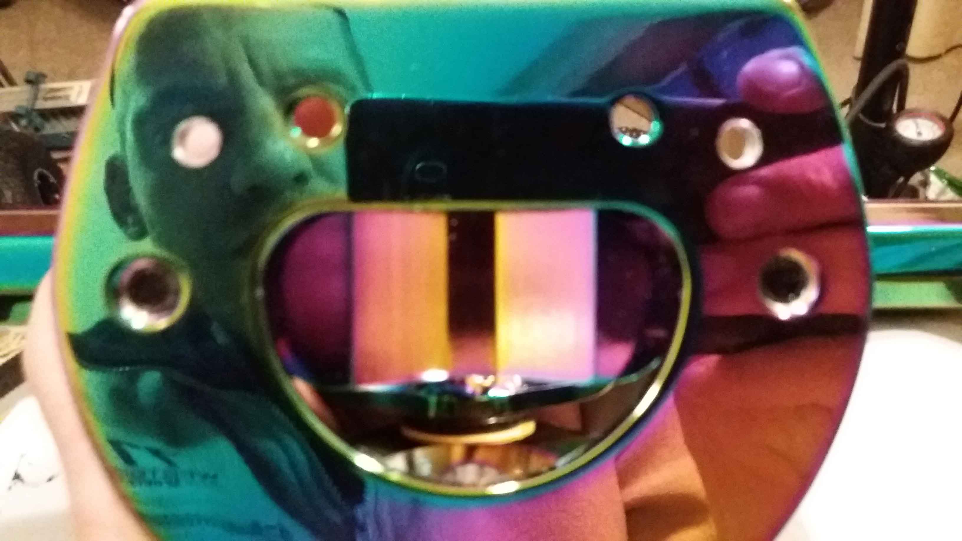

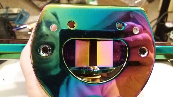

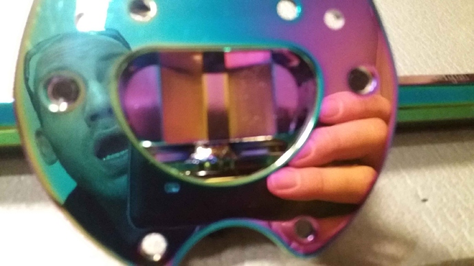

During taking pics I realized how shiny this surface is and how difficult not be visible. Ok here some oil-slick selfies :joy:

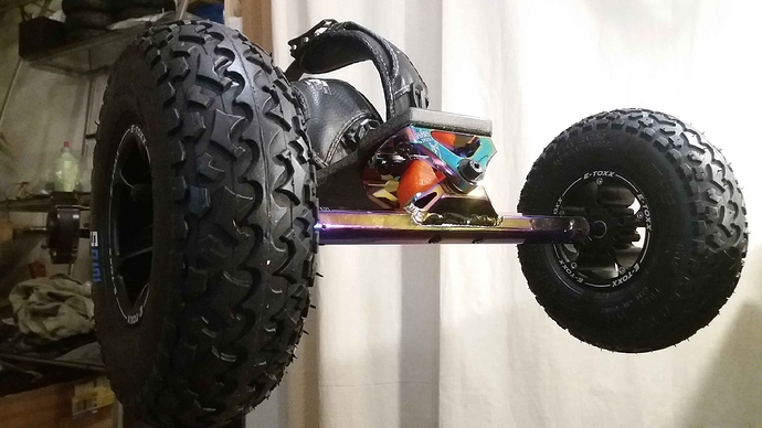

After having this unexpected fun with the trucks it was time to mount.
Before
After

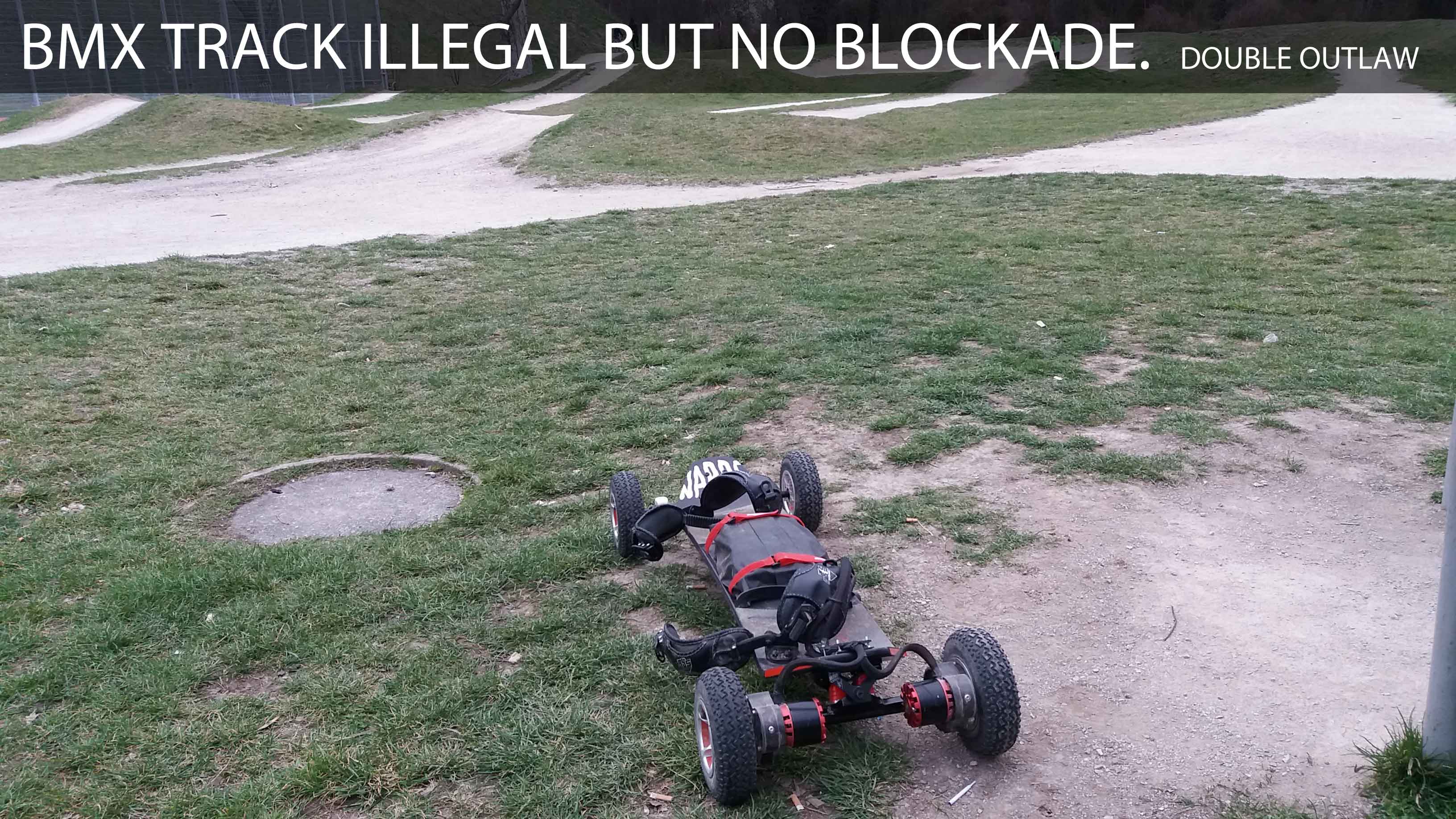

Once I was riding at BMX track when suddenly about 40-50 kids entered with 2 teachers playing football, frisbee and so on on the track. WTF this is no playgound. I was slowly riding the track and told all kids to watch out and hide the track. Maybe I was too friendly because they didn’t listen and the teachers didn’t care. Some of the kids were running in front and back of me, others had fun to block the track and jump away in the last moment. After some rounds I gave up and left the track, the kids won.

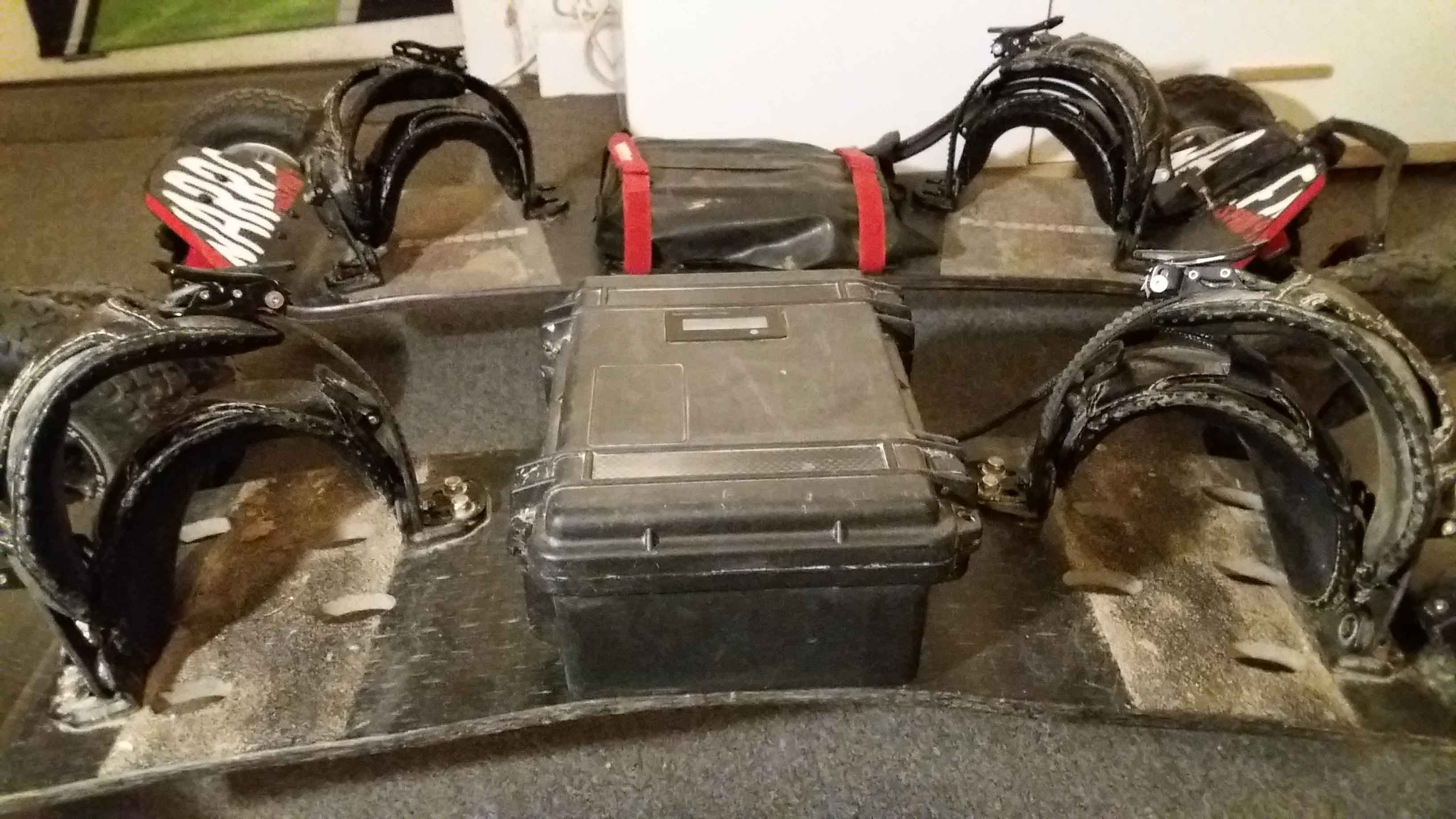

You can position them above the bindings for cruising if you like.
If I would ride without heelstraps I would hurt myself :joy:. With heelstraps there are no limits in riding or terrain but it needs some practice first before you fall in everlasting love :heart:. If I forget please remind me to post hints about riding with heelstraps, need to gather some useful infos first (from ole forum).
It’s funny that the MBS F5 bindings feel very different on these 2 boards because the hole pattern is quite different.
