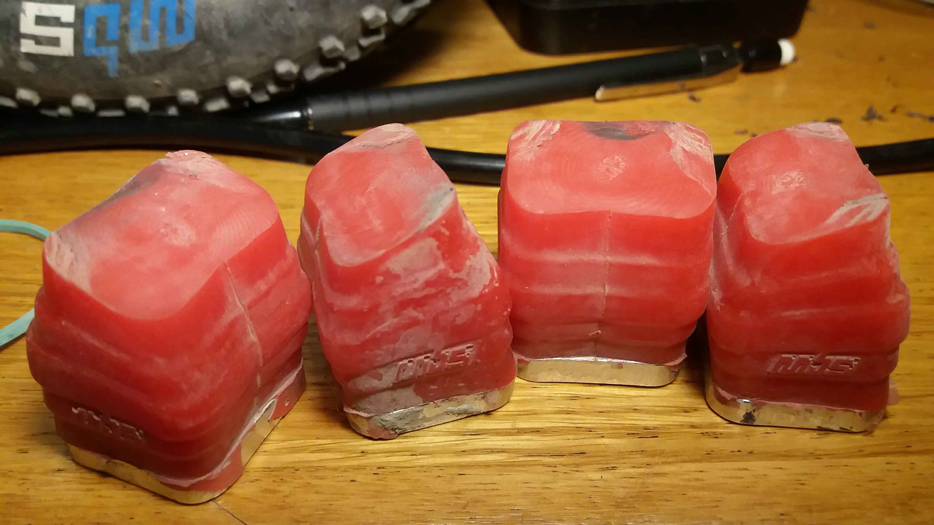

I disassembled and reassembled the trucks several times last week for various reasons. First, now both squeak like hell, the bushings/kinpins have quite a bit of play. Second, all the shockblocks are a bit damaged because they were absolutely not in the right position on the baseplate. they were twisted and crooked, even the screws are bent.
I had to find a solution to keep the new shockblocks in position. I just used 2 big washers which have the same distance as if I had compressed the shockblocks. This works great and feels good when riding. I tightened the bolts so that the shockblocks just don’t lift off the washer and have a stable base.

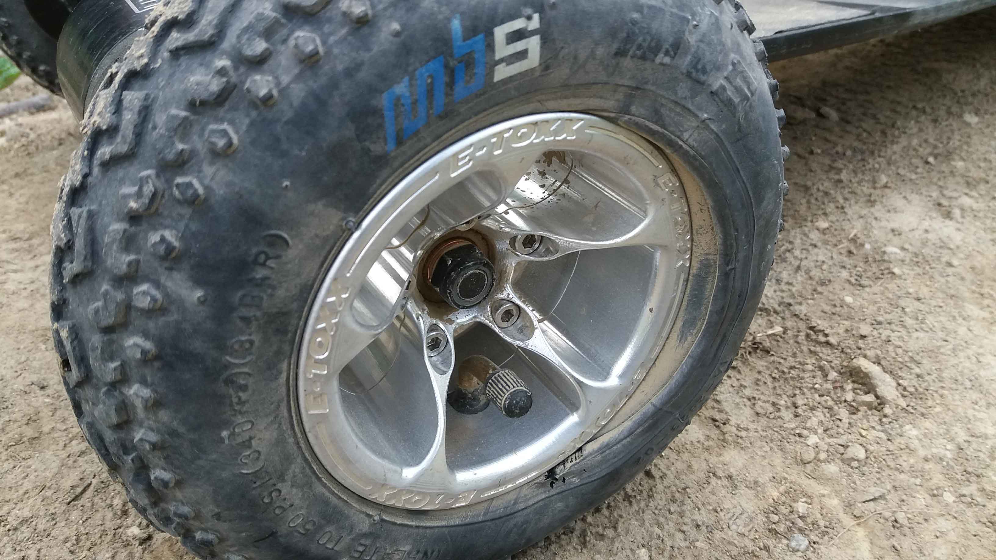

The tire is warped and broken so unfortunately no jumping that day, that has never happened to me before. I wish I had a spare T1 tire…
Whoaaa I wonder if you landed with enough force to break the bead. The tube was still in tact?
I didn’t enjoy the 9" tires for jumping either. Felt way too hard to lift off the ground with them.

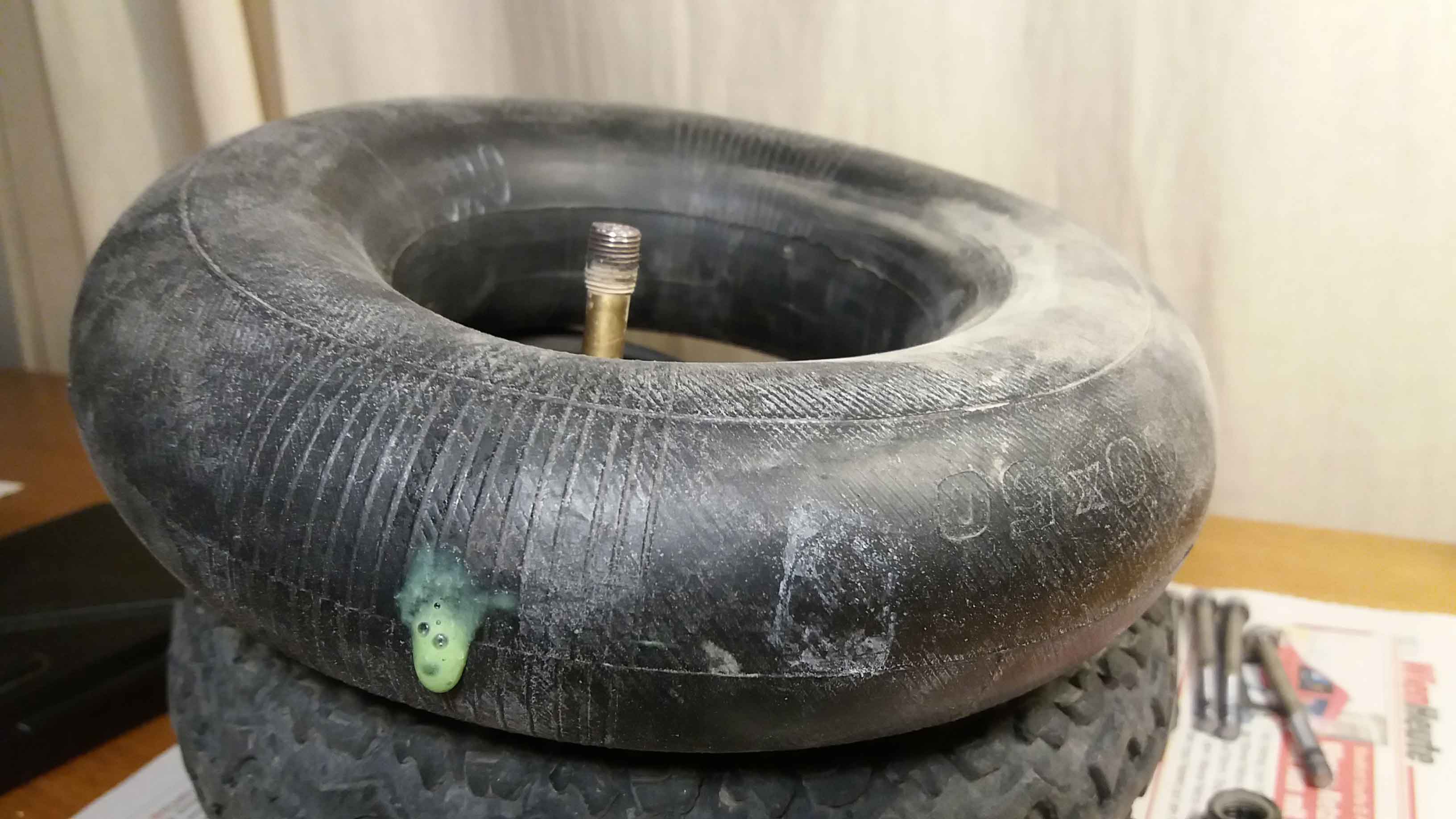

Meanwhile I disassembled the wheel and could inspect the tire further.
Compare the 2 holes :joy:
I have no idea why it’s so stretched because the inner metal ring is not broken
The tube is alright but not on a different spot

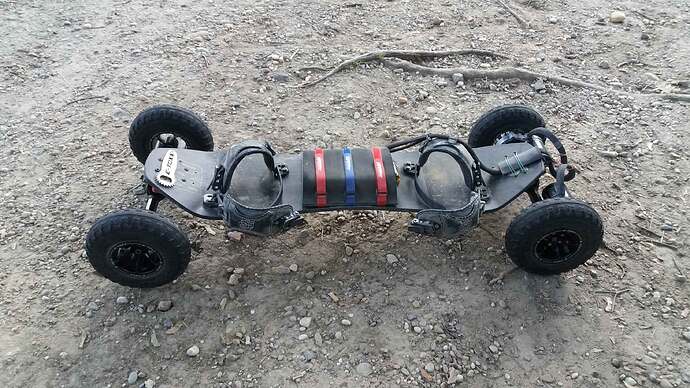

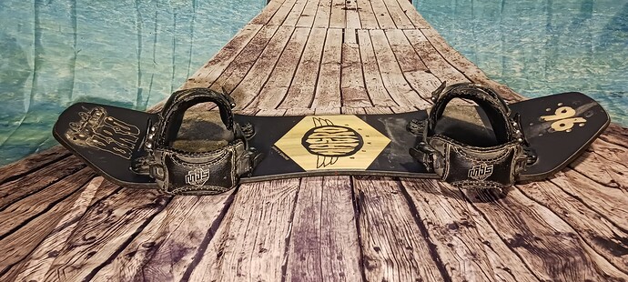

The previous board looked like this
It’s time to change some things

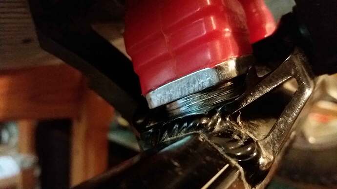

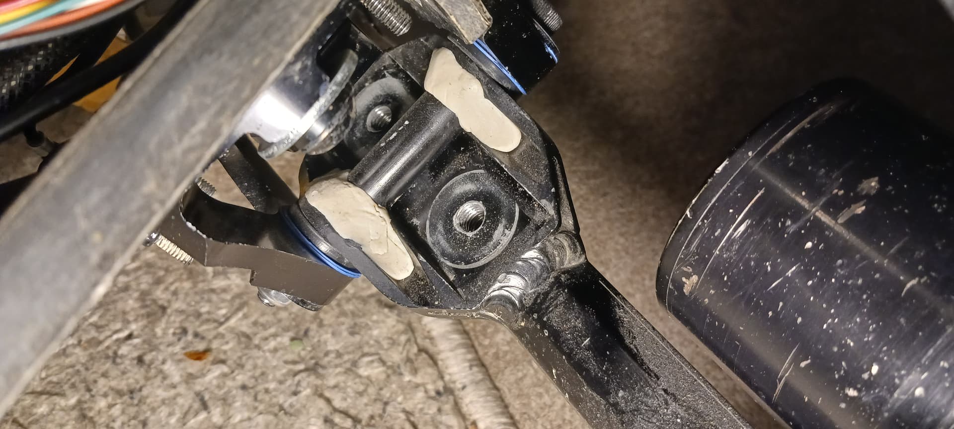

I’m switching from Matrix II to Matrix III trucks because I had some problems with the old ones. The kingpins/hangers became loose several times during each ride, the motor mounts often shifted and the welds on the tubes broke. Here is my last repair with epoxy.
I currently use the Matrix II trucks on my commuter and so far nothing has become loose after 3 rides, but I also don’t ride off-road with the board. I had completely forgotten how great it is to ride an electric board!
I bought the wide Matrix III trucks with additional 70mm axles. The new trucks feel very good and stable, I love all the improvements, well done @MBS !

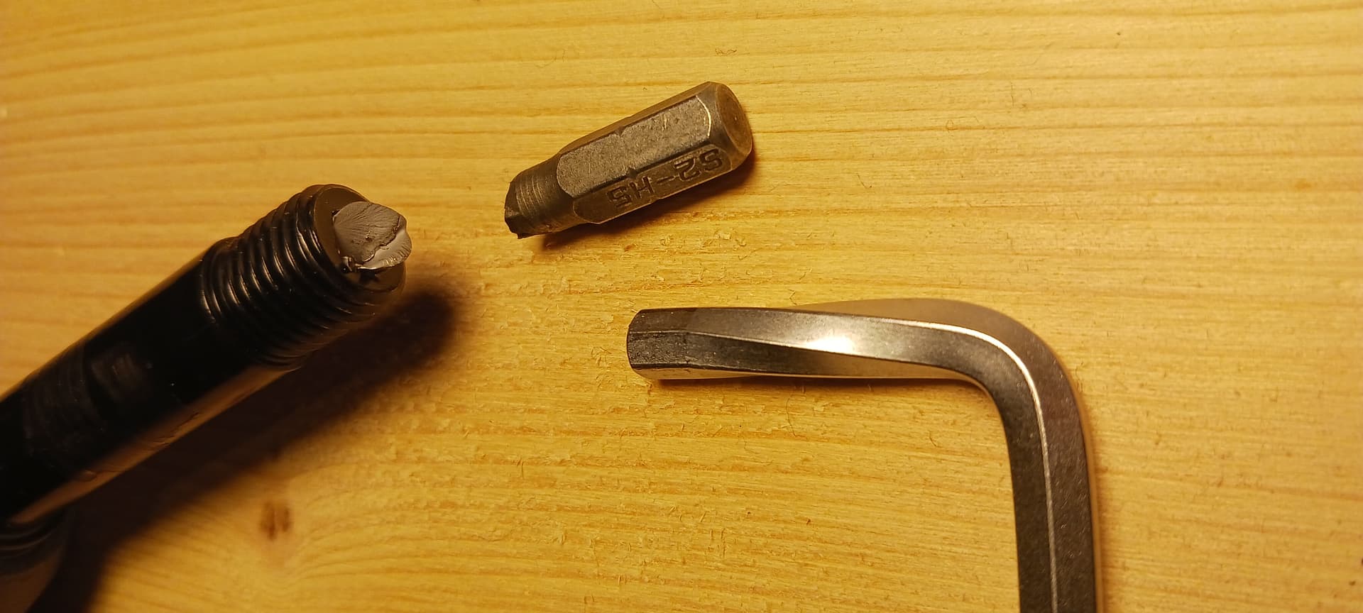

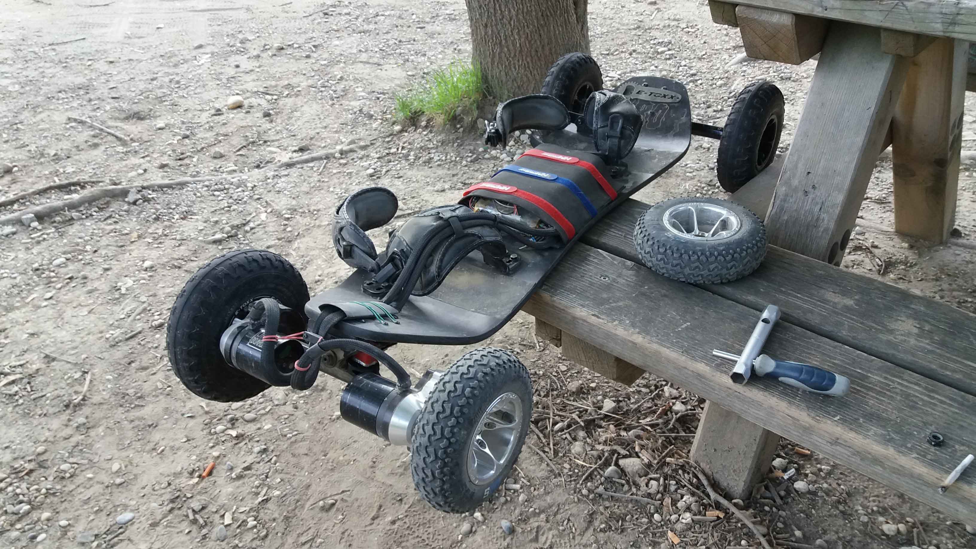

I tried in vain to remove the 50mm axles. Look how the Allen key is twisted when I used a lever of 2 meters (78inch). The bit is also broken.
Time for more action, after 1 minute with the blow torch they were easy to remove

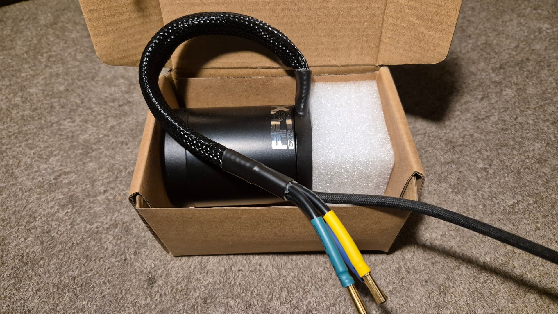

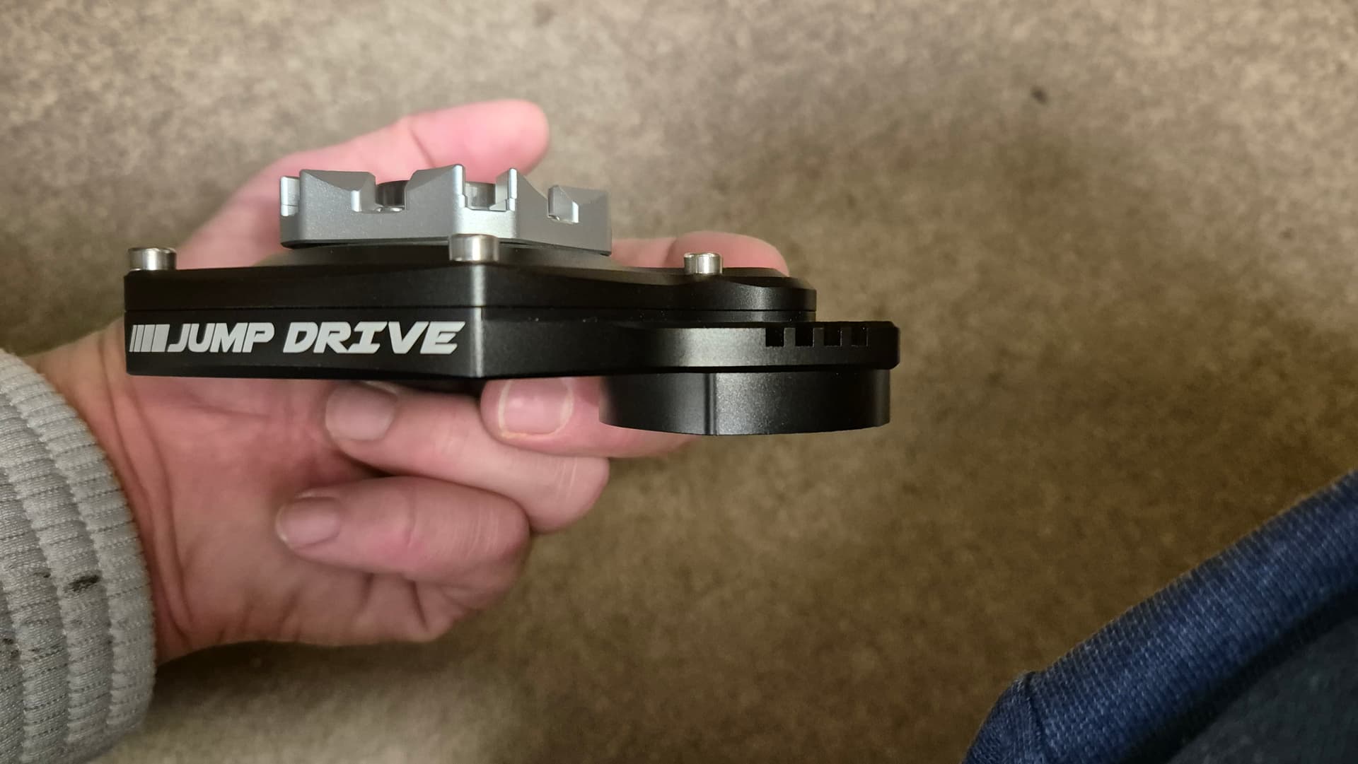

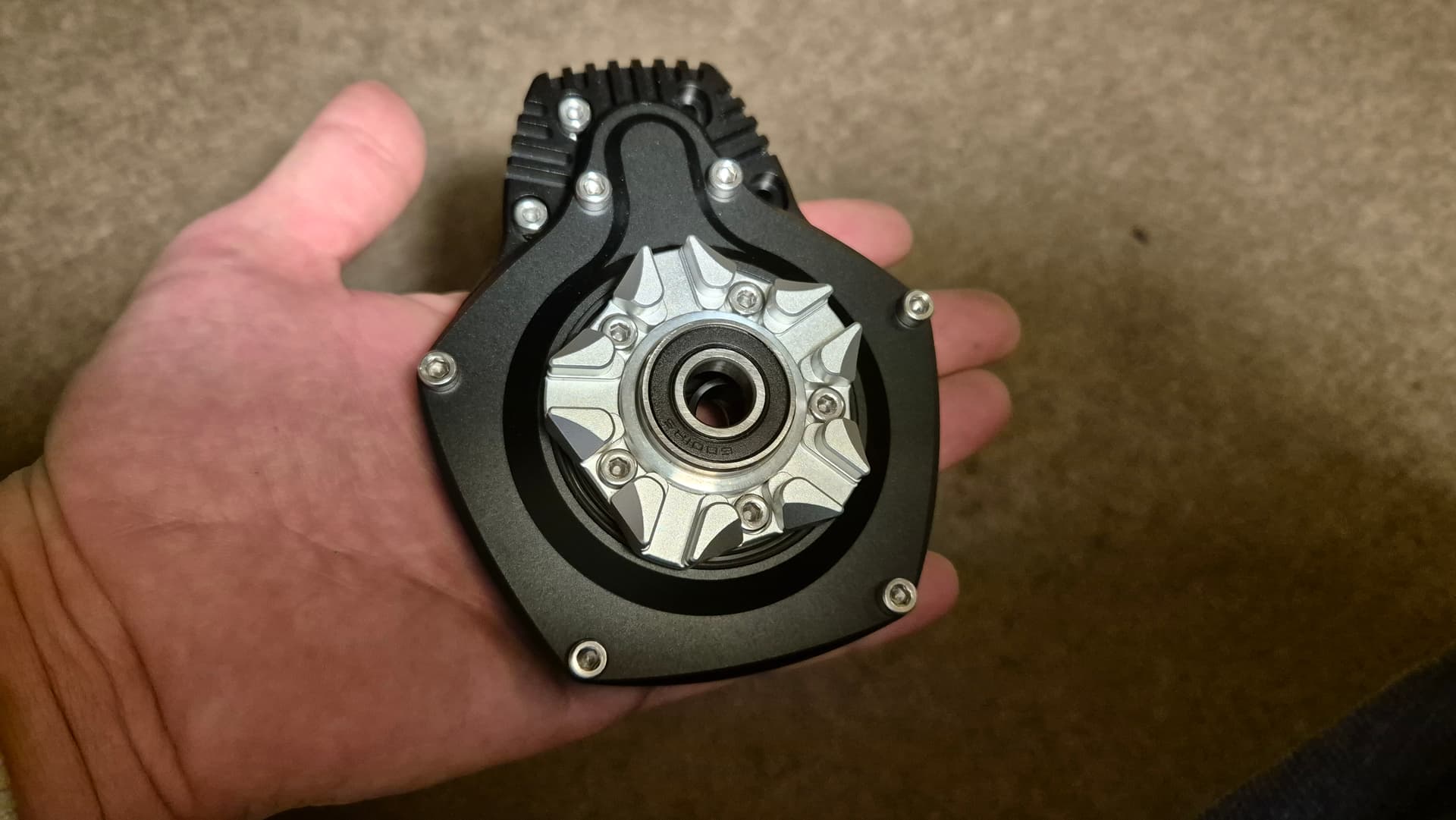

When I looked up the trucks on the internet, I landed on the @ApexBoards webpage and saw the package offer together with the jump drive. I read through the manual and was pretty impressed, so I couldn’t resist and had to buy it!
The drive is so small and seems great, can’t wait to use it, going with 5.5:1 ratio.
My next first world problem was that I had to have the combination with Apex motors, the assembly without gluing is great, so I spent even more money.

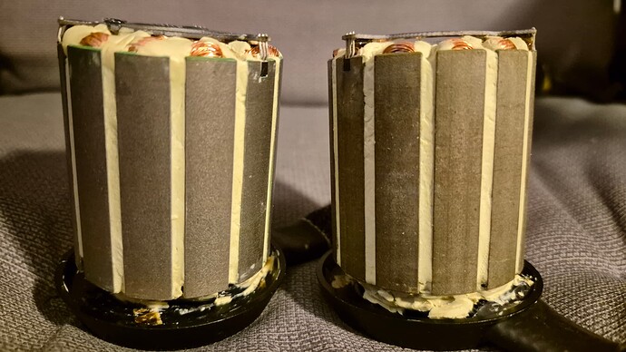

The 2 motors feel different when spinning (cogging torque), hope this is no problem.

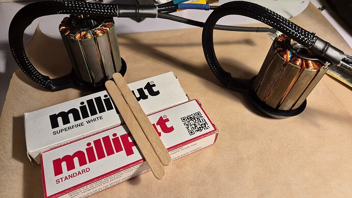

During motor detection one motor made some “string” noises so I opened it and found several loose windings but nothing broken. So it was time for some epoxy.
The battle hardened rotors by the factory look good.

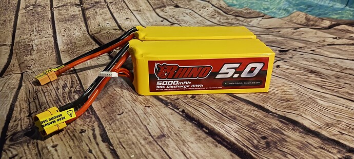

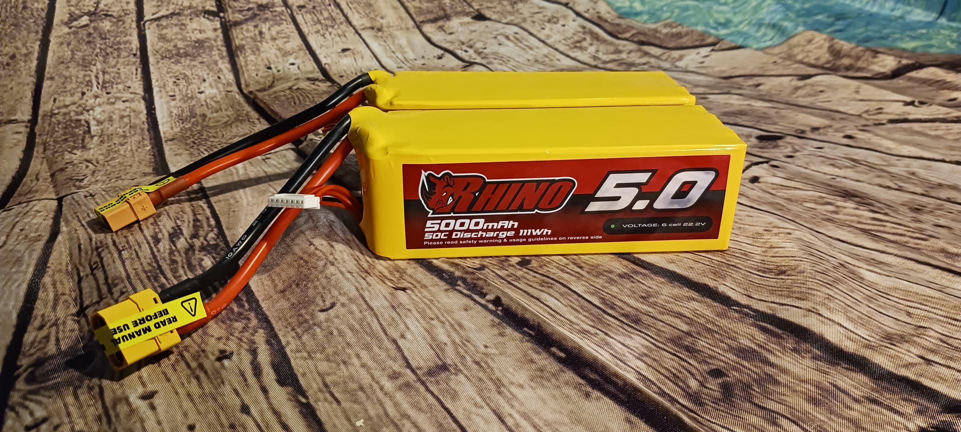

For the beginning I have 4x6s lipos for 2x12s light battery packs for jumping. I plan to use a system for easy swapping. I have a few ideas, but I have to implement them first

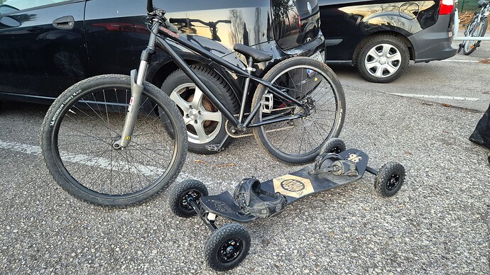

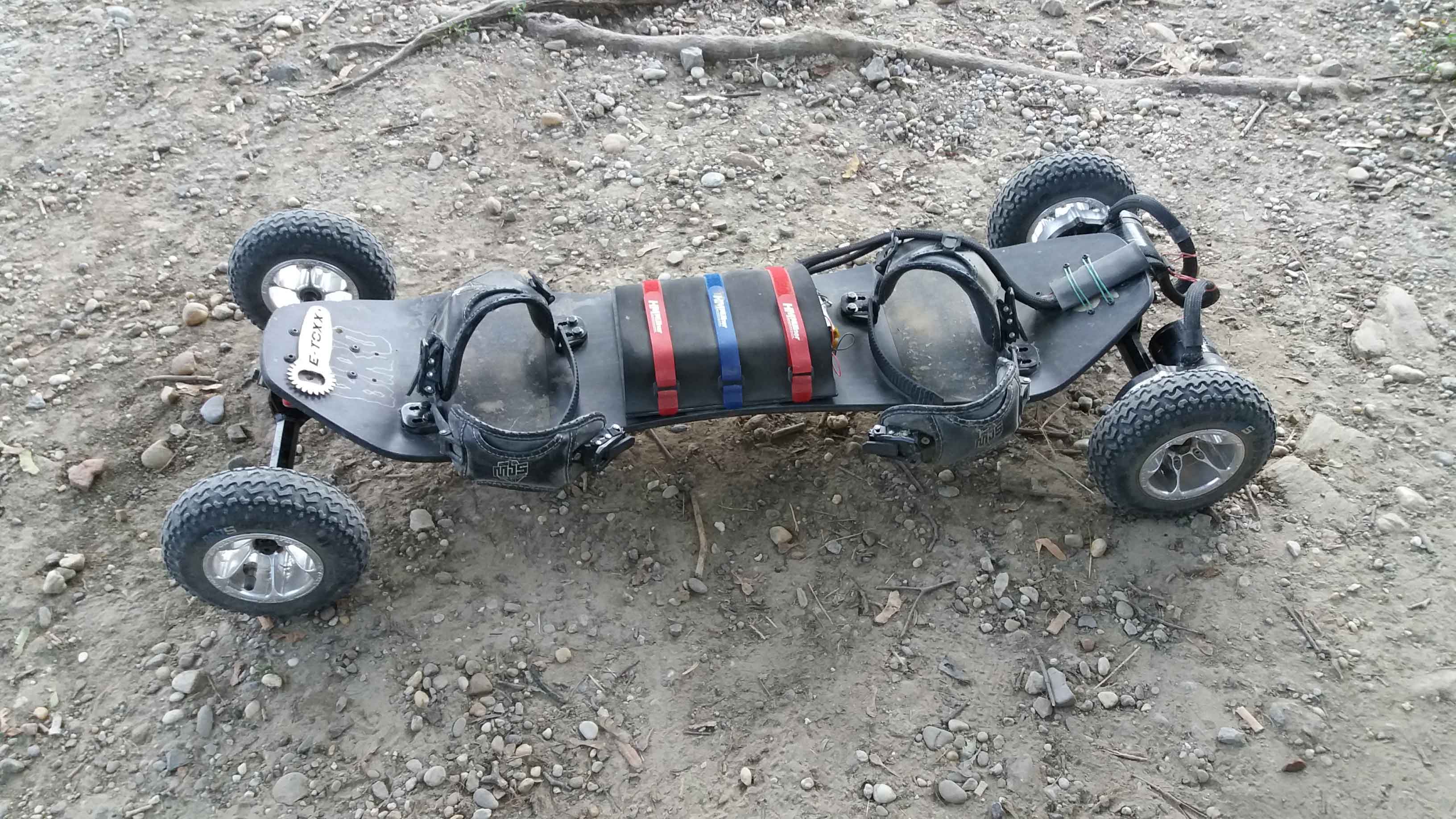

I wanted to know how the board rides with the new trucks, so I went on a trip

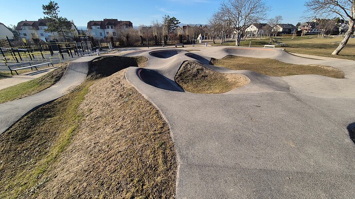

I went to a pump track with the bike and with the non-electric board
There is a concreted jump line with 2 tables, falling is prohibited here :stuck_out_tongue_winking_eye:
I first had the white bushings on the inside, which was fun but way too soft. It was better on the outside, later I’ll switch to red bushings
There was also a nice pool but it hurt quite a bit when I crashed there :joy:
I felt pretty helpless without motors and was way too dangerous for me. I can’t wait to go electric again!

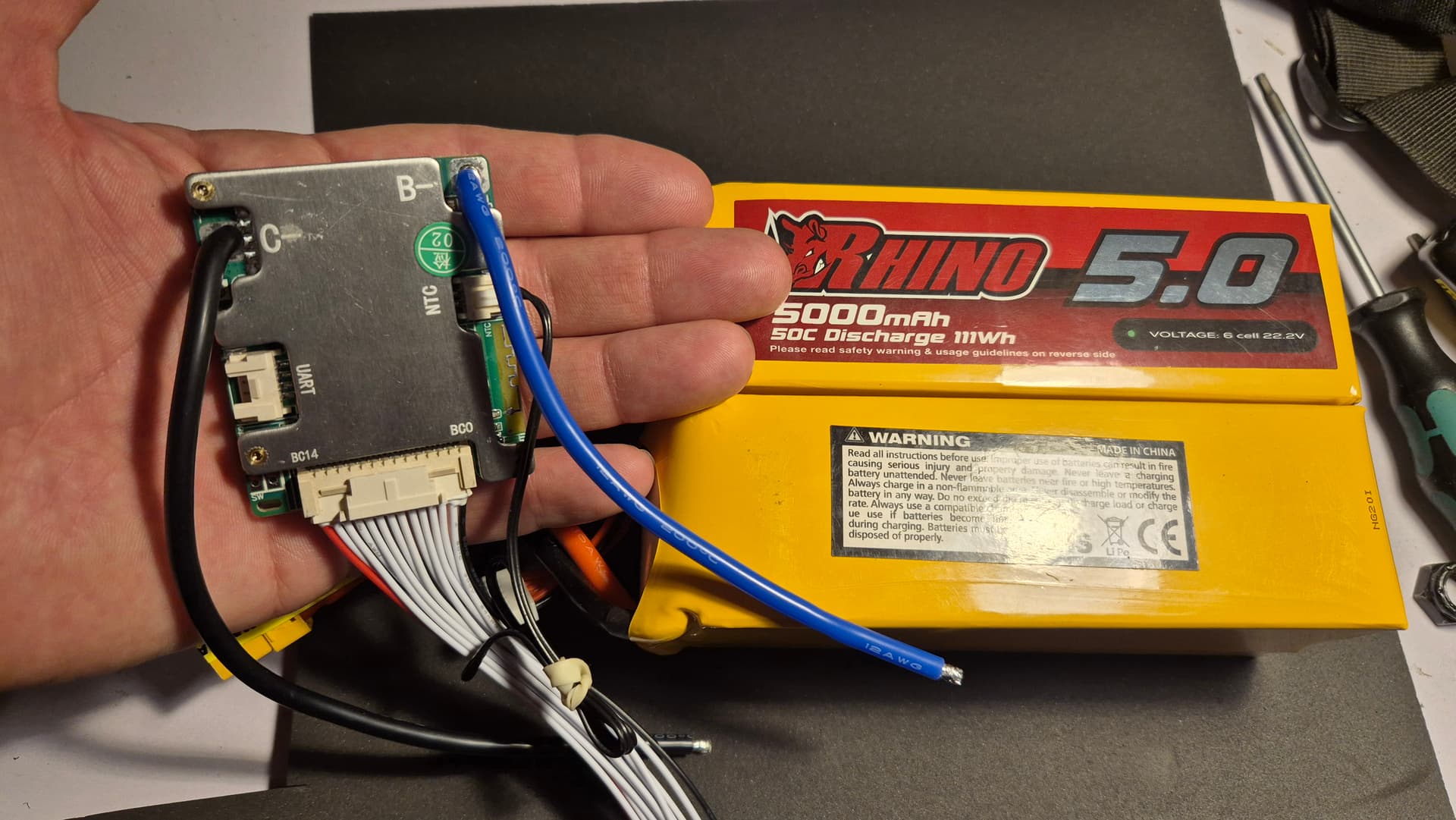

I received some 20A charge only smart BMS for the battery packs
I also received 2 ABS boxes for the batteries but unfortunately they are too small so I have to send them back and find others.
